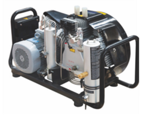

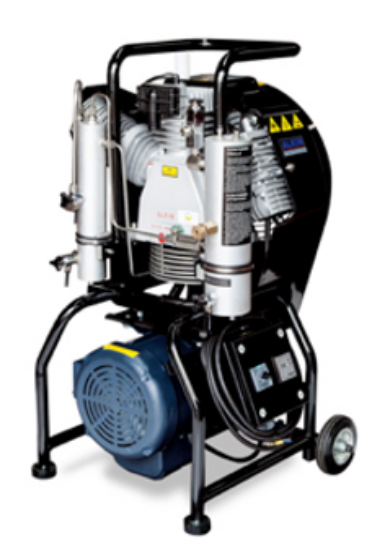

In the two photos below, notice that the orientation of the compressor portion is the same in both vertical and horizontal. They just move the motor from under the compressor to the side to make it a horizontal.

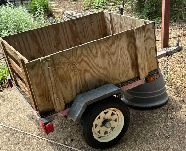

You could keep an eye out on craigslist for a very small trailer that can be towed by virtually any vehicle out there, and build a box to protect the compressor from junk blowing in the wind. You could probably do it for under 500 dollars including having a light duty tow hitch added to a vehicle if you don't already have a vehicle with a tow hitch. There are also plenty of 4ft tall interior small cargo trailers out there, you would have to get lucky to find a used one locally that is cheap, new they are kind of expensive. When is say small, I mean really small, like this, anything can tow it:
If you are handy at all, you could modify a motorcycle trailer to make the cargo area taller and it would work great behind any vehicle, I've seen motorcycle trailers for sale cheap fairly often.

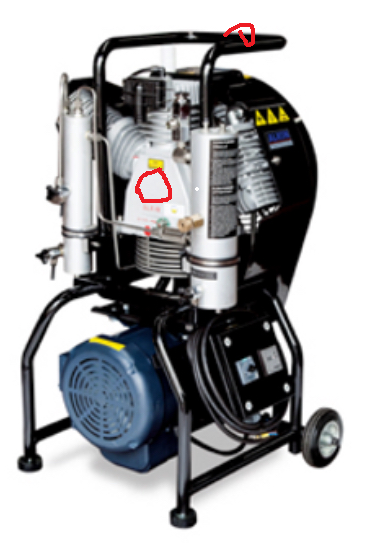

I'm just saying if you are willing to empty the oil and rig up something that will support the weight on the case as shown it red such that the delicate part don't hit anything, or on the other side of the handle shown on red IMO it would be fine. Seems simple enough to rig something up to extend the handle on either side to support the weight. You have to insure that it won't move in transport and come off the support you made.
