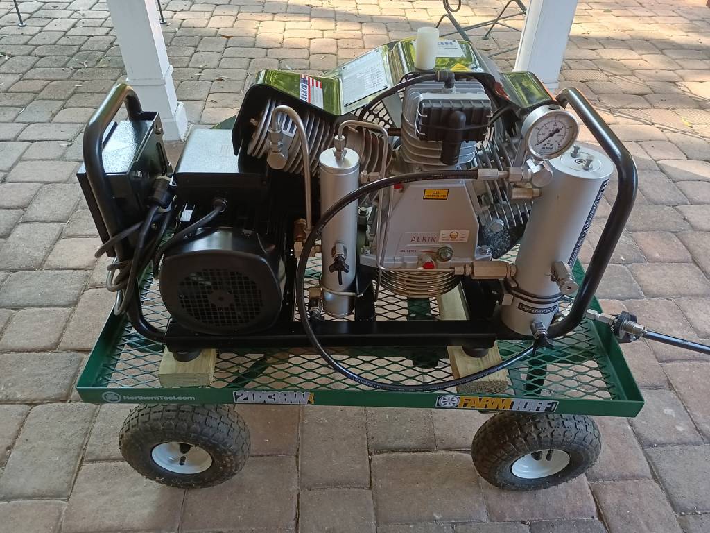

My horizontal Alkin W31 is zip tied to an 8" inflatable tire yard wagon for portability. It is easier to move around than the vertical model with its 3" wheels would be for me. I like the wider footprint for stability. The height of the yard cart also raises my compressor to the same eye level as the vertical model so I can see the controls without bending down. My compressor is kept in paved crawl space area under my house. If I take the compressor outside for servicing it is easier to move over obstacles with the yard wagon. However, I like the vertical model and it seems to be the most popular choice among air gun users. A standalone horizontal W31 @ 145 lbs. takes 2 people or one gorilla to move it.
Hot fills can be a result of 2 factors. The fill speed of the compressor or a flow restrictor in the tank can both cause hot fills. All Alkin W31's have excellent air cooling features built in. They have intercoolers between stages as well as many more feet of coiled air lines between stages. Look at the coiled air lines under the crankcase in the attached photo. The only time my 6.8 liter tank gets warm enough to lose pressure after cooling down is when I fill it from empty, which happens rarely. When I top off from 3K I have my pressure relief valve set to 4800 psi which gives me several extra fills per tank.

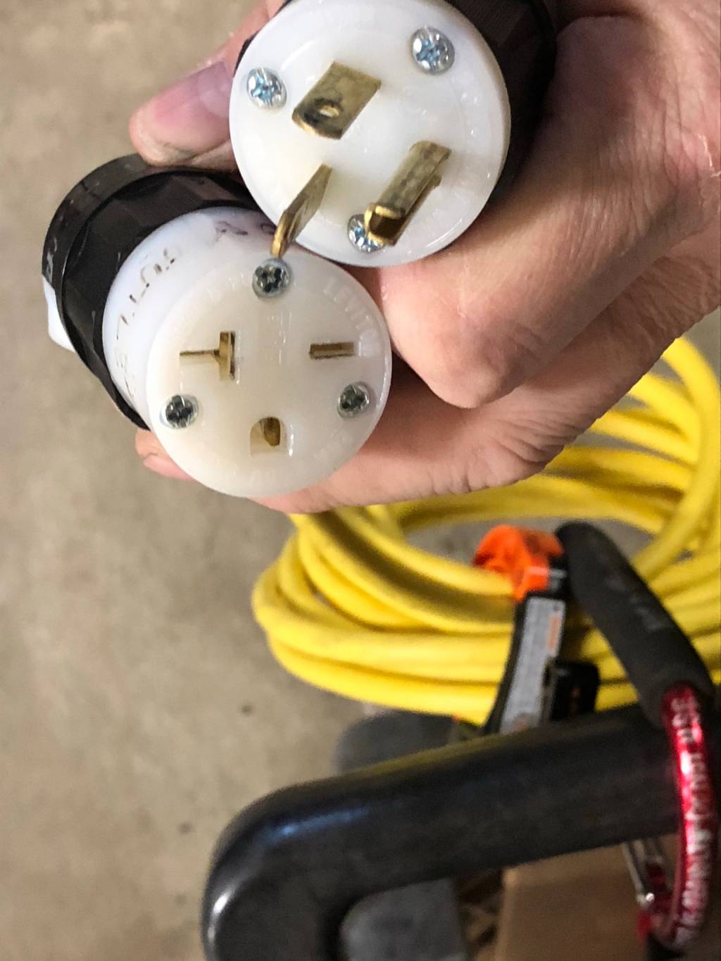

My Alkin did not have a cord cap included. So I chose a Nema L620 male cap and recep. Wired with #12 wire to a 20 amp 2 pole breaker. The Alkin has it’s own over current protection.

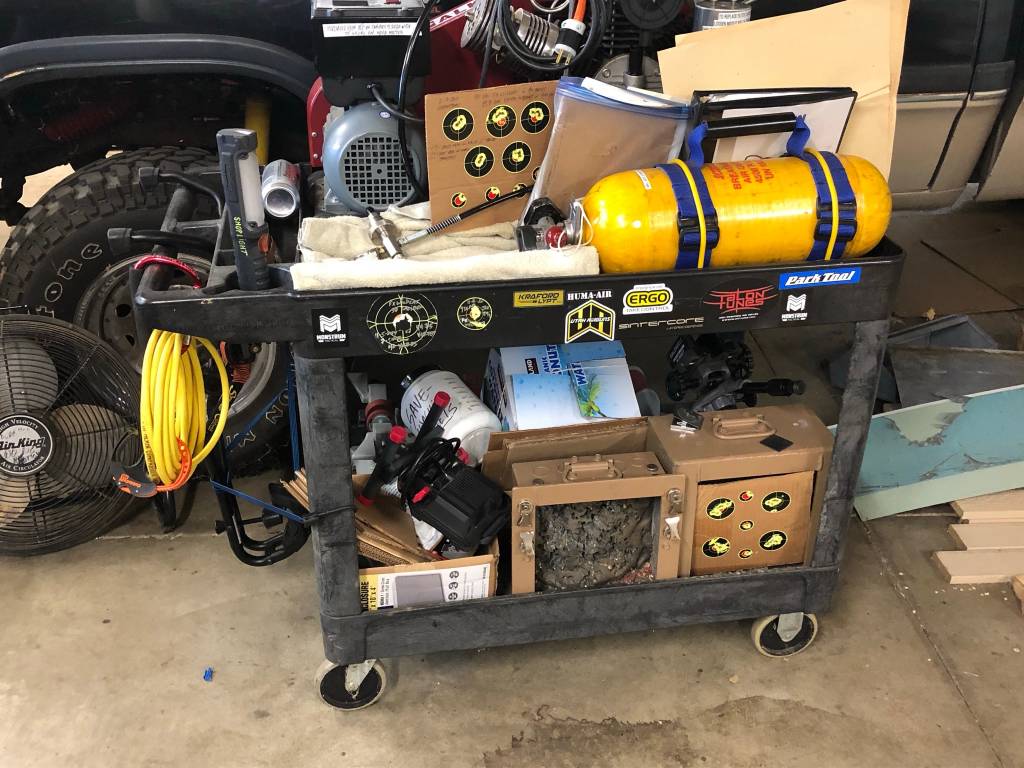

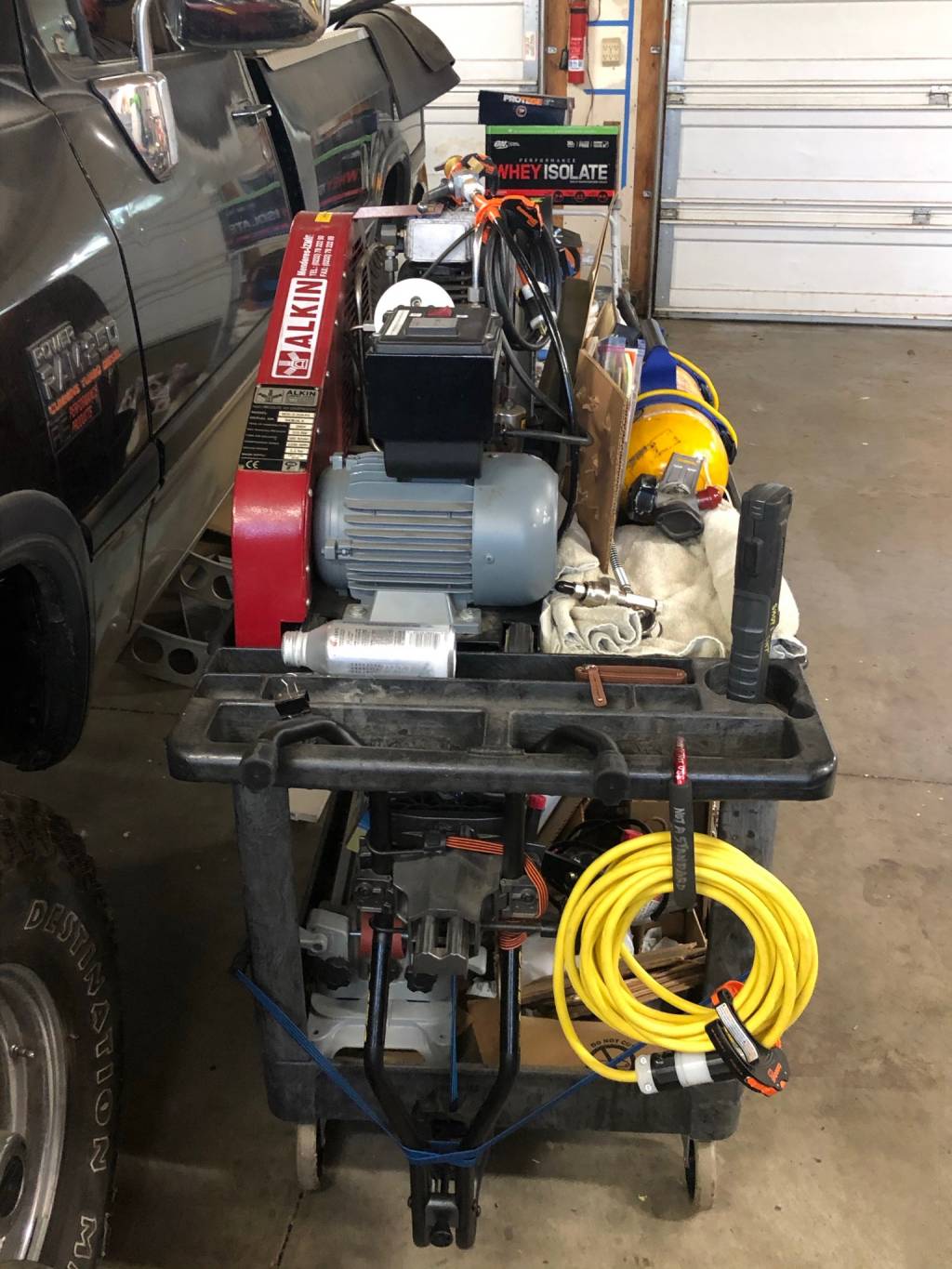

Heres how I have my 2004 horizontal unit set up on a commercial grade cart. Everything is at kitchen counter height, and makes topping off tanks easy. Under the cart I store all things pcp related like my two pellet traps, a Caldwell precision turret rest, a box full of pellet sorting tins, spare lumps of duct seal, cardboard target backers, and the Best Gun Vice.
On the handle end I have the Caldwell Stinger rest strapped on, and a #12, 25’ extension cord with the ends converted for the 220 circuit. Same end style on the Alkin cord.
My garage is 32’ wide with the electrical outlet underneath the sub panel at one end. From sub panel to wall outlet it’s all #10 wire. With this 25’ cord and the cord whip length on the Alkin, I can role this cart all the way to the opposite end and still power up with no voltage drop due to distance(I can go up to like 75’ on #12 cord based on my wiring charts). The vertical model was my first choice as I like the compact footprint it offers and the hand truck style of design for moving it, but this set up does the same for portability. Plus, if I’m not around and my wife needs it moved, it’ll be easier with this set up than if she had to move the vertical, I feel.
Lastly, looking ahead, if I ever have to tear into this thing, no bending down for me, and the cart offers a table for tools and parts. Love this thing, and for being 17 years old and just at 40 hours of use, it still runs like a champ, and tops off my tanks from 3200 to 4500 at exactly 5 minutes.
