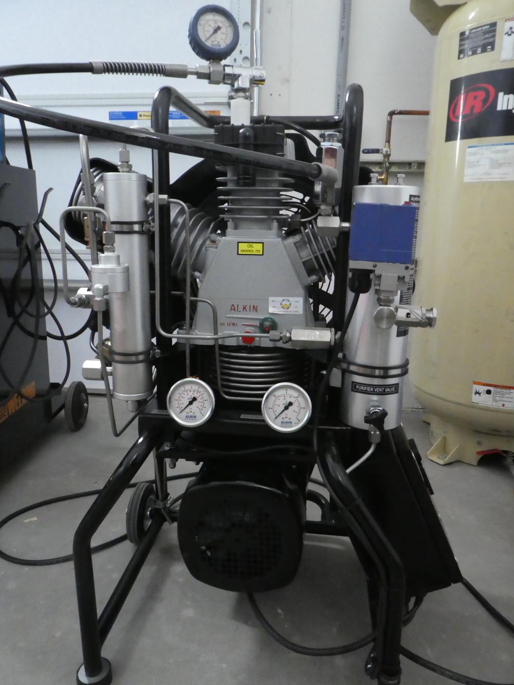

This review covers my experience thus far with a 220V, 4HP, 3.7CFM Alkin W31 vertical with the Auto Start/Stop & Condensate drain features.
Cost was $3100 for the basic compressor + $600 for the automatic start/stop and condensate drain feature + $320 for shipment from NJ to AZ with liftgate service at this end (you can save quite a bit by arranging to pick it up at your nearest freight hub, if possible), for a total of $4020. If you're price shopping make sure your comparisons include similar features and shipping.
My Alkin W31 arrived strapped to a pallet, wrapped in plastic, and covered with a cardboard box. The manual and fill whip were bundled with the compressor. Both a User's Manual and a Parts List were included (along with an Alkin catalog). The manual is excellent. Compressor parts, use, maintenance, and troubleshooting are all well-covered. There are a few (very few) places where the English is a little awkward, and the pictures are a little dark, but still crisp. I had no problems understanding the manual, or following the illustrations. Having the 'real thing' in front of you makes up for any lack of resolution in the photos. Missing from the manual (understandably) is anything particular to airguns, as well as instructions for the electrical hookup. More on that in a minute.
Nearly everything about the compressor appears to be high quality. Fit and finish are excellent and all the fittings appear to be top-notch. There is nothing that makes you think any shortcuts were taken. One place where cheap components often hide is in the electrical box, but the Alkin has a tidy box with quality components. I'm impressed!

No. The reason is the same as with clothes dryers - there are too many 'standard' receptacles, so it's up to you to get a cord cap (plug) that fits the receptacle you have (or install). The wires were clearly labeled on mine and I already had a 220V receptacle for my welders so I had another cord cap before the compressor landed and the whole thing took maybe 5 minutes to be ready to plug in. The Alkin uses only 3 wires, so it can be wired to any plug 3-wire or 4-wire receptacles.
