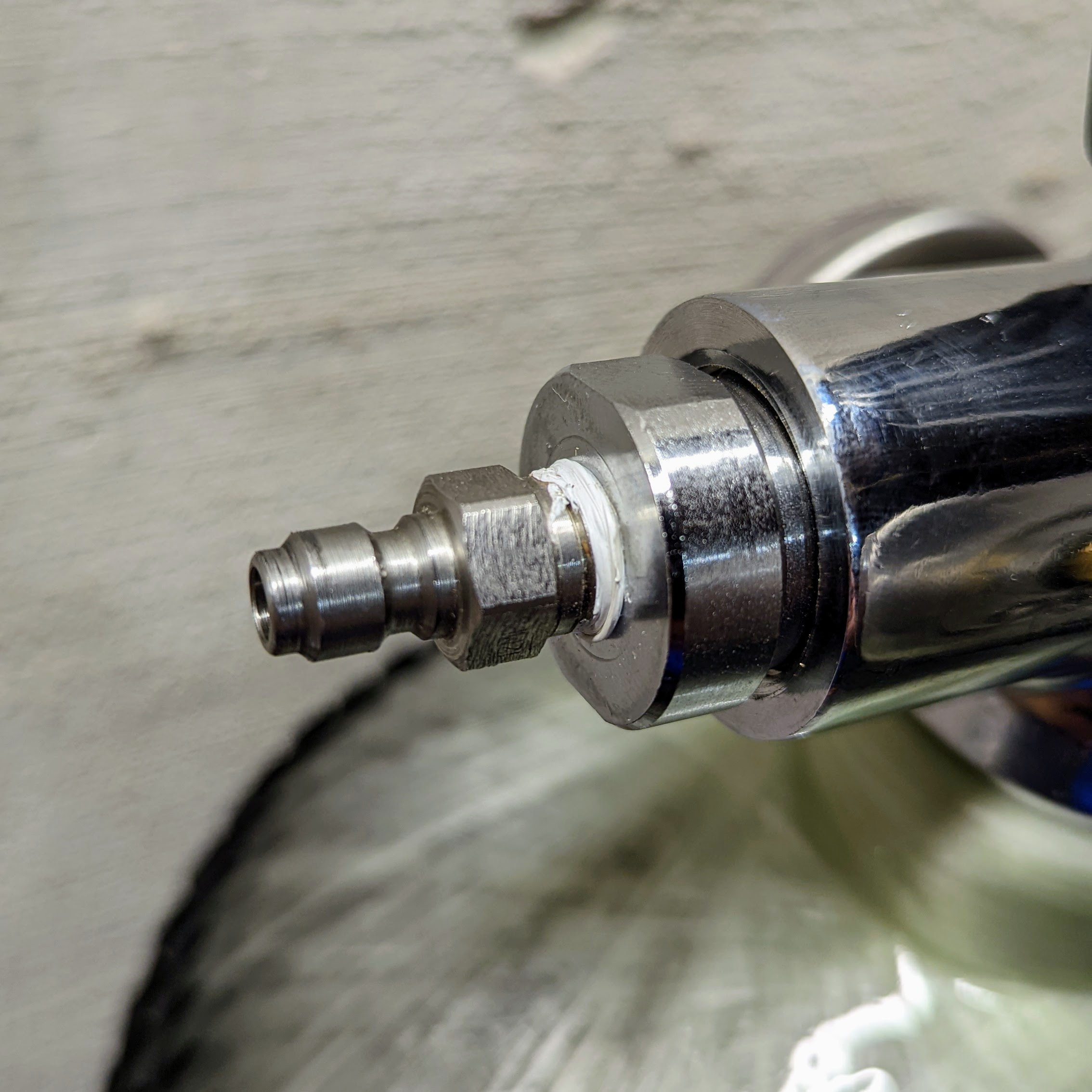

Took delivery of an Alkin W31 today (yes, I am STOKED 😊). Per my request, the fill whip came with a female Foster since my tank has a DIN 300 to male Foster adapter on the valve. Keeps things simple.
As currently equipped, can fill any tank with either DIN 300 or a male Foster (using the adapter on my current tank), but would like to be able to fill SCBA/firehouse fitted tanks as well, for a couple reasons:

Thinking that with a firehouse to male Foster adapter, and the DIN 300 to male Foster I already have, should be able to fill most tanks that PCP shooters would own. Would appreciate confirmation, or advice on alternatives if I’m all wet.

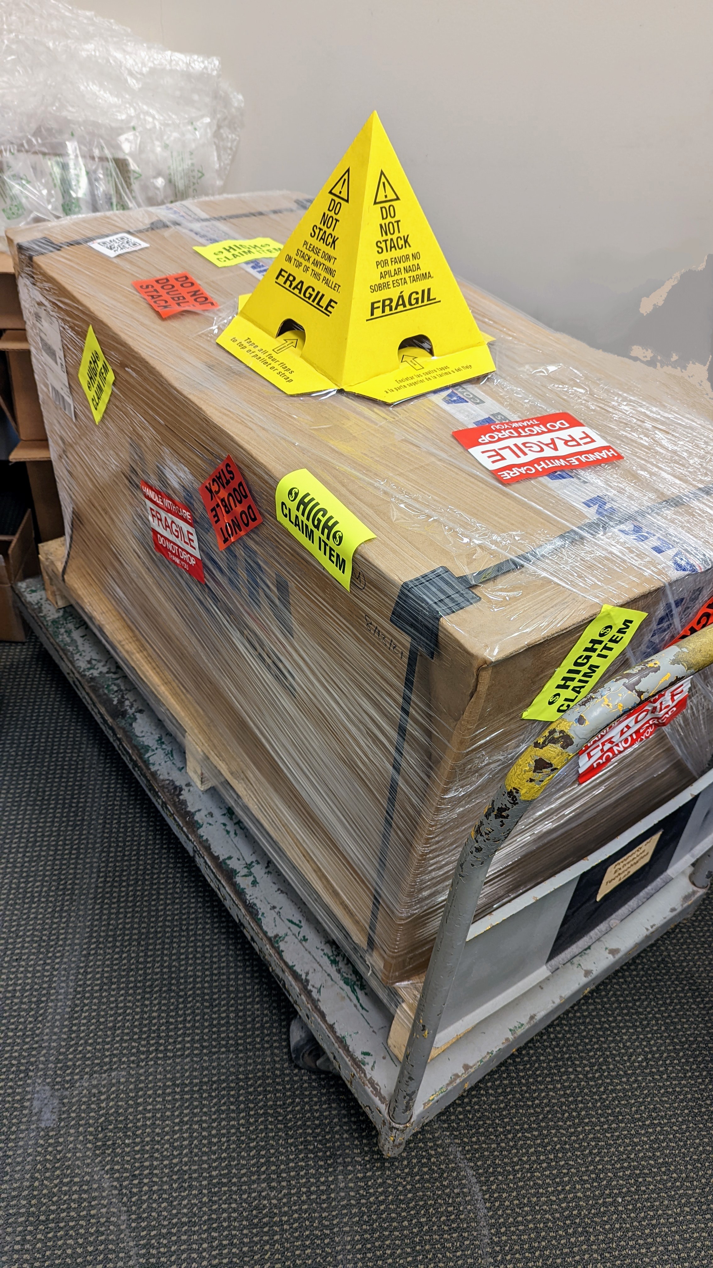

Btw, kudos to Alkin USA & FedEx – ordered the compressor Tuesday late afternoon, arrived this morning. As you can see from the photo, great pains were taken to emphasize careful handling. Apparently the FedEx freight driver took it to heart; nary a hole, tear, or dent in the cardboard covering.

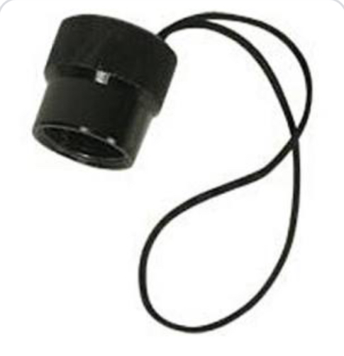

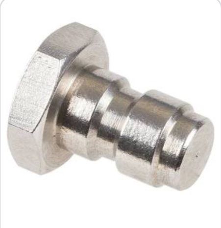

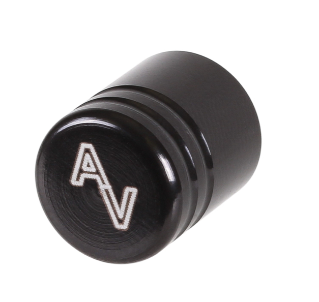

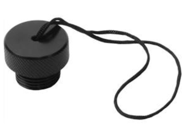

When I was in scuba we used caps on everything that dirt or bugs could get into. For my DIN tanks, fill whips and foster fittings on the microbore hoses I bought male and female caps for all of them.
Online the DIN caps and plugs were about $10 each plus shipping. At my local dive shop they were only $5 each.
Pictures are of DIN cap and plug and Foster quick connect cap and plug.
Randy

Have both the DIN to Foster & firehouse to Foster adapters now, so should be good to fill most tanks a PCP shooter would have.
