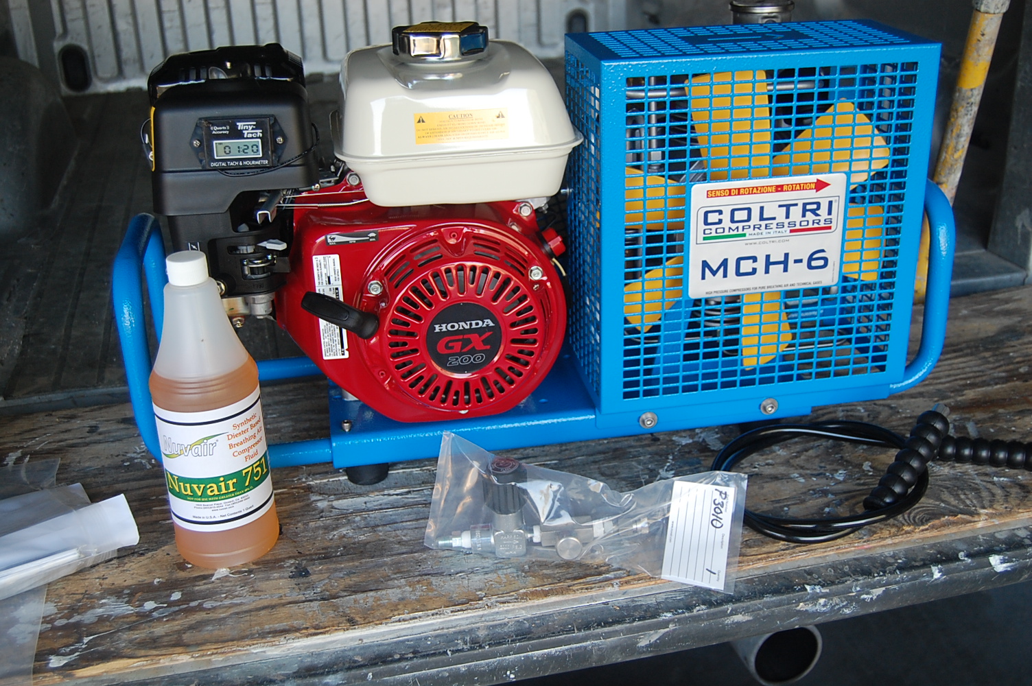

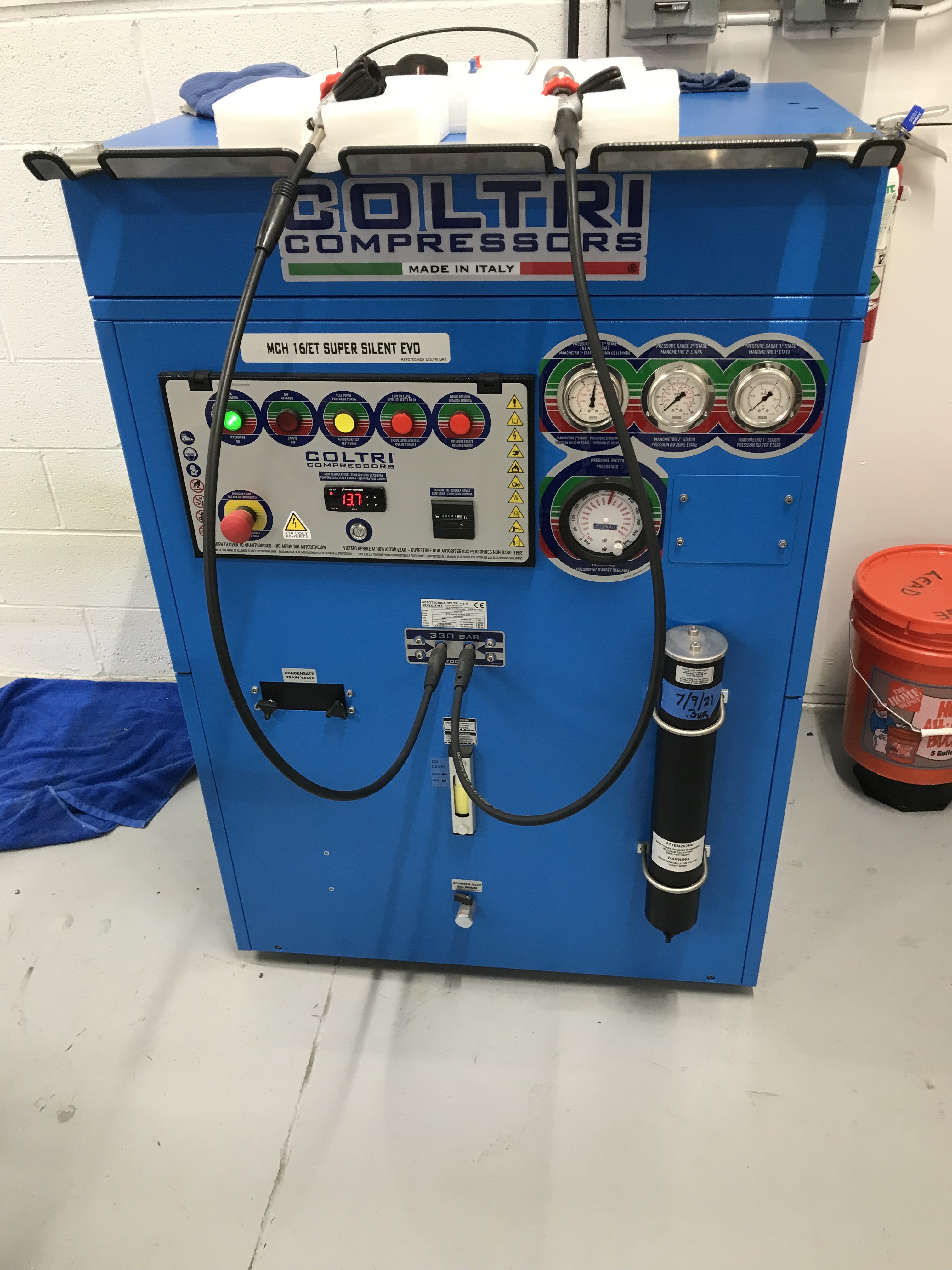

I use this ,its mobil and fast and about a $1000 less then a alkin. buy once its pays in the Long run.
