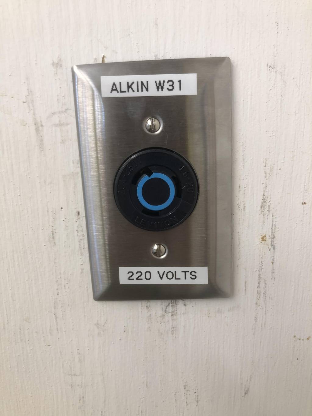

I got the 220V vertical model. Go 220V because it's in your electrical box, and unless you already have a "winky" outlet (110V 20A) you're going to have to wire something new in anyway, and, per Alkin's spec, the 220V machine is a little more performant.

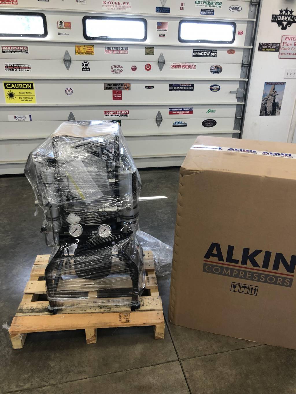

I got ahold of David Emen at Alkin, very helpful answering questions. It’s time to retire my 9 year old Freedom 8 shoebox with 431 hours on it. My new Alkin will be here next Friday!

Well it came yesterday, can’t wait to run my 220 Circuit. But first I need a little more rehab on my knee to go upstairs in my barn to run a 220 circuit down to my shop.
