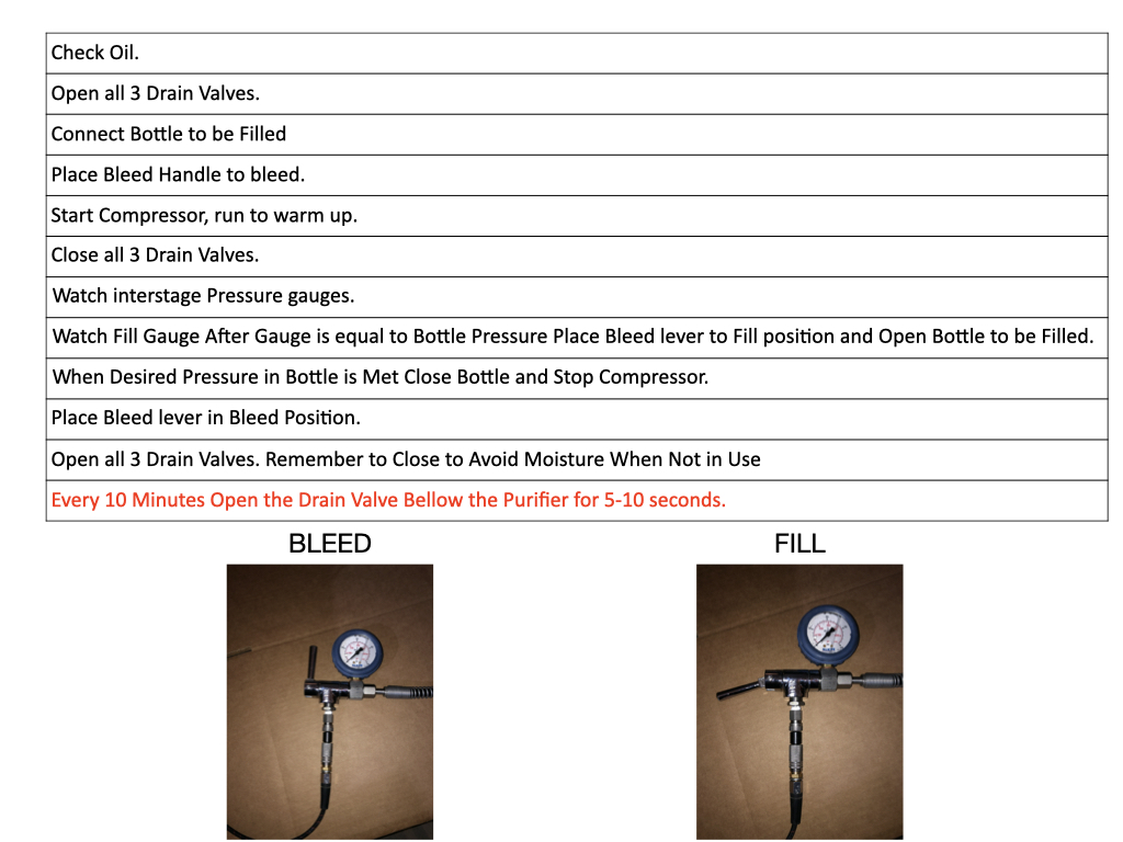

From watching the video. The way I comprehend is this. He is opening the two drain valves on the water separator to insure the compressor is not starting under a load. I also believe he is stopping the compressor in this order for multiple bottle filling. Which will not apply to me as I only fill one bottle. Notice as he opens the two valves on the separator before the pressure was bleed. Since that didn't bleed the air from the gauges it tells me there is a one way valve in play. At work we have a 4 stage compressor that supplies a tank that is 12' x 2' and there is a one way valve between the bottle and priority valve. In the air gun world its called a PMV.
thats how I see the video, I have been wrong before. Here is how I fill.
All I am saying is in one video he is stating you should never open the valve on the bottle and put air into the fill whip as the "back-pressure" may cause damage to the o-rings in the fill assembly. In the other video, he is doing the complete opposite.
I wait for the pressure to build in my fill whip before I open the valve and then the bottle. That's the only difference I was trying to point out.
I was always under the belief that with the compressor turned on, one or two bleed screws are open to let the compressor get nice and ready and not start off on a load. I usually count to 10 and shut off the bleed valves.
then I let the compressor build pressure till it’s pressure is equal to the pressure in my SCBA tank, and then and only then do I open up the valve knob on the SCBA.
One at 4500 psi, I shut the knob valve on the SCBA and upon a half turn from full close, I’ll quickly open up a bleed valve so when I turn the compressor off there is no back pressure, as air within the compressor is already venting out.
From there I open up the remaining bleed valves quick like. My Alkin W31 has three areas for air bleed- at the bottom of the water filter separator, at the oil n water separator, and finally one at the end of my fill whip, close to where it connects to my SCBA tanks.
So, has the method changed in start up and shut down, or has a better method been developed to aid in compressor life that I’m hearing?
That's the part I'm trying to figure out. But I like the first way of doing it better. It just makes more sense to me. Maybe an Alkin rep will chime in and let us know if there is a big difference between the two methods. I just don't want to damage my fill adapter/valve.
Keith.
I will continue by starting up with bleeders open. That is a no load condition and that can not be improved upon. And I like letting the pressure build to bottle pressure before opening the bottle letting air flow. I think filtration will be best with that method.
