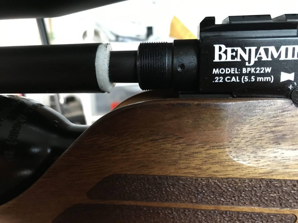

I’ve tried a Sumo and a Ronin and a Tanto on the Kratos. The noise is already so low on the Kratos that it really didn’t make a huge difference with any of them when threaded to the shroud. Just kind of changed the tone of the sound, and I didn’t care for the added length to the shroud.
However, with the shroud off and threading the donnyfl directly to the barrel the sumo seemed to sound the best to my ear.
I recommend putting a small wrap of foam rubber around the barrel inside the shroud where it attaches to the barrel. The shroud is vented through the barrel adapter and much of the sound you hear is coming from that tiny vent hole. It made a very noticeable difference with my Kratos.
Keep in mind that a pellet in the barrel will have a large impact on the sound output compared to a dry fire. The pellet acts as a cork (in most cases) that keeps the valve from free dumping air with a good tune. The valve ought to close before the pellet leaves the barrel.
Also, environment has a huge impact on perceived sound levels. A covered porch or metal building wall will reflect that sound impulse.
