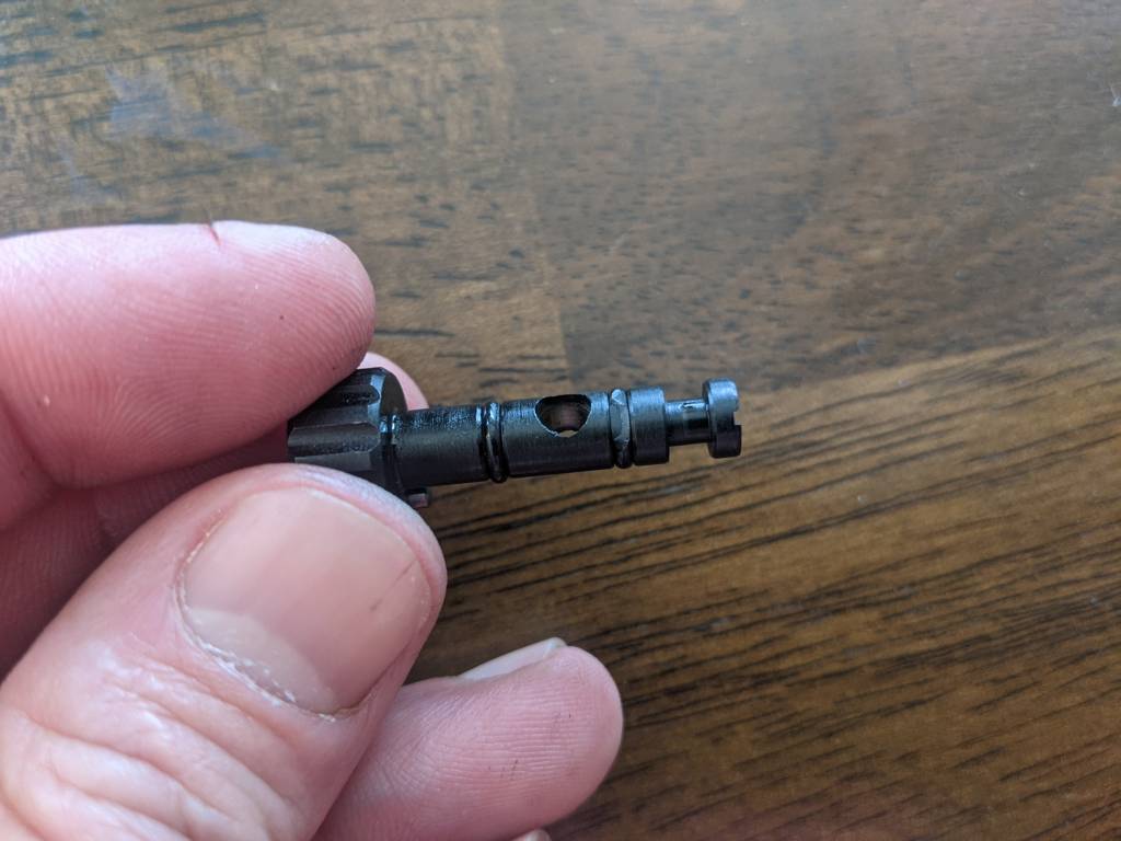

After receiving a new to me Akela I noticed a puff of air coming from the left side of the power dial during 3 test shots. With a quick search for disassembly directions I found a chopped oring as the culprit.
Local oring store hooked me right up on replacements. The fourth shot from the gun is puff free.
