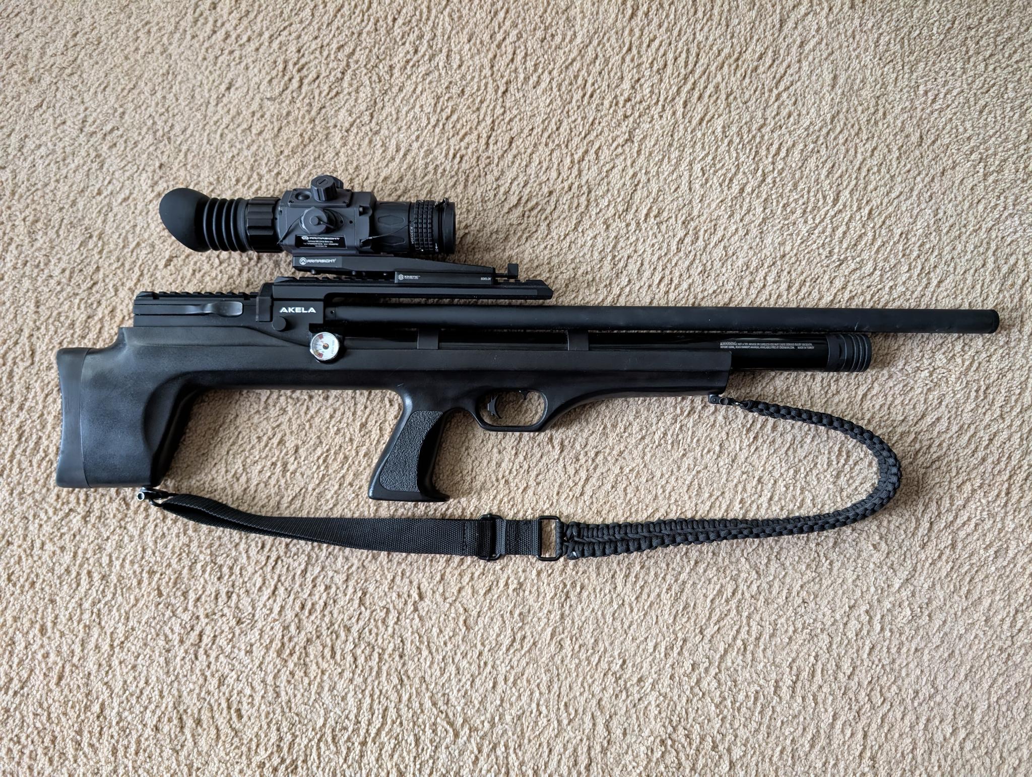

Ok to the Akela modifications. Pic is attached. I cut my Akela stock down a bit, getting rid of what I considered "excess" lower stock wood. I found it wasn't required structurally, but was more for looks. I didn’t need looks, and it just kinda got in the way. Perhaps because I so rarely shoot anything bullpup.
So I streamlined it, sanded it, then rattle-can painted it black. Mine didn't come with fancy wood ... it was what the Turks were calling "Turkish Walnut". I found akin to pallet wood and mine didn’t come with much of a finish on it, maybe the very lightest of walnut-ish stain, but no poly or varnish over that. So spraying black didn't bother me. It fit the purpose as simply a rat killer.
My only complaint (if you can call it that), is that the top of the picatinny rail is so high from the bore, that the center line of the optics is over 2.5" over the bore line. If shooting at much of a distance (say 50 yds and beyond), this isn’t a big issue. But when shooting under 30 yds and wanting a <1" group for clean rat kill shots ... it means memorizing the convergence of the bore line vs optic line.
I chose to sight it in at 40 ft, which with that large convergence has me holding almost 2” high at 20 ft. So high in close … then POI is 40 ft … then hold low to about 55 ft, then gravity has you holding high again from then out. Geez… But you get used to it.
So most shots are under 40 ft, at about 25-30 feet. But the barns are 50 ft long, so we keep the convergence (POI) sighted for 40 ft. Make sense? Just “different” for someone used to taking long 250-300 yd coyote shots where all you are concerned with is “hold over”, not any type of “hold under”.
Last whine ... the picatinny rail on my Akela wasn't true to specs. It mounted my cheap telescopic scope mount and it mounted the chinese Halosun 310 HALO sight, but the thermal scope's QD mount was spot on picatinny rail specs, true military-grade. It would not fit down in the picatinny rail's slots. We didn't modify the thermal scope's QD ... that’s a $4500 optic/mount. But instead we carefully opened the slots on Akela's picatinny rail till it would fit down in them. We mic'd it all out, it clearly was the Akela that was off specs. But this solved it. A little black touchup and you can't see where we fixed it, and now the thermal was on it super snug. Then simply sighted it in and were shooting thumbnail size groups ... in the dark!

Is the stock sprayed with rattle can bedliner? I did a broken stock Daisy 853 with spray can bedliner, after repair, and it came out great, looked like a synthetic stock.

Nah, just used good old hardware store black spray paint. I used flat black, but then after it dried I buffed it with an old towel and it kinda shined up. Didn't care really how flat or shiny it was. I just had to do "something" after cutting off the excess "decorative" bottom wood the Akela comes with. It was just unnecessary and in the way. But cutting it off and sanding, now the light stain finish the Turk manufactured did was fouled ... so went with black rattle can.

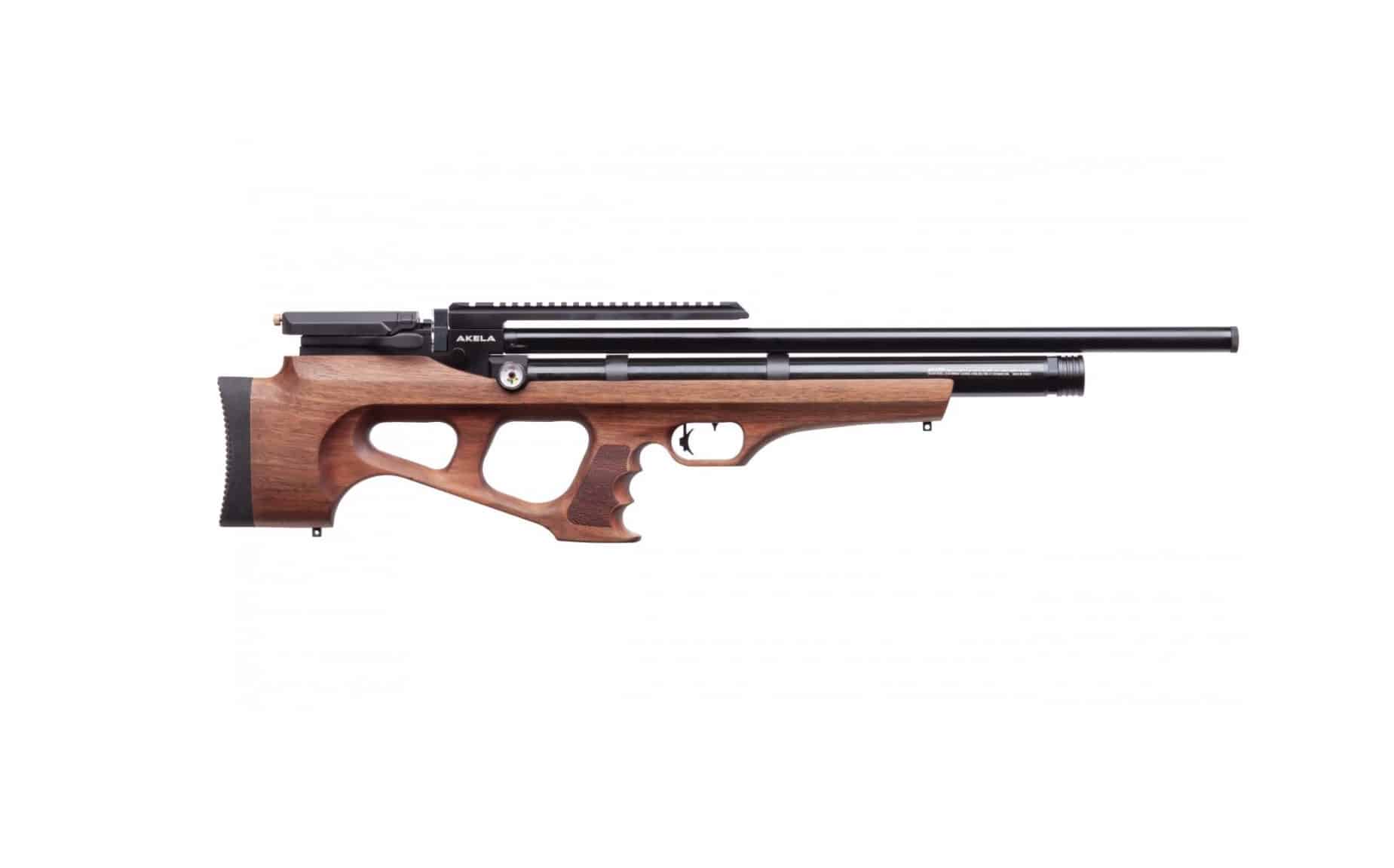

This is how the Akela normally comes stock-wise, for those unfamiliar with the model. You can see the "excess" wood I cut out between the pistol grip and shoulder stock. Oh and my stock wasn't even CLOSE to this in "pretty". As I said, it was like lightly stained pallet wood. So no regrets hacking at it and rattle-can painting it.

I have a .177 Akela. My stock looks pretty good, I don't mind the "decorative" part. If that part ever breaks, I will revisit this thread, and copy your work. Looks great.
