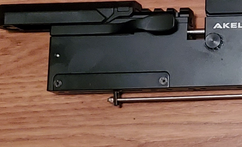

I’m not clear on the trigger operation. I pull back till it stops. Nothing. I let off and pull back a second time and sometimes it fires and sometimes I have to let off and pull again. Any ideas what’s going on?
Sounds like the trigger is out of adjustment. There is a little locknut on the end of the trigger rod and it may be backed off too far. Take it out of the stock and cock the gun. The nut should be within a few thousands of the lever it goes thru.

Yes. It takes a 5mm allen wrench to get it out.
Here is a pic of the nut to check.
