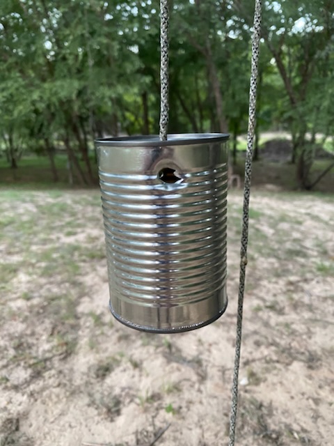

I put two in a brand new bean can at 35 yards. First in was a larger hole, second in may have made it a tiny bit bigger, the out hole appears the same.
Ought to be a critter gun around the chickens if need be.
On to the can

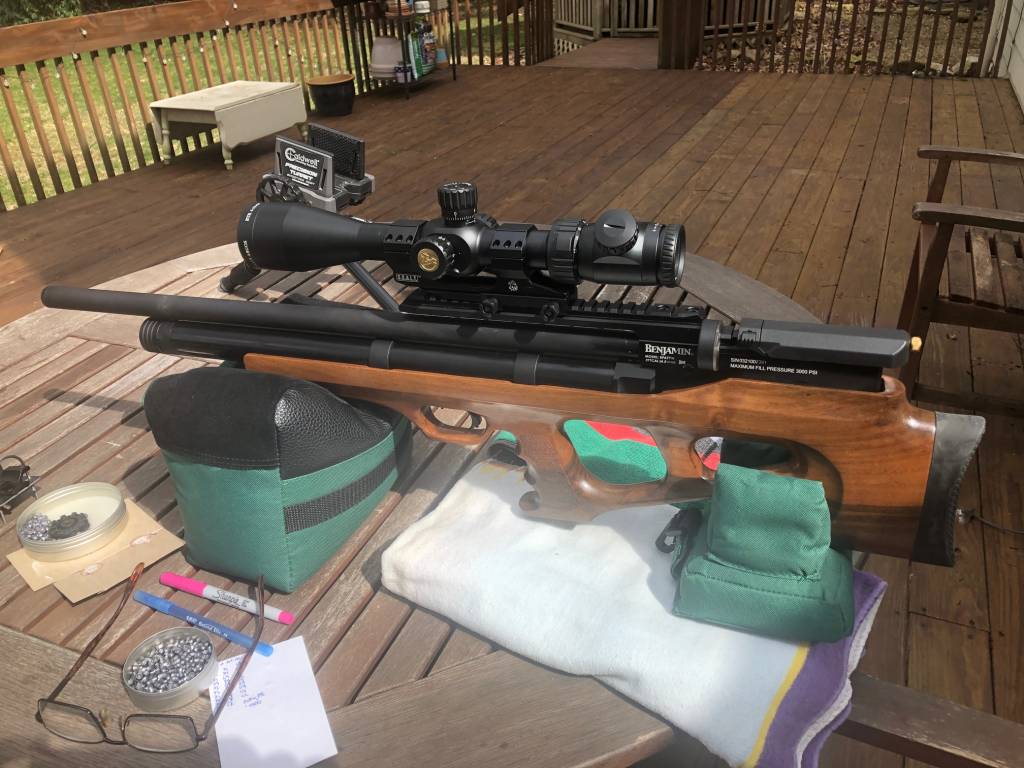

Besides shortening the hammer spring, I also stripped my Akela to bare wood and refinished the stock with Tru-Oil.View attachment 207526View attachment 207536

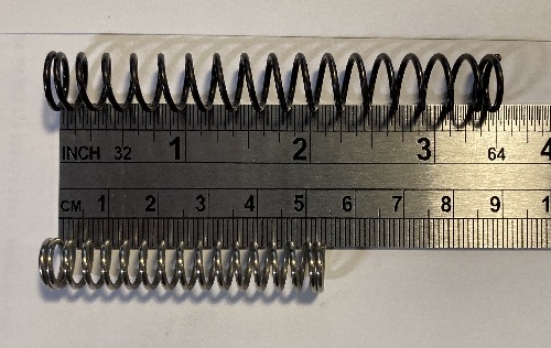

Since I'm always first in line for everything... I finally am getting around to opening the Akela up for the spring mod. I ordered 2 springs in May, and just set them aside. I opened them up this morning, and much to my dismay:
The original (pulled from the gun) is on top, the "replacement" is on the bottom (both new springs received are the same size). Ugh - time to order again. I don't know where the short springs may fit.
