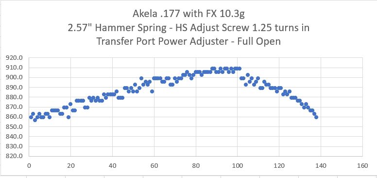

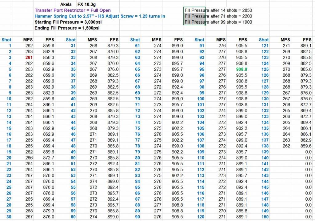

Over the past few days I did so. Results show that my Akela now gets 140 usable shots from a 3000psi fill (!!). The freakin thing is the 2nd cheapest airgun I own - and it shoots dime sized 5-shot 40 yard groups over and over again. The best group in this shot string measured .09” - yep - no kidding - .09” at 40 yards (40.38 measured with a green laser). And I’m not trying that hard when you are just firing off group after group.

Shot 46 to shot 121 are within 20fps of each other. So, seems to me that would be a good fill pressure to use to stay within 20fps with your Extreme Spread and have the best accuracy for close to 80 shots.
Good job on the testing and good post.
Agreed, I could fill to about 2600 and get a 20fps extreme spread.
However, at normal pellet gun distances of 25 to 50 yards, my experience target shooting has shown a minimal noticeable POI shift with even a 40fps spread. This is especially true with .177 (flat trajectory) being shot 870-910fps. The difference in POI due to a 40fps spread at 40 yards is likely less than the POI shift due to pellet to pellet variances if just shooting unsorted JSBs from the tin.
Thats why I think a lot of shooters should really test this and consider their use case before purchasing a pellet gun with dual regulators and 40+ o-rings (I’ve been there, done that). If you are typically shooting 50 yards and in, you don’t need a 3fps spread to achieve consistent accuracy. It’s crazy overkill IMO. I started with regulated PCPs and now own 3 unregulated PCPs. They all seem as accurate (Daystate Huntsman is crazy accurate) as my regulated guns.

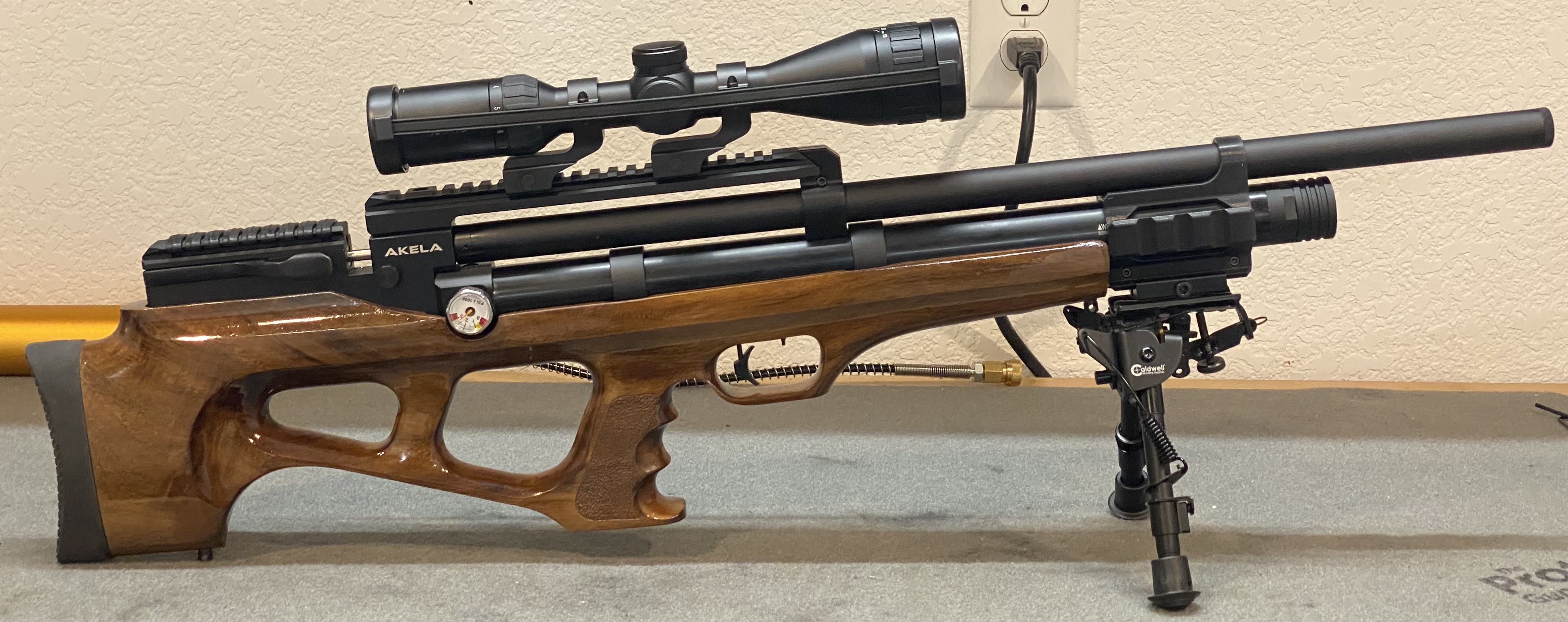

Besides shortening the hammer spring, I also stripped my Akela to bare wood and refinished the stock with Tru-Oil.
nice looking results on the stock. Thanks for the information on your adjustments. I have the cayden and it shoots good, I'm happy with it. I've thought about the Akela but the cocking lever being so far back, and on the right side, (I'm a lefty) would be a challenge. I still like to see results from owners and what they are doing with them.
