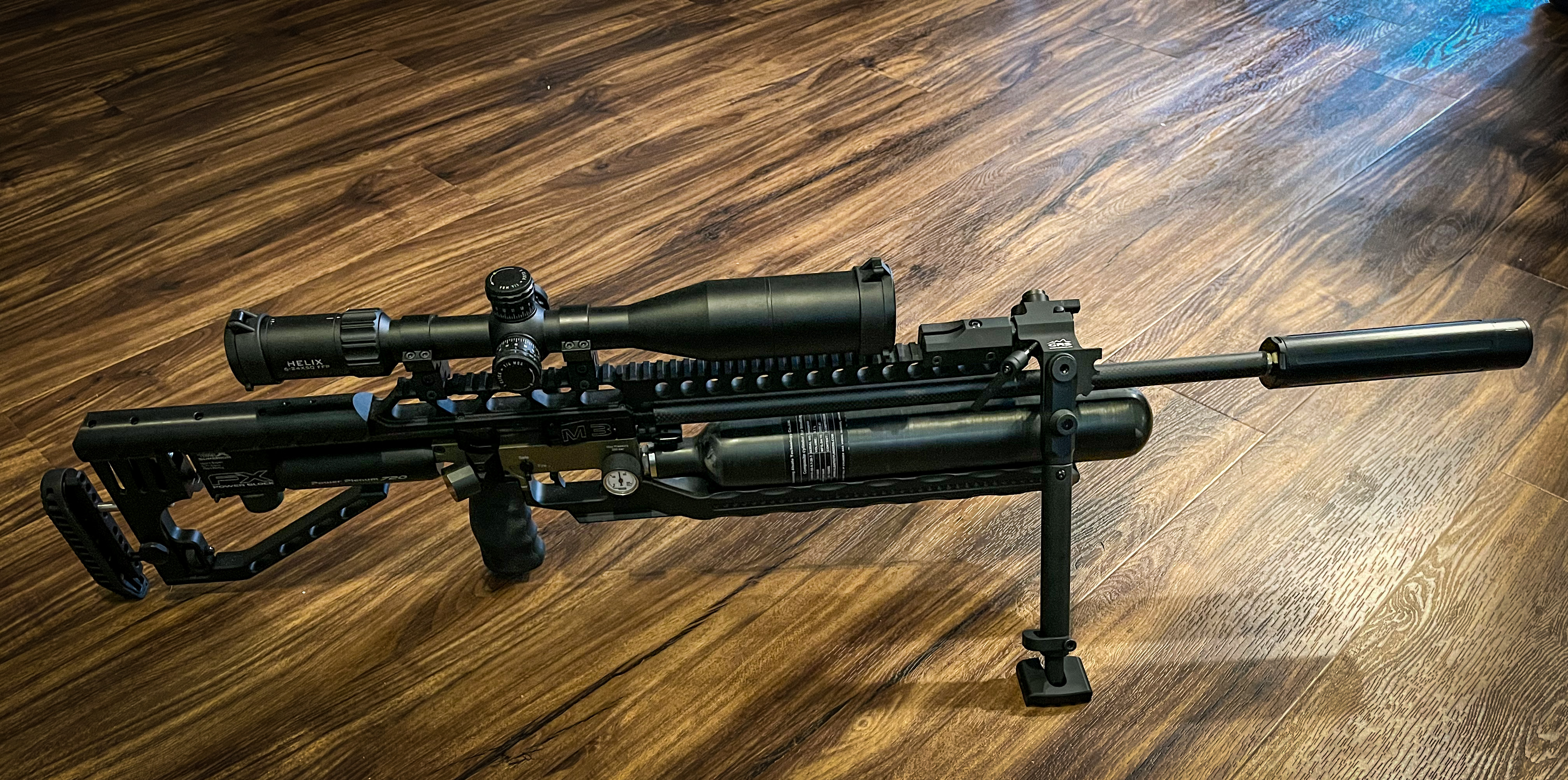

I have the 30 moa long backbone on my .22 impact withe the 800mm tensioned barrell. I LOVE it. Not sure if if improved my accuracy or not, but it certainly did not hurt my accuracy. The rifle feels more solid and I like the extended pic rail for attaching a top mounted bipod. Really lets me anchor in.
Would I buy the backbone again? Absolutely. Cameron that runs AirMarksman out at Utah Air is a great guy and I promise you will be taken care of.
