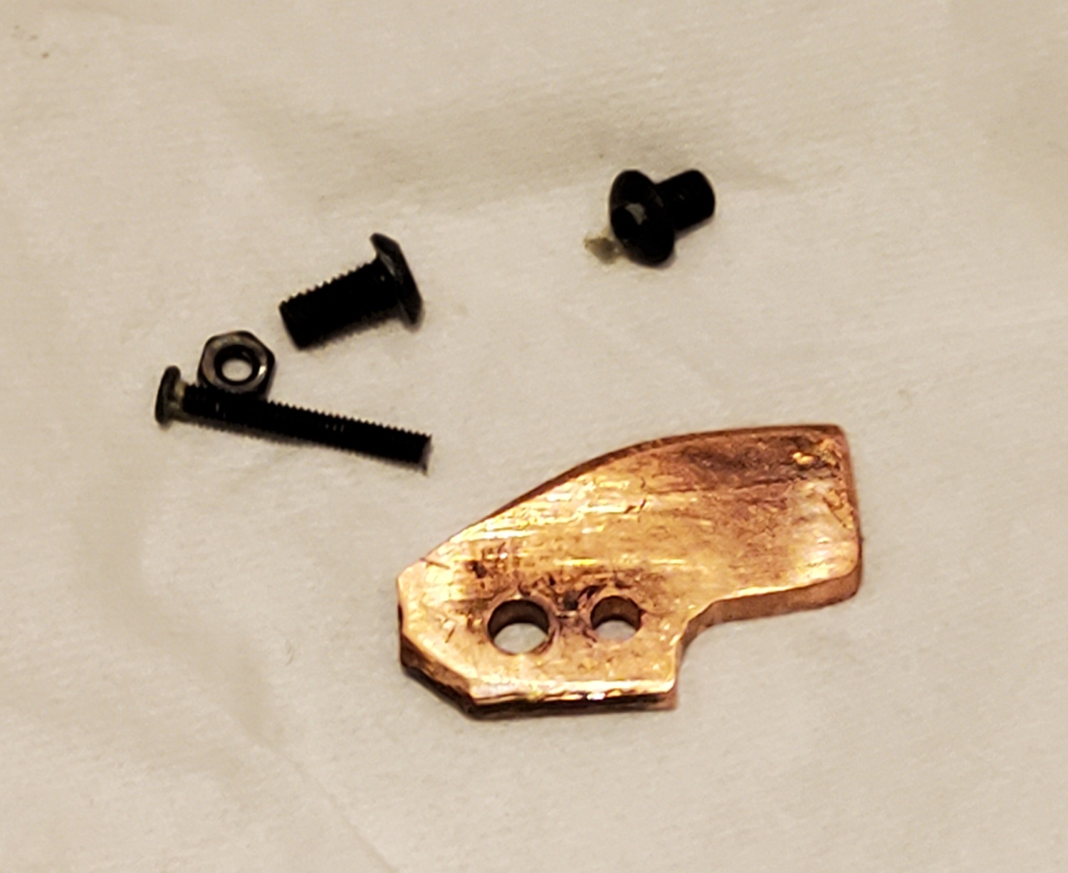

i have the Krait L then got the X 700 barrel with its shroud. shot ZANs .219 28grn and it was good with wiered behavior! as one group on top of each other and the other all over th place! my first issue was the hammer couldn't open the valve above 136ish Bar. and the other issue was wiered tight spots in the barrel and few other minor issues.
I'm still chasing them down and have 2 input about it! one thread and the other is progress post.

But hopefully after the hammer mod i would be able to do it, 🤞
still it a work in progress to rectify all the issues in it. but the new speeds are promising 😅

What or how are you modifying the hammer? Are you sure it's not the actual hammer spring holding you back??
A good replacement hammer spring can be made by purchasing these &cutting them to size. There practically identical dimensions, but higher quality than the stock springs.

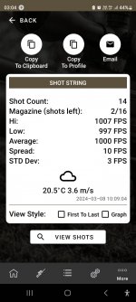

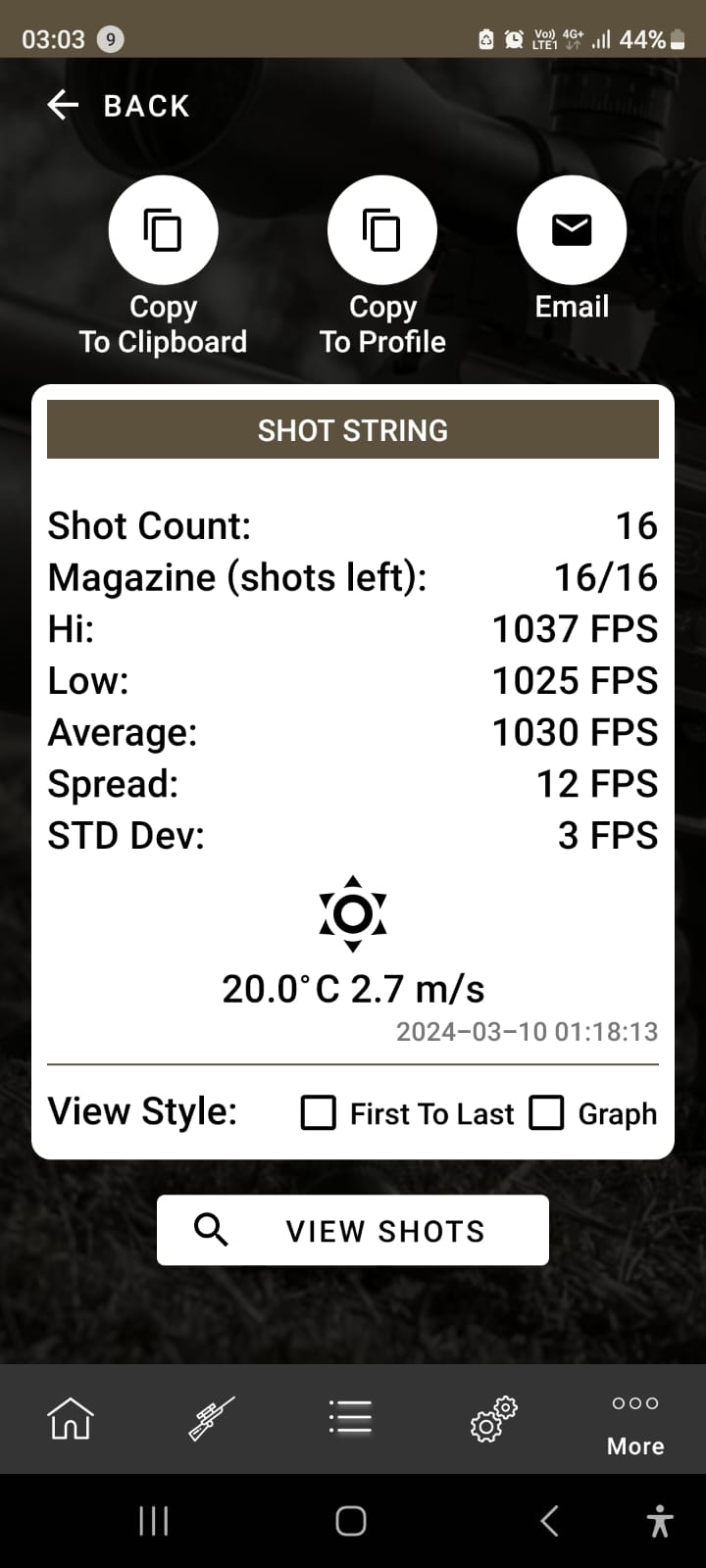

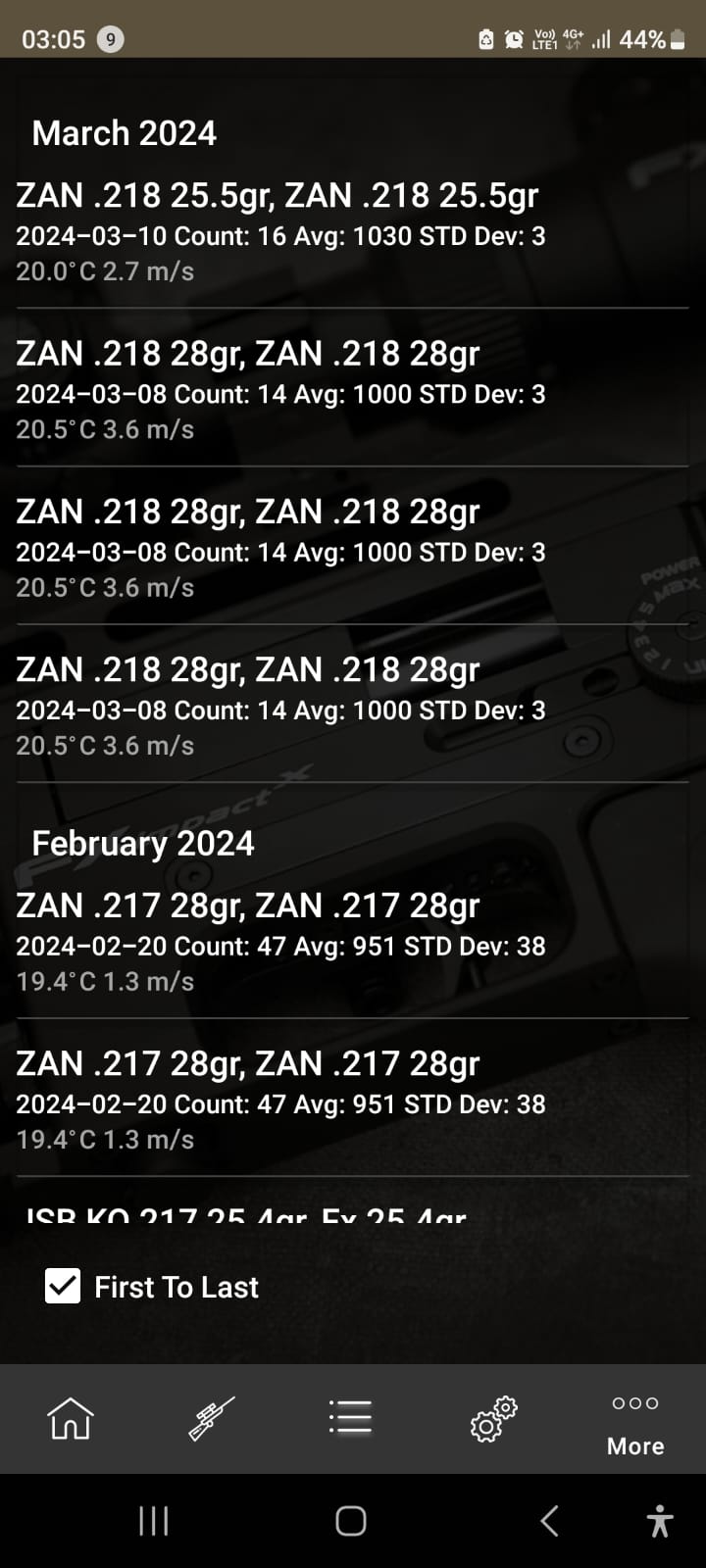

i fabricated it from a brass bar, it added about 9 grams. i wasn't able to open the valve pass 136Bar mark! and the spring was all the way in just a hair under the sear engagment to hold the hammer cocked.
no it can open it with ease at 149 bars, one and half a turn off the sear locking out. i even dialed it out more to shoot @140 Bar .218cal 28grn @1000 fps and .218cal 25.5grn@1030ish fps.
and the speeds were tight.
