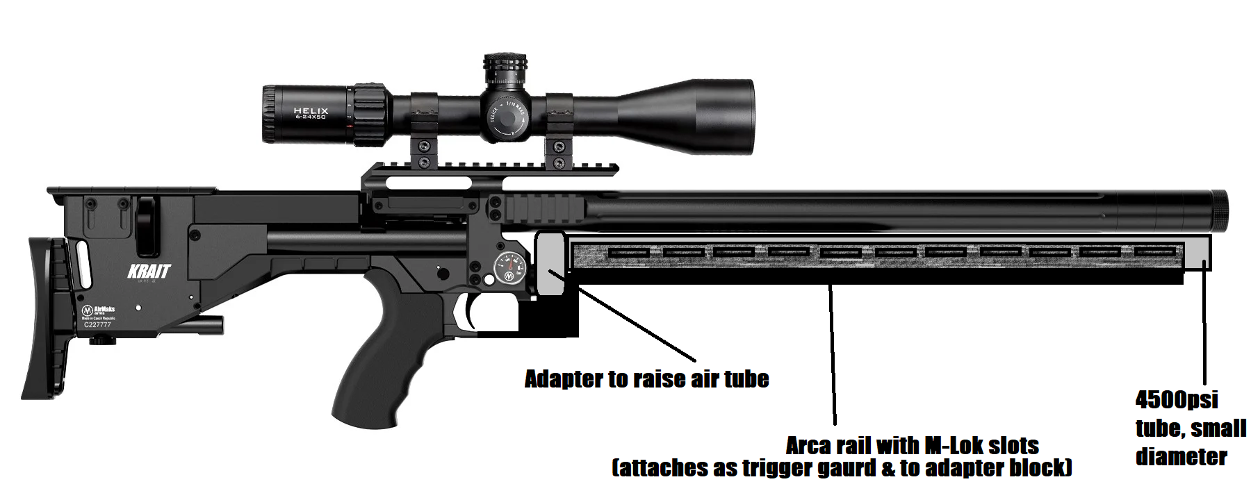

Here is my idea for an NRL22/PRS suitable Krait X. I do believe this platform has the DNA to perform, but a few modifications could make it actually viable for positional competition. Other than the modifications below, I would also GET RID OF THE DAMN FILL PROBE and thread in an actual proper fill nipple with a 1 way valve... This would get rid of the dust-collecting hole in the gun and reduce machining time (costs).
Here is what I came up with:
I did send this over to Airmaks and pitched the idea of doing an "Air Shootist" edition Krait X (I know.... I know...) 😁
Thoughts on the above design?
no notes, sign me up. Well, one note: Get rid of the high pic rail and machine a 30moa pic rail onto the receiver. And make sure the hand guard is stout enough for 4-5 pounds of weight. So two notes. But other than those, no notes.
I thought about that but you would need to drop the whole action to get a proper cheek weld. Nothing you can really do about that. You actually need the high pic rail for this gun

Just responded to an email from the Airmaks designer with a lengthy description of everything I'd do to the Krait to make it a positional match slayer.... This could possibly become a reality:
I'm going to work as hard as I can for this community to see that it does. Having more guns from different manufacturers available for positional (PRS/NRL22) style shooting is an overall benefit to the sport. Consumers having more choices encourages manufacturers to keep producing better and better stuff. We all win.
