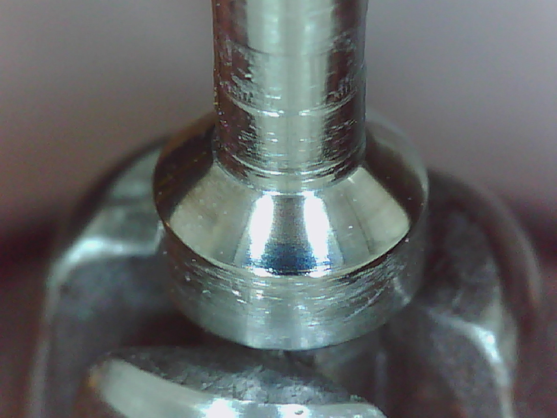

Tengo un Krait desde hace meses, lo compre sabiendo que el regulador no funcionaba, ya he modificado tres de ellos y funcionan perfectamente, ahora solo me queda hacer una prueba reemplazando el POM original por un POM compuesto de grafeno asi que que la deformación en la zona de contacto con el eje metálico es mínima y tiene un flujo cero más rápido.

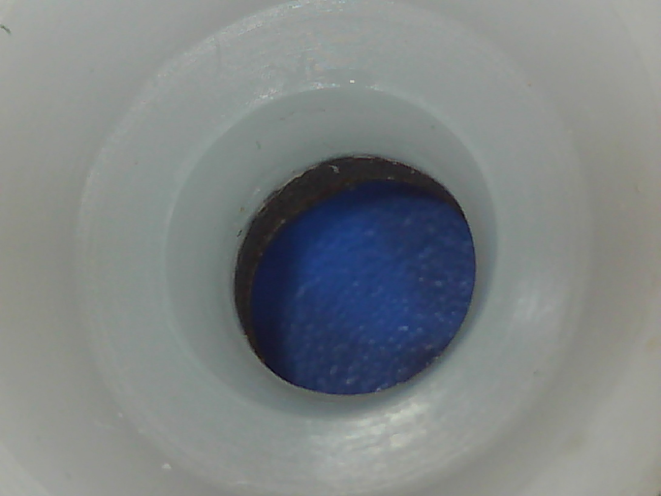

This is something they should try for their next version reg. I guess it would be a V4 or V5 by now. This is a true poppet approach. But that Delrin seat is going to need to be made out of Peek for the 300b filling guys. Making that cut on the soft white seat did not leave a lot of meat on the bone for the pressures that reg is going to see.
Man I can't wait for the V27 reg to come out! 🤣 🤣 🤣 🤣 🤣
The likely solution, which I already mentioned to Airmaks, would probably be to have that delrin area removed and replaced by just solid metal with a machined / ground lip on it that seals up to a cup seal on the actual pin itself. Anyway, it will be interesting to see what they come up with, if anything.

Anyway, we are stuck with it now unless my cousin can convince Krale to take it back (not likely). So we will try to polish the sealing surfaces and possibly get a machinist to make a correct sealing surface for the reg. What an AMAZING VALUE for $1700!!! 🤣🤣🤣
