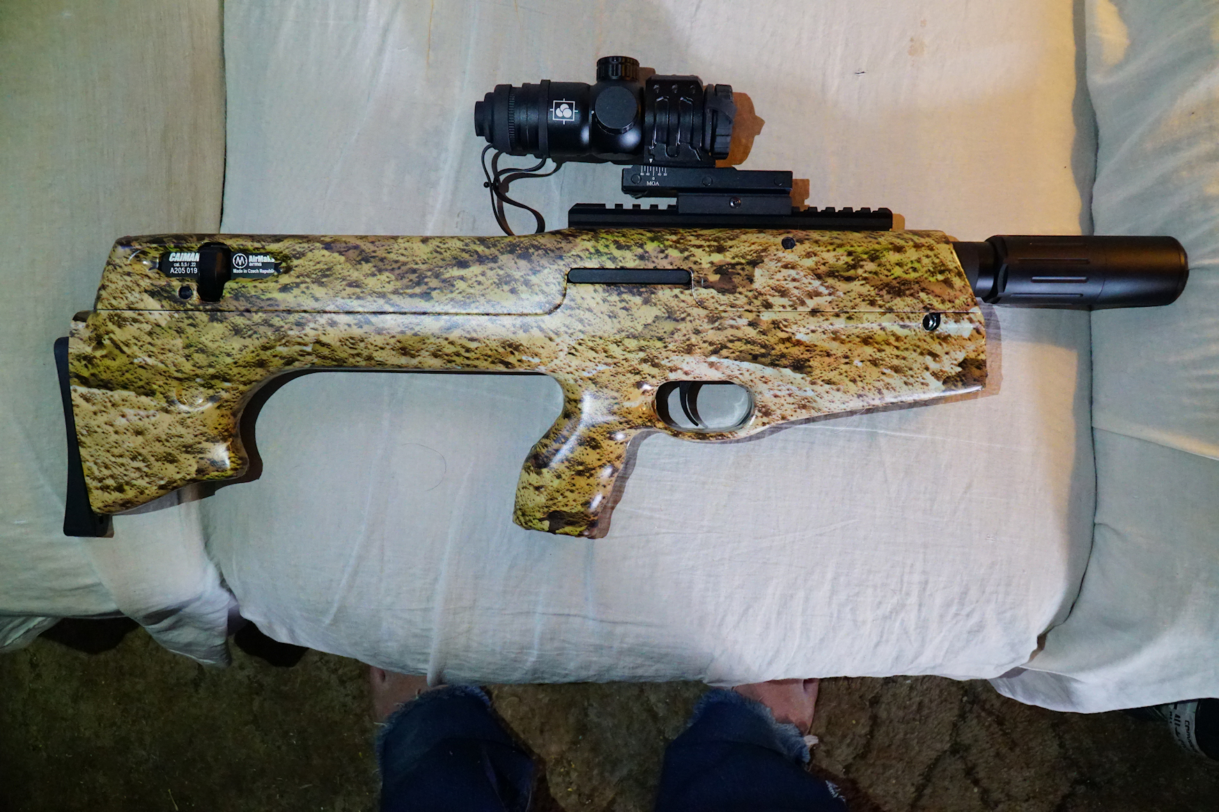

Will one of you guys post some
Pics please …
"Pics" of what ?
The same guns that are in the web sites ?
One of mine...a bit different than on any website. Yes, it is a Caiman.
