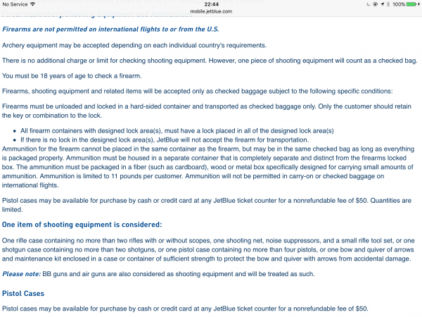

TSA's interest in firearms is the same as their interest in anything that goes into an airlplane. They need to verify that nothing in your luggage or freight can bring an aircraft down.
It is the airline that regulates whether you can bring a firearm and the quantity of ammunition you can put in the hold. It is also the airlines that regulate hazardous materials, ie. pressurized canisters. Technically, the airlines require that pressure canisters be open to internal inspection to guarantee they are not pressurized.
If TSA encounters a locked piece of luggage they are not shy about cutting the locks off or refusing to let the bag fly if the owner is not present.
I have worked in the bag room here in Boise, and gun cases coming down the belt are no big deal.
The tsa need to look in your gun case when you first arrive at the airport. If they want to have another look they need to on tact the owner. That's why you shouldn't put tsa locks on. They can open the case without you being present. Also I would not trust anyone else present that knew the tsa numbers to unlock them. You can look the rules up saying the owner should be present when they inspect the gun.
Just to avoid any confusion, if you say you are carrying a firearm which shoots black powder then you are not allowed to take it to p.r . An air rifle which is Under shooting equipment may be taken on board the plane if it's in a rigid case etc. Also I agree that the tank should be posted if possible or take the valve out of the bottle. If you don't you may not get on the plane.
