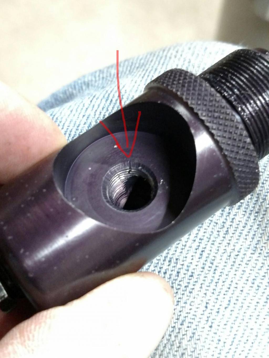

Ordered a Huben fill port with the fill gauge from Airguns 4 Patriots. Got it and it leaked at the gauge threads. 100% faulty machine work. Airguns 4 Patriots was going to send me another one with improvements. .....nothing and this has been well over a year. Emails are nothing but full of excuses. What to do? :-(

only way i can see a gauge sealing at all with those threads is if it fits flush to the bottom and an oring rides that groove .. get a slightly fatter oring and take it to a machine shop and get that chamfer milled out to a step .. you could probably diy it if you have a drill press with a vise, just get a proper size end mill bit go slow and use plenty of slickumup juice .. ..
