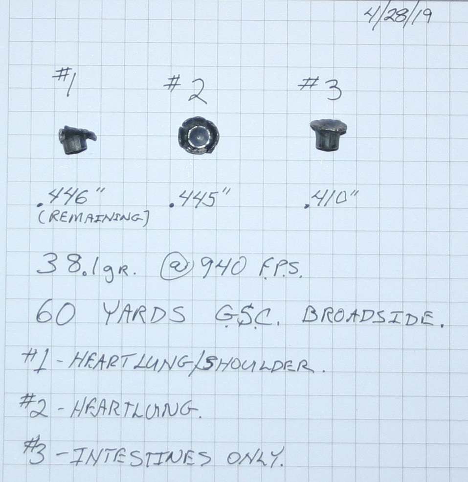

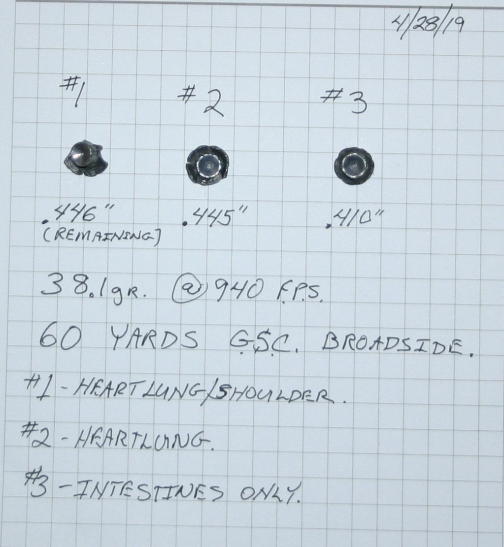

You're so right there. The fat just under the hide can fill a hollow point like you describe, and of coarse bone changes everything.
I've shot Ground Squirrel cadavers at 60 - 80 yards many times to verify HP performance. Even shot some .25 cal. slugs I make 200 yards testing for expansion at POI.
Here's a couple photos that help show those variables that you pointed out. Look how a different hit can make a difference in performance of expansion and obviously subsequent tissue damage to an adult Ground Squirrel cadaver.
Hope you find something positive in my posts. Just trying to give you another way of thinking about ballistics testing for airguns.
