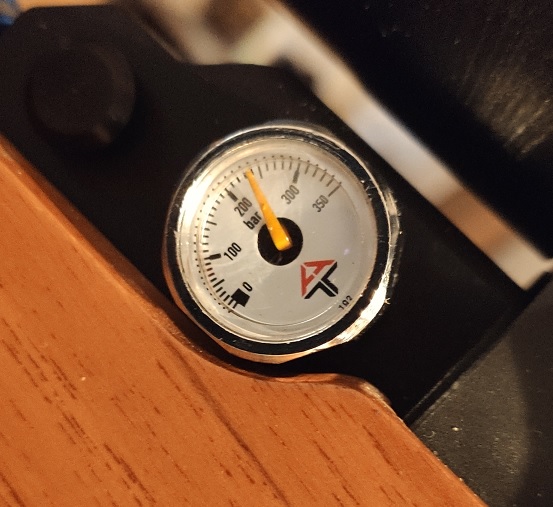

I just dug it out yesterday after about a two month sleep. Still had it's 200bar fill that I left it with. I put three magazines through it, and picket up another.
Another gun with a miniscule gauge in it. It may get an actual...readable gauge installed.
Shoots great, no complaints.

I really wish that one gauge indicated the regulated pressure, bottle pressure i dont really care much for as i shoot connected to a 12 L bottle.
On my Maverick i have just replaced the small reg gauge with a proper Wika one, that was a very nice upgrade.
Mike
If you find a bigger gauge that fits, I'd appreciate a link.

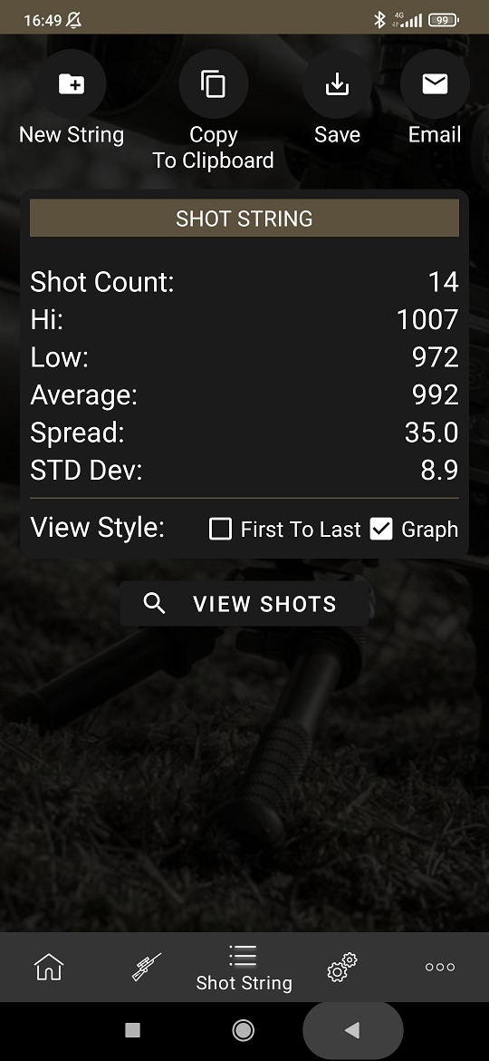

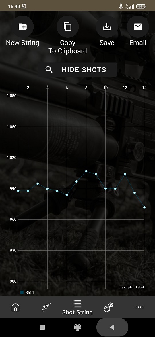

I will have to shoot the gun to tell if the #1 shot are faster, but it have been collecting dust for a long time now if you do not count the 10 or so shots i made when i put the new Huma moderator on it
Ill give it a go and report back, the rifle have been sitting idle for at least a week now since i got moderator.
Mind U the pressure are not all the way up there, i think the gauge read 180 BAR or so.
Well my grey gooe did not serve me well, the pressure in my rifle was higher.
Numbers from chrono also not as good as i recall them from last session, but this could be due to i was shooting 13 gr pellets then, this is 13 gr slugs ( KO )
But at least no "HOT" first shot, that to me would indicate REG creep while stored.
PS: I will have to tweak a little CUZ the V3 can make a shot string flatter than that.
