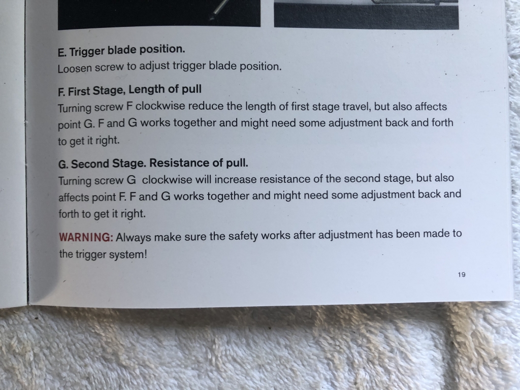

I just had an FX Crown fire while on safety (no harm done thank goodness)! This is 100% not acceptable and there is no room for excuses when it comes to ANY rifle firing while on safety. A safety should be an independent mechanical lockout mechanism that is not subject to “adjustment” or “fixing”. If this happened on a firearm it would be front page news. Air gun owners need to DEMAND better when it comes to basic safety related design. Having a valve leak or an O ring wear is one thing….a safety not working is a completely different matter! Someone is going to get seriously hurt, or worse!

Agreed. My Crown would do a similar dangerous thing. If you bumped the trigger when the safety was on, it would fire when you switched the safety off. It turns out the blocker set screw was not turned in deep enough. This should be set correctly at the factory.

My Impact did the same but the adjustment was off because I made it that way. After the adjustments I put the safety on and checked to see if it was werqing. To my surprise it was not and the gun fired. I made a quick adjustment and all was well afterwards.
They should come from the factory or a vendor in a working condition for safeties sake.

Enough people have chimed in about their experience about Badly adjusted triggers that we all should take Note of this condition...all triggers and safeties should be tested before a gun is "sent out".....and also by the buyer before he or she uses said gun.

We appreciate you bringing this to our attention and completely agree for the need for safety on all rifles. Please contact our customer service as we would like to ask a few questions and make sure we understand what went wrong. We appreciate everyone's help and concern, and I can personally assure you that in my 6 years of being involved with either selling or now being a part of FX that I have never heard of an instance of this happening outside of a user adjusting it. Please call us at 1-866-639-0772 (or email your contact details to [email protected]) and we will have one our techs ask some questions and get the serial number so we can ensure this is corrected.
