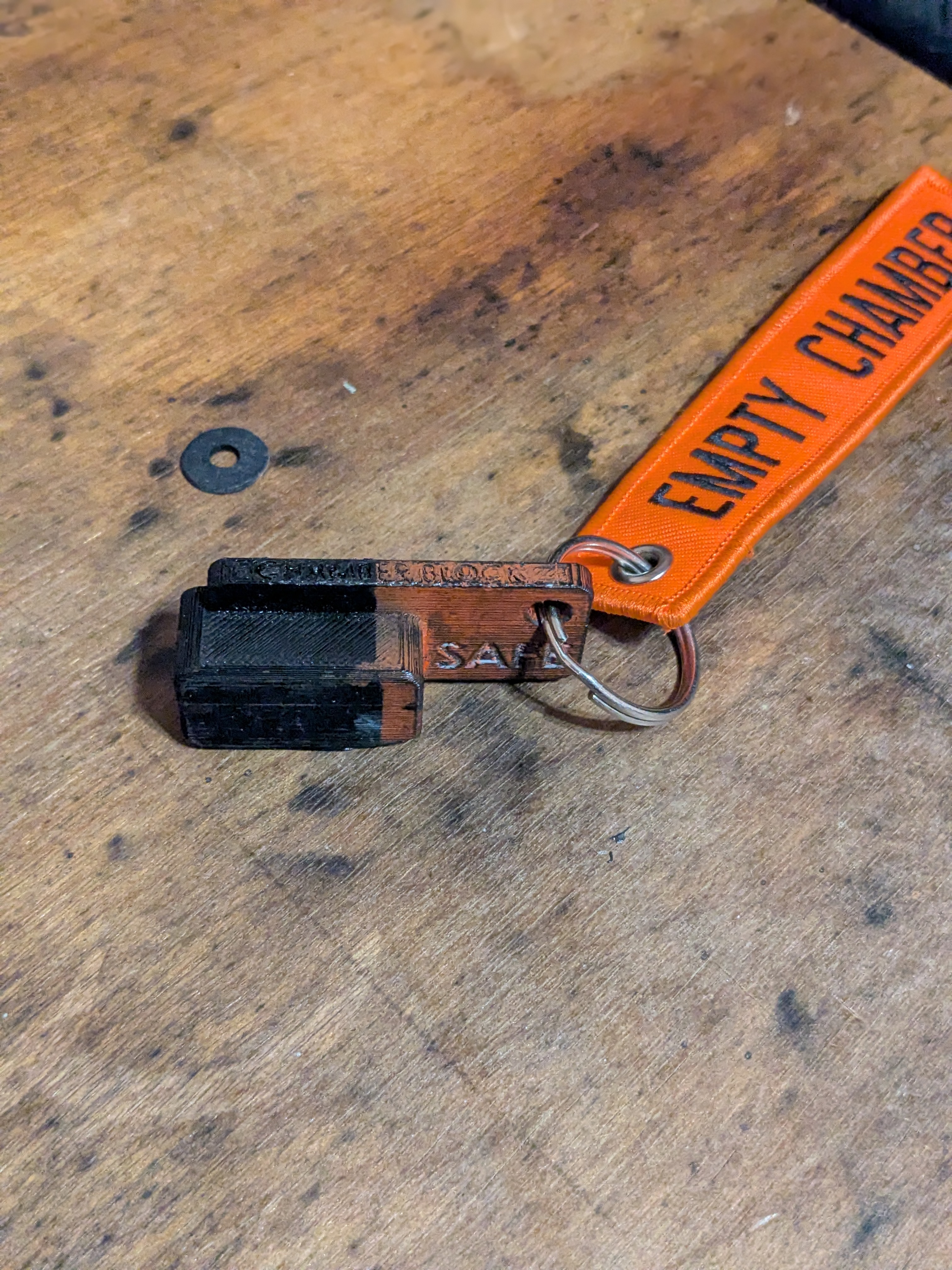

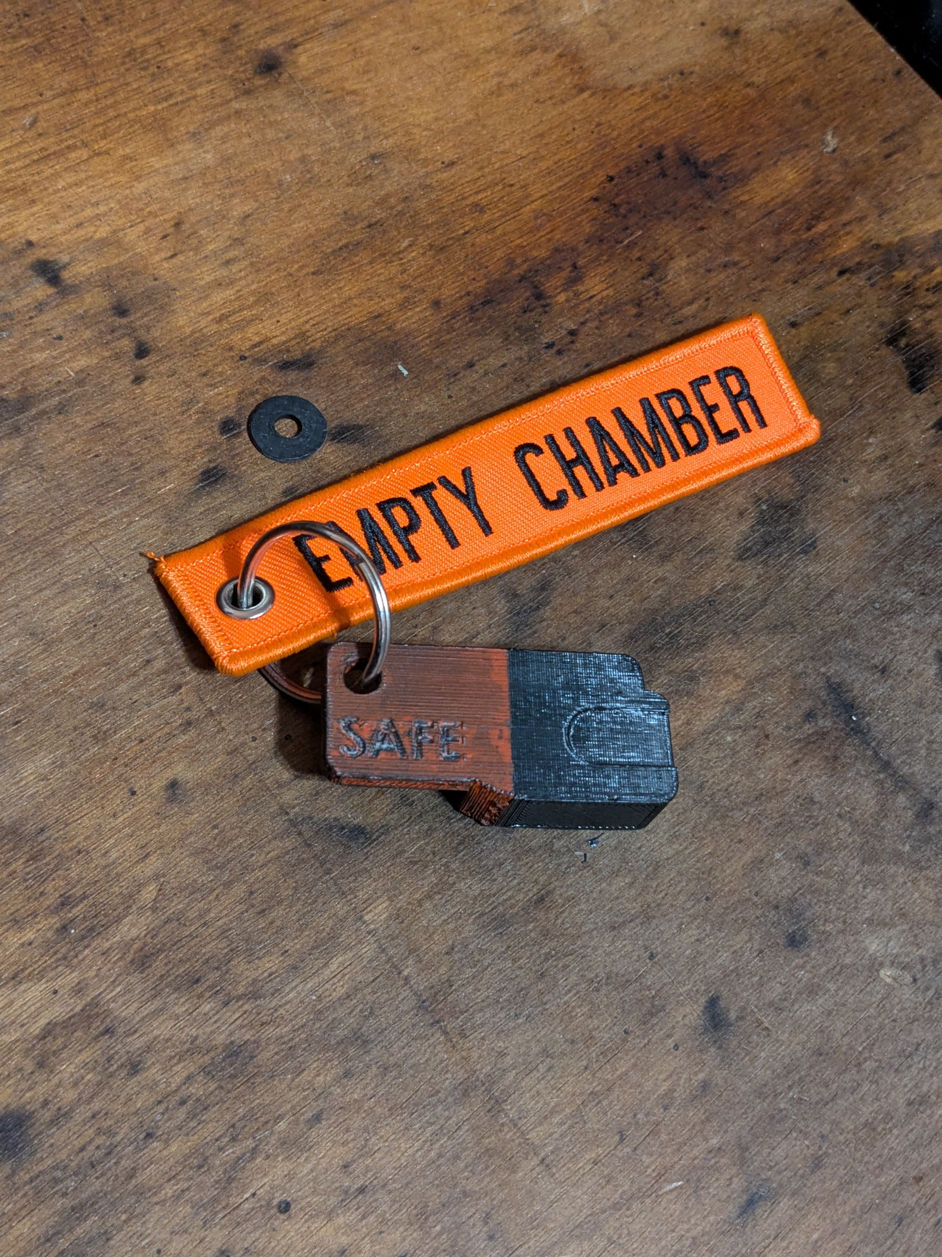

Hey Farmerjoe,
I have the means to print a chamber flag, but can't find a STL file for a Panthera. I was going to see how it shot first before in stalled a brake. If you know of a 3D print file for the chamber flag, that would be appreciated. Ty
I only have the very basic one I drew up for my DRS and if I'm not mistaken the panthera has a different width breech slot? But your welcome to the STL if I'm wrong.

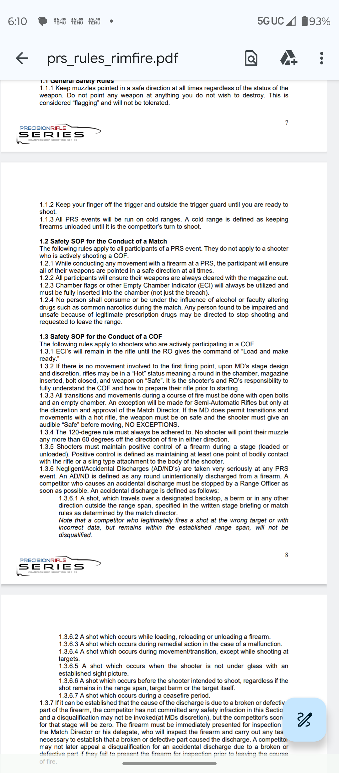

At our prs match the chamber flags need to go up into the bore
I shot many PRS matches last year including the regional and national finales, and I didn't get called on the fact my chamber flag does not actually enter the bore (Panthera). Neither at any NRL22 local or national match. The typical concern is damaging the o-ring. Pays to be prepared of course. But... better to ask forgiveness than permission on this one?
Reactions: Centercut
That is good with you can get away with it, our rso's just follow the rules. Hate to be dq'd over this
What chamber indicator are you using. I have a Panthera and can't find one. I would print one myself, but can't even find a stl file for one.
