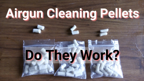

Airgun Cleaning Pellets video

Just as an experiment, try one again but push it through with a pushrod instead of shooting it. When I use them, I'll stack up 2-3 and then push them back and forth a few times. They come out showing mucho junko. The ones I use are also name brand (RWS?) and come in a plastic case. they're about 2/3 the length of the ones you had.
Great video! I can tell that you read all the directions on the B.S. meter! lol

Yeah I honestly think they just don't work on my rifles because of the super low power . I remember trying them.in my 22 Cricket and got different results . I think the little 6 ft lb type guns just don't create enough power to seal it right .
I had some Beeman brand ones also , they seemed a little denser .
Yep the BS meter worked like a Charm. Lol...It was a fun video to make
I was told by an "old" airgunner around home, (I'm 57 and he's in his late 30's) with more recent experience with PCPs to put a drop of cleaner on the front of 2 pellet cleaning pads and shoot them and wait a minute and then shoot a dry one. I'm somewhat sceptical about the idea and I think I'll just stick with my nice cleaning kit unless I see lots of other people confirm that. I would think the cleaner would be at risk of dieseling and you would be shooting a unique tracer round down range.
I honestly just use two bore snakes . One with some Hoppes on it , the other dry . Takes all of 30 seconds and I know its clean .
I'll put a drop or two of oil down the barrel every month or so and pull the dry snake thru just to give it a trace of rust protection.
Everybody has their own cleaning tips and techniques, for me on my guns the cleaning pellets do little or nothing . But your milage may vary :)

As for the felt cleaning pellets, I have used 'em although now I rely on bore snakes in .177 and .22 for my guns. On the rare occasions I do use the felt pellets I generally put a drop of airgun oil on the end of the pellet that goes into the breech first and then load a lead pellet directly behind the felt before firing. My experience is that a felt pellet alone, or two loaded together, does not provide enough back pressure to the air chamber to prevent the piston from slamming into the air port. Almost a dry-fire situation without a lead pellet in place. Using the felt pellet is almost like using a kitchen towel to do a quick wipe-up of a spill on the floor - gets the worst mess out of the way but not a thorough cleaning by any means.
I got some VFG felt cleaning pellets and a special jag that fits on a cleaning rod and screws into the pellets, swelling them to closely fit the bore (in my case a .22LR KIDD barrel) and used them just like I would patches. They work like a charm and don't leave ANY lint/strings anywhere. Found them and the jag at Champions. I only use them on .22LR barrels, but they might work great on airgun barrels in .22 also. I don't have any .22 airguns.
