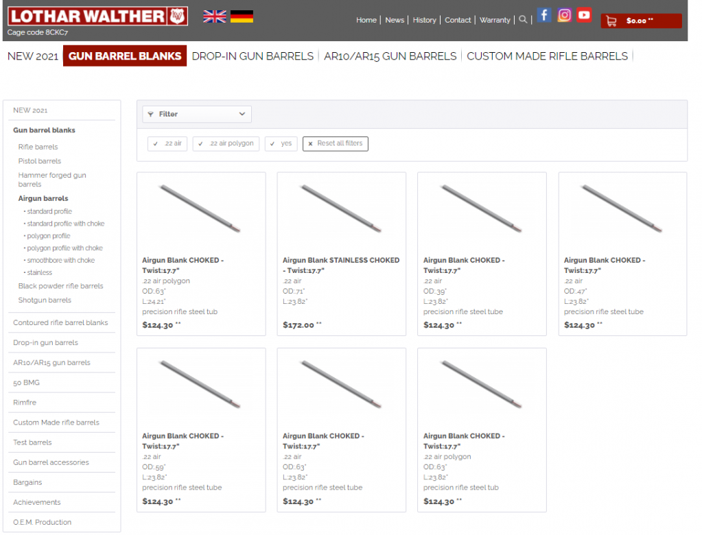

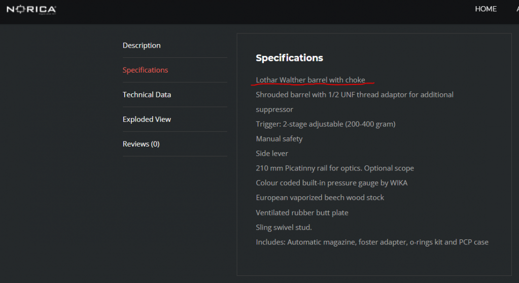

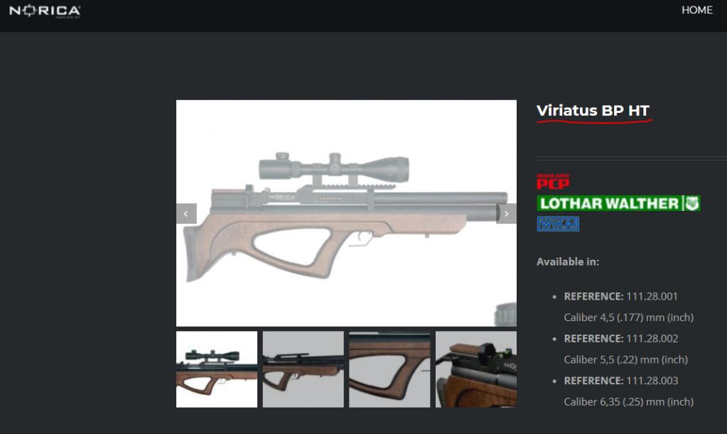

ok well I looked up gun you said , because I never heard of it , anyway your gun uses a LWQ barrel and twist rate is 1 in 17.7 here is specs
Technical Data
