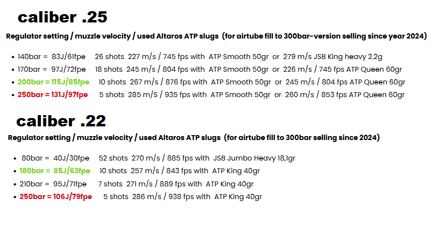

We would like to inform you that the current stock M24 rifles have already been delivered new elements in the
form of the possibility to fill the airtube up to 300bar and the possibility to set the output pressure from the
regulator up to the limit of 250bar
. Thanks to this, more power can be achieved and the shot count can be
increased.
The green field is the recommended output pressure in the form of a suitable ratio of power and air consumption,
as well as the pressure to which the rifle is primarily set from the factory.

It's simple. The mechanics of the weapon (airtube) is built for a high pressure of 300bar already in the base, but in general the seals degrade much faster at higher pressure, therefore the best conditions for the rifle are to fill the airtube, then shoot and then store the rifle ideally at a pressure of 10 bar lower than the output pressure from the regulator. This will extend the life of the seals and non-rubber parts of the regulator the most.

300 bar is the possibility of filling the airtube, not the output from the regulator, there is a limitation of 250 bar and as you write, 240 bar is more than a lot

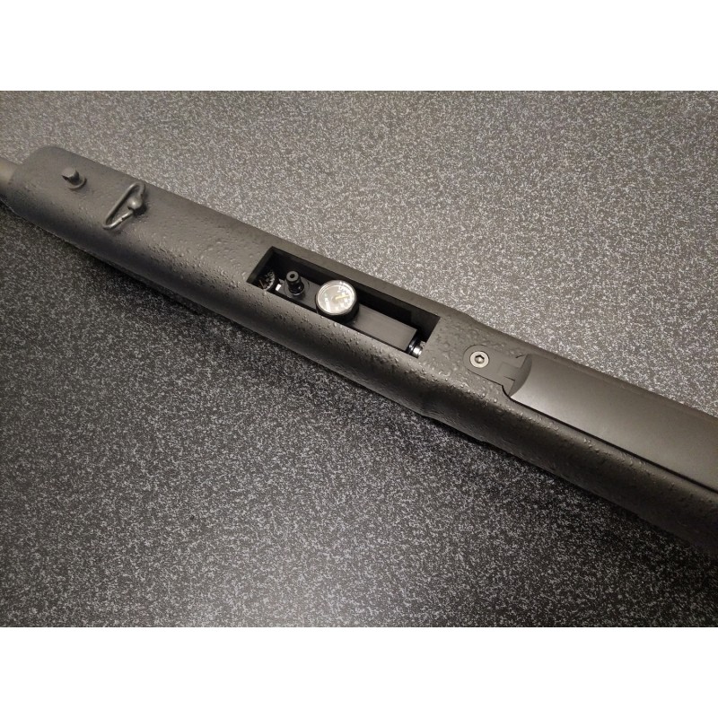

I talked to a guy who put a €1400 chassi on the M24. The chassi was for a 700 Remington but did not fit standard, there had to be the removal of material so that you could access the airgun components under the rifle. In the picture below you can see what I'm talking about. There are 2 manometers there and the fill probe. You need to cut out that square if you want to see the parts as designed or I guess 3 holes and some extenders could work but that would mean the manometers would stick out on the bottom so not ideal either.

I agree, especially with a ridiculous shoots count of 5 (FIVE!) rounds @Max power. And it's not even the most powerful gun on the planet, so...
