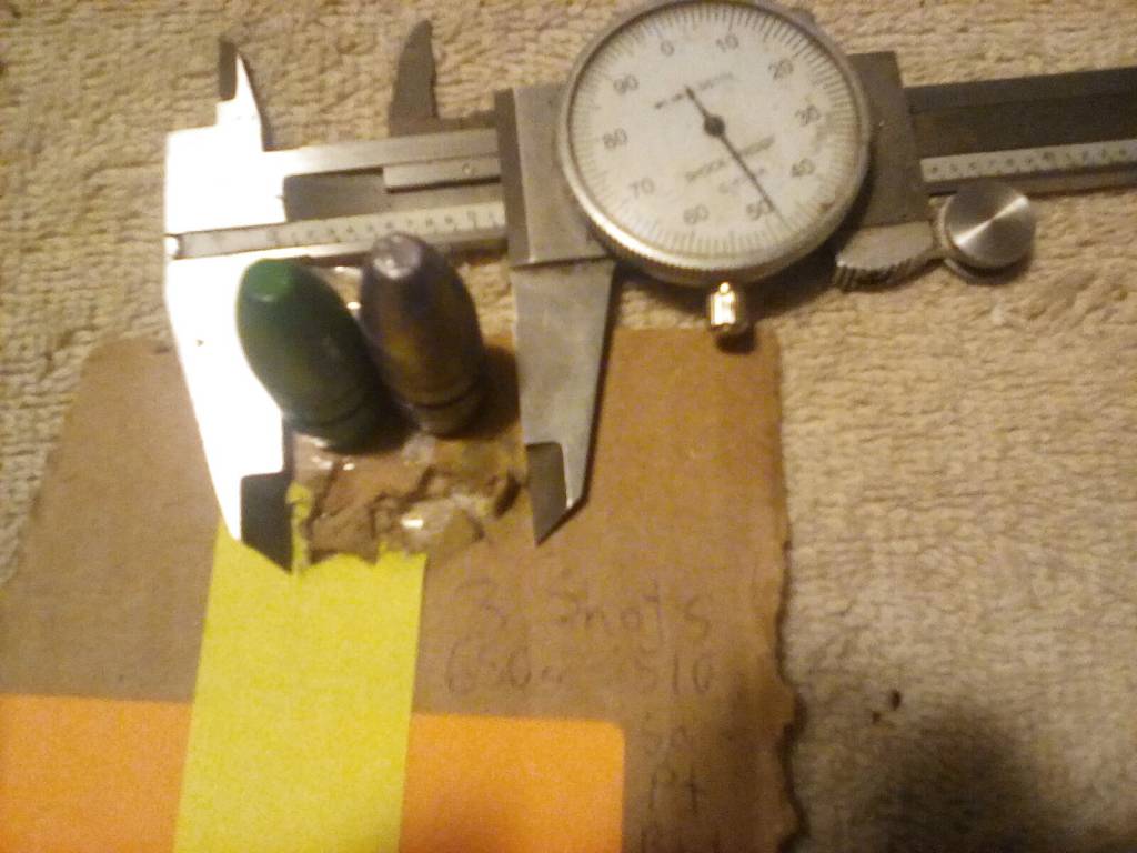

To.answers you bad trajectory at100 yards. My .510 Texan with its rough bore pain in the butt 1-26 will shoot 650 grain spire point boat tails at 750 fps into perfectly round holes at 125 yards. Here is a example of that
I'm not bragging on my lother Walter Texan barrel it will produce 3 to 5 accurate shots from a spotless perfect ly cleaned bore
