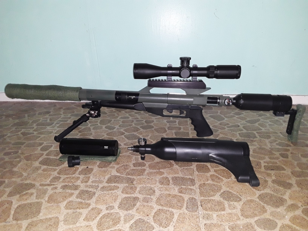

Here's a picture of how I have it set up, I use a 10" Neil Clague moderator to keep it backyard friendly, stock bottle good for 74fpe depending on slug weight.
500cc bottle has a Doug Noble .25/.257 valve in it, which ultimately will end up in a .257 AirForce build, but zI use it to push the 55.5gr's to 104fpe+ on only 3000psi.
