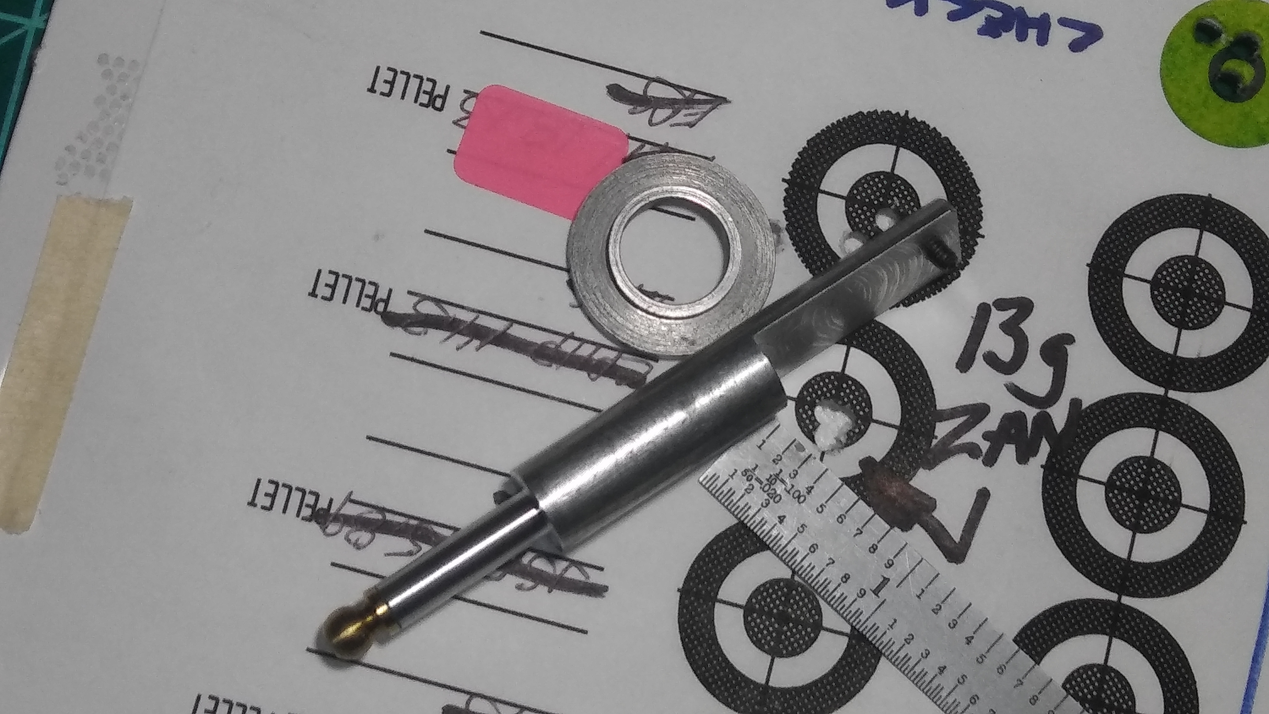

Made up a little tool to seat the slugs
into the breach unti I could feel some resistance. First up were the Zan 13 grainers. They shot a whole lot better when seated 1/8" deep. Still not as good as pellets. Thats 5 shots 18 yards and my seating tool. I was real low on air so only 800 fps.
