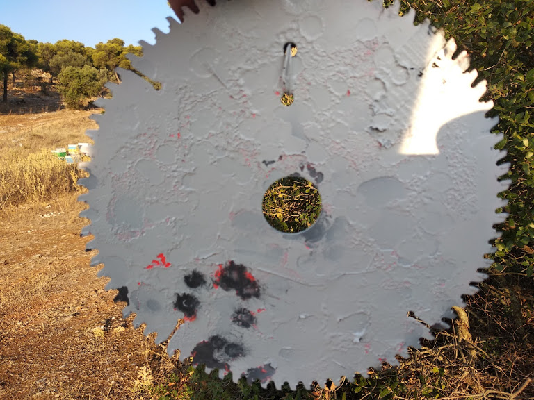

This is a 10 shots group at 118 meters
Paint ball reg, Uadapter, plenum 55 cc, 41 fpe, H&N slugs 25 gr, 5.5 cal

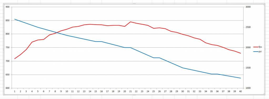

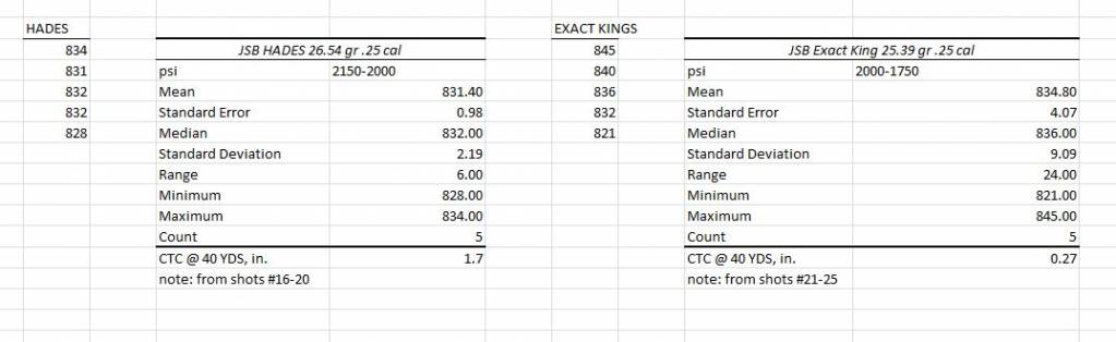

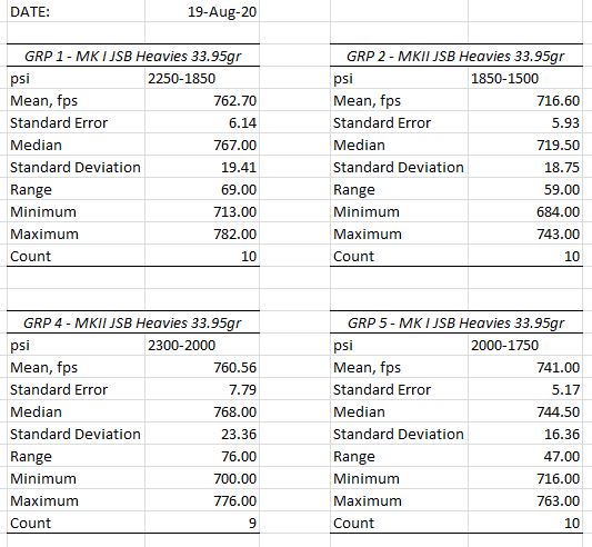

Hello --
Am considering adding an Altaros reg to my AF TalonP, for similar reasons as mentioned above -- fills to 3000 psi. Presently this gun runs okay with heavy brass 88 gram TT hammer, 0.166" transfer port, thin o-ring under tophat and power wheel at 2/2. Shooting pressure is a hard 2250-1500 with JSB Hades 26.54gr and Exact King 25.4s. With Benjamin Domes at 27.8 gr I see predictable pellet drop at ~1750 psi. I too get many flyers until gun is shot down to <=~2300 psi. These are all read off the stock AF manometer, which reads 100 psi over under my handpump. Have some JSB Heavy originals and MKIIs arriving mail today and going try those. Below attached is where I am at now. From what I have read these AF utility guns tune similarly.
All the best -- Mark
