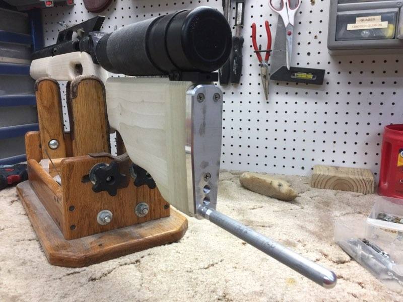

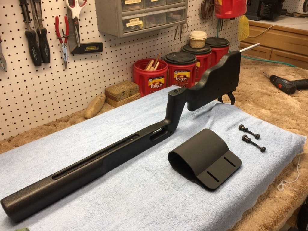

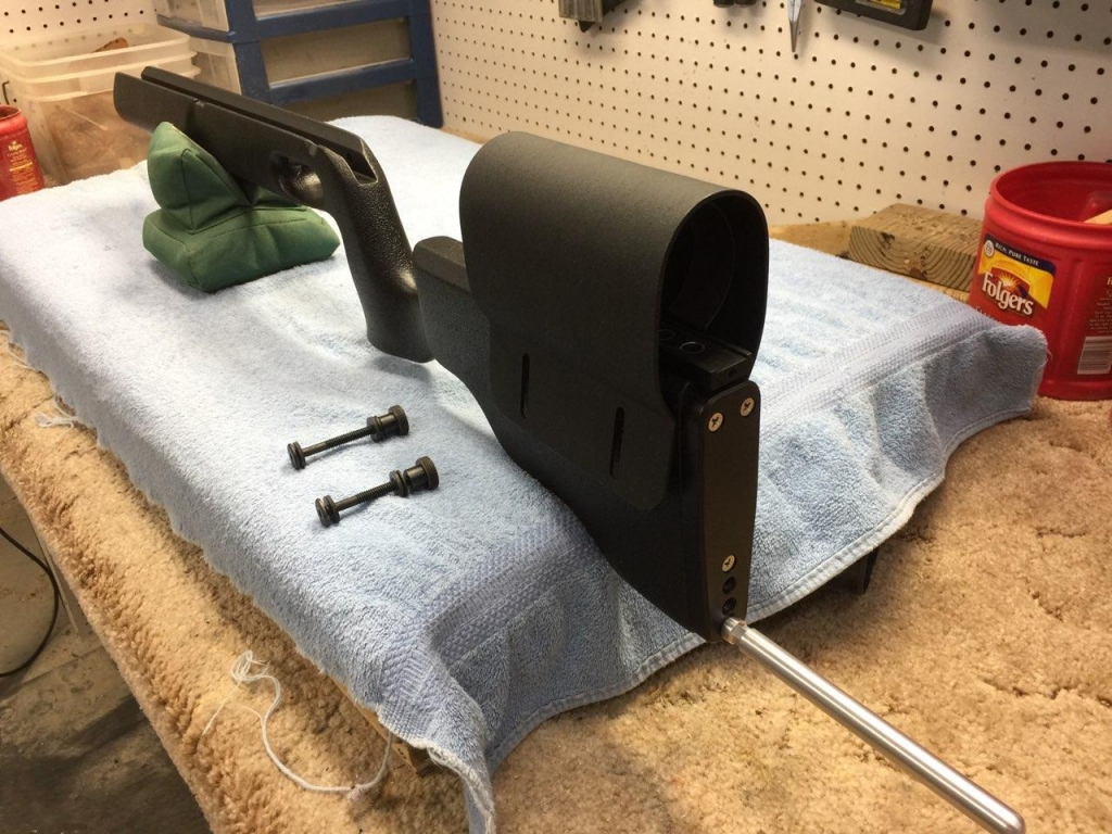

I'm having a custom made Field Target gun created by Tony from Talon Tunes, and it will be a 12 ft lb rig, based on a Talon SS frame. I had Doug Russell, of Mad Dog Stocks make an amazing Field Target stock with a full rail to attach goodies. He also put a simple stud, that can be adjusted for height, on the rear of the stock as a butt hook. Tony is working on fitting a regulator to the rig, and then he still has to fit it to the stock.

You are correct when you stated that the Air Force platform is normally not a good choice for Field Target, and that is correct. Knowing this, I've seen some of the most accurate .177 's at my home range be Air Force guns. Chris Turek now has the official long range shot with an airgun of .177 caliber, and he did it with a Mad Dog stock. The Field Target rig that I'm having made will have the beefed up frame of the Texan. The trigger group is being specially honed, and the bedding and attachment of the Mad Dog stock, will prevent all flex and possible damage to the platform. Somehow, he is installing an Alteros regulator in it. Unless you go to the extremes that I have, out of the box, it is not the best Field Target rig.
Here are some pictures of the Mad Dog stock by Doug Russell.....
Hope this helps you in your choice, as I said, it's a super accurate rig, but most people will not go to the extremes that I have in order to make it bulletproof.
