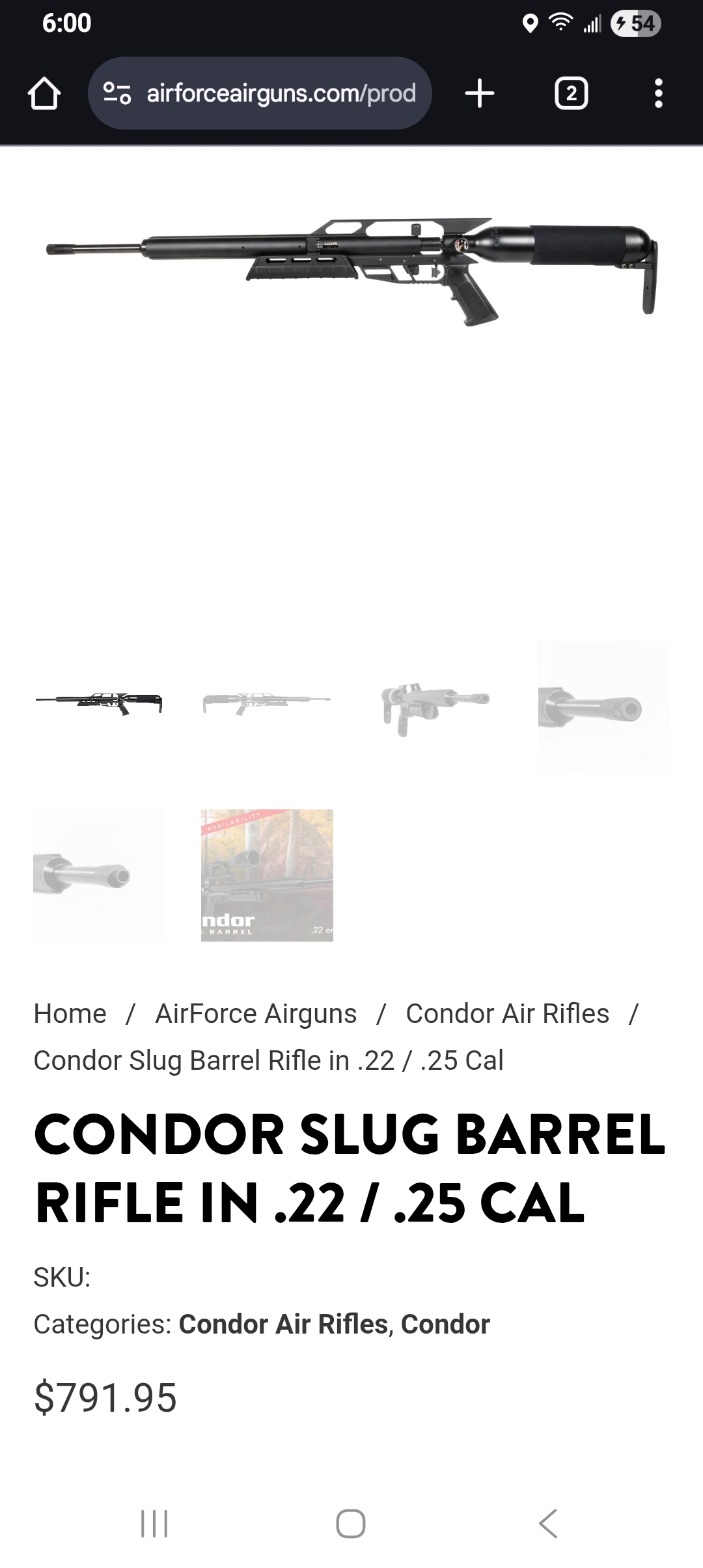

Airforce Airforce Condor .25 cal newbie
I am planning on buying an Airforce Condor .25 cal in the next two weeks and this will be my first Airforce PCP ever. I have been into PCP'S for around 5 years now and have a decent understanding of them. However, Airforce Airguns are foreign to me. I really enjoy modifying airguns and learning new things. I have a basic understanding of some of the things that can be done but I would really appreciate any advice for someone in my position. Anything from little hacks, modifications, things to avoid and maintenance.

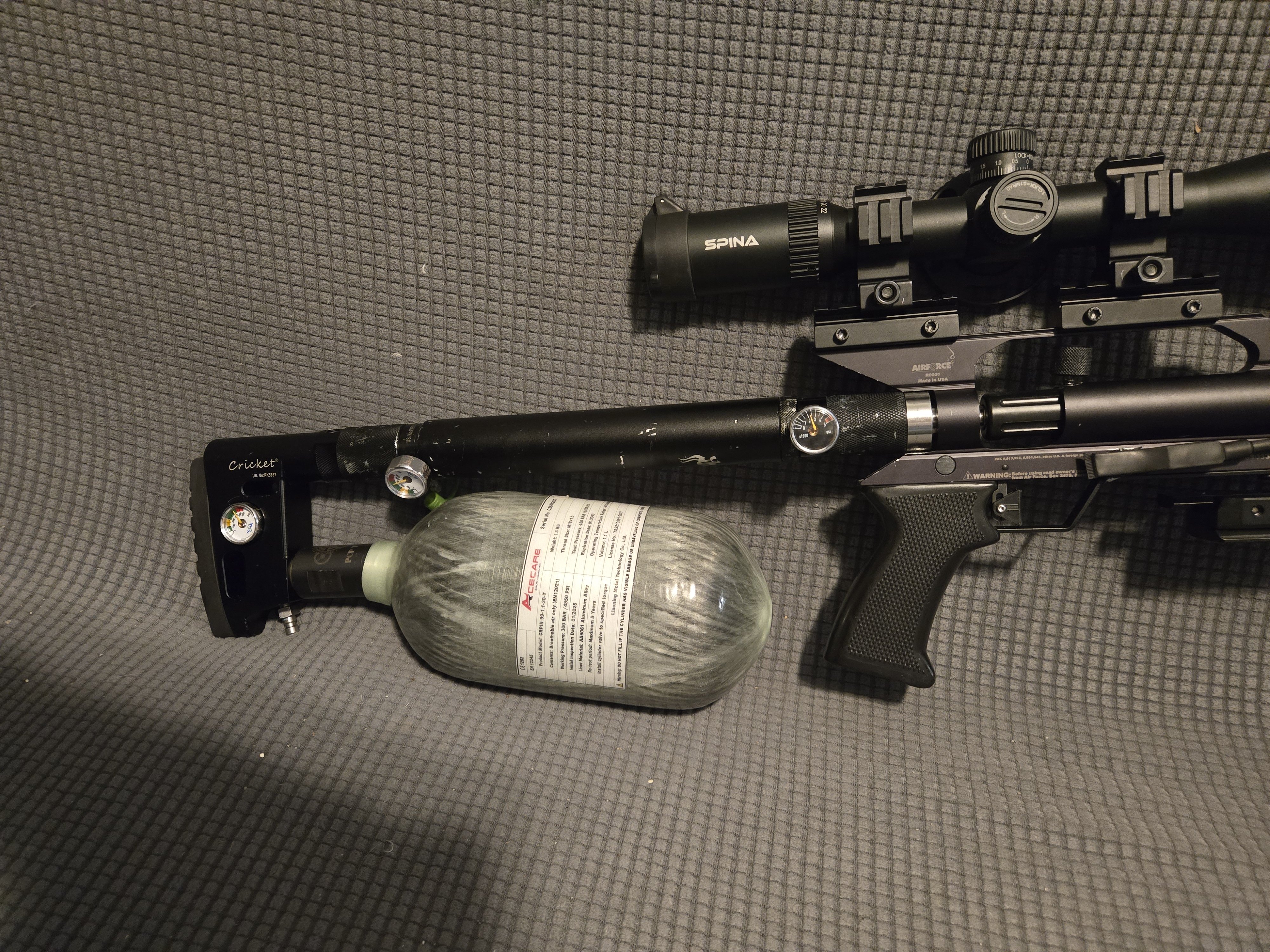

Huben Power regulators are highly recommended. The MAX-ATH and MAX-TOPHAT have 50cc plenum. If you buy the Tophat you do not need the valve upgrade.
I dont know if the OEM valve are still threadlocked to the bottle. If they are then you will need a new bottle to go with a regulator.
Tons of variations
120 CC Shan Bao 3000psi plenum (AliExpress)
Huben Power U-valve
Regulator 1/2 Huben Power Cricket
Acecare 1.1L Fat CF bottle (AliExpress)
Trajectron Hammer, Spring and angled adapter
Turn the reg pressure up: 1100fps H&N Baracuda Match 21.14gr
Turn the reg down, hundreds of shots aT 850FPS
Huben Power Condor Z-valve
Acecare 1.1L fat bottle
Huben Power Max-ATH
AliExpress high flow valve
Trajectron angled adapter

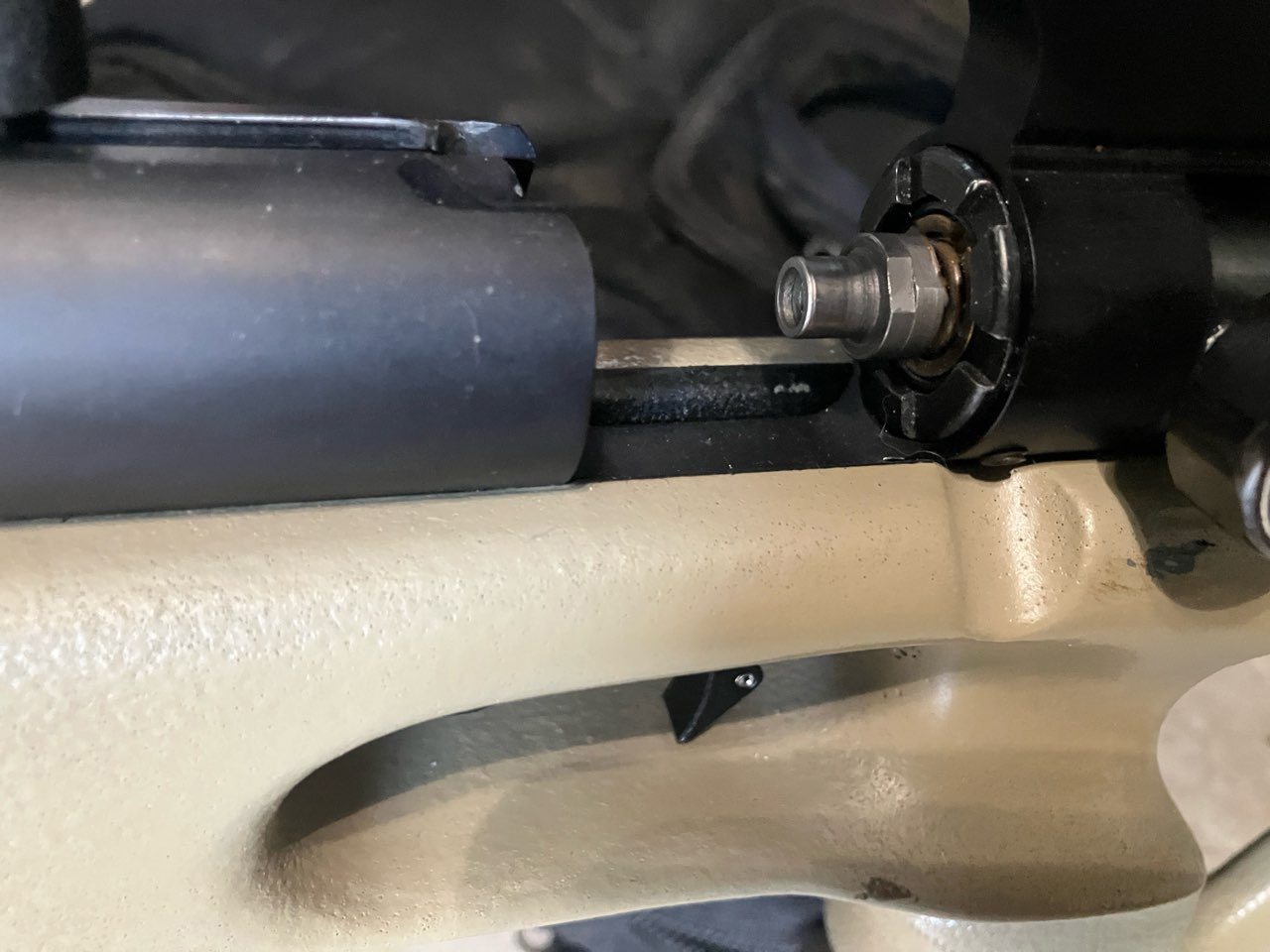

HI Pete,
I do have a Talon Tunes moderator on mine, and it works quite well, but it will not work on the Condore pictured in your opening post. The Talon Tunes moderator replaces the end cap on the shroud of guns where the barrel is shorter.
There are no threads to attach directly to the barrel.
as for the top hat, that is the part on the end of the valve that engages with the breech. The two piece top hat has different size orifices available to fine tune the volume of air from the valve.
Many put an Oring behind the top hat. If you look closely you can see the brown O ring that I used on mine. So the way Airforce guns work is that the hammer is in front of the breech. When the trigger is pulled the hammer strikes the breech and th breech then transfers that energy to the top hat opening the valve. The O ring slightly liimits the travel of the valve stem and also aids in rebounding the valve to close it. Basicall shortens the dwell depending on the O ring used. I used fuel crossover O rings from Old Cummins diesel engines. They worked out perfectly for me.

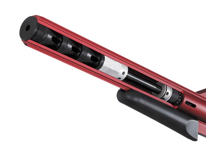

Alright, definitely makes more sense to me now. The barrels have no ports and the pressurized air takes a straight shot from the top hat to the breach. Changing the size of the tophat is similar to enlarging the port on other PCP'S. I know that the talon tunes moderator won't work on the Condor I'm considering buying. I was just curious as to what the internals were like and how well it works compared to other typical suppressors or perhaps the ss versions airforce offers. I'm not dead set on that particular condor. I'm interested in it because of the slug barrel and because the end is threaded. I would prefer not to have a gun as long as one from the civil war, however I do plan on shooting it from a bench or my tripod. I have been trying to find videos or images online of the internals of the ss condors just so I can get an idea of how it works and same with the talon tunes one you have.
I have never actually had my Talon Tunes moderator apart, but it is pretty effective. My Talon P is a bit louder than than my RTI Prophet, but the Airforce gun is quite a bit louder unsupressed than the RTI in the same state. They are both .25 cal also.
For the RTI I have two supressors. A 0DB that I use when I have my .22 LR barrel installed, and Carbon Fiber RTI Hush moderator that I use with the .25. They both do about the same job in taming the bark.

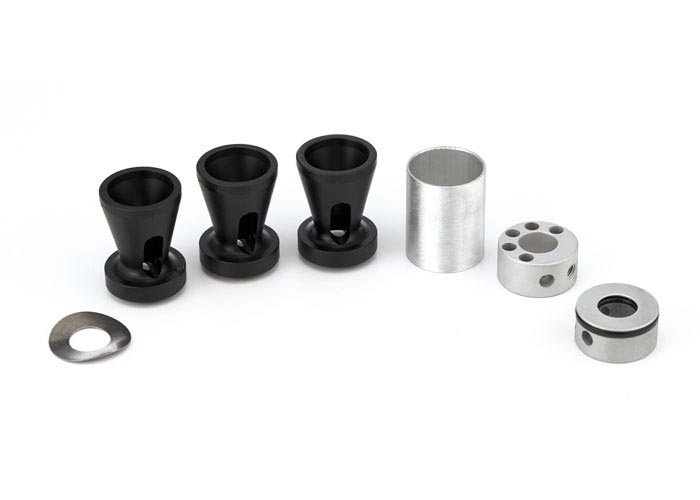

Here are som pictures I found of the baffels Airforce uses
Here are som pictures I found of the baffels Airforce uses View attachment 588145View attachment 588146
Nice, thank you for the pics! I have both of the RTI Hush suppressors, in my opinion usually moderators that have a higher volume do better for sound reduction. However the quietest one I have is the STO Sarissa. I highly recommend those things. I have the smaller Donny FL modular on i think its the Ryu, the impulse 1350, some of the wolf k baffle ones and some others as well but STO does a good job. They also have selections for low, med and high air flow internals.

That model comes with almost every thing, the only thing that is needed is the 260mm dovetail to picatinny adapter for the scope .. from ebay.. a shorter picatinny adapter for the bipod, ebay even have the BKL aviable for like $30 .. a wider grip, factory is to small for me . Luthar make a great inexpensive grip $25 ... power wise that gun should shoot 55gr in the 900+ fps , if not and is something you want or need .. then order the factory talon p valve , and buy the Trajectron adapter for m18x1.5 for the talon p valve.. Trajectron has no valve more powerful than the factory talon p valve..And order a one pice hammer to eliminate the second steel factory weight, either 70gram but no more than 85gram with the factory spring no need to upgrade thr spring unless you’re planning to shoot 65gr altaros.. the top hat is the only weaker point in the factory AF valve if they are going to be hammered hard with a heavy hammer, but that is a easy fix with the TT one pice top hat.
