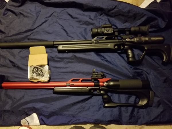

I have a Condor .25, Maddog Ultima stock, carbon fiber bottle and aftermarket tophat (TalonTunes) that's wide open. I just got an order of 400 52gr boat tail hollow point slugs from NSA (you can email nick and he'll help you choose the best ammo for your set-up based on feedback he's gotten from customers with similar platforms) and they shoot very well. Mine is a night vision, pest rig that i have sighted out to 70-75 yrds that gives me 1 inch groupings easy with the aforementioned slugs.
I understand your question references a stock platform, so i can also tell you these same slugs perform great out of my .25 Condor ss out to 40-50 yrds sighted with a cheap red-dot.
