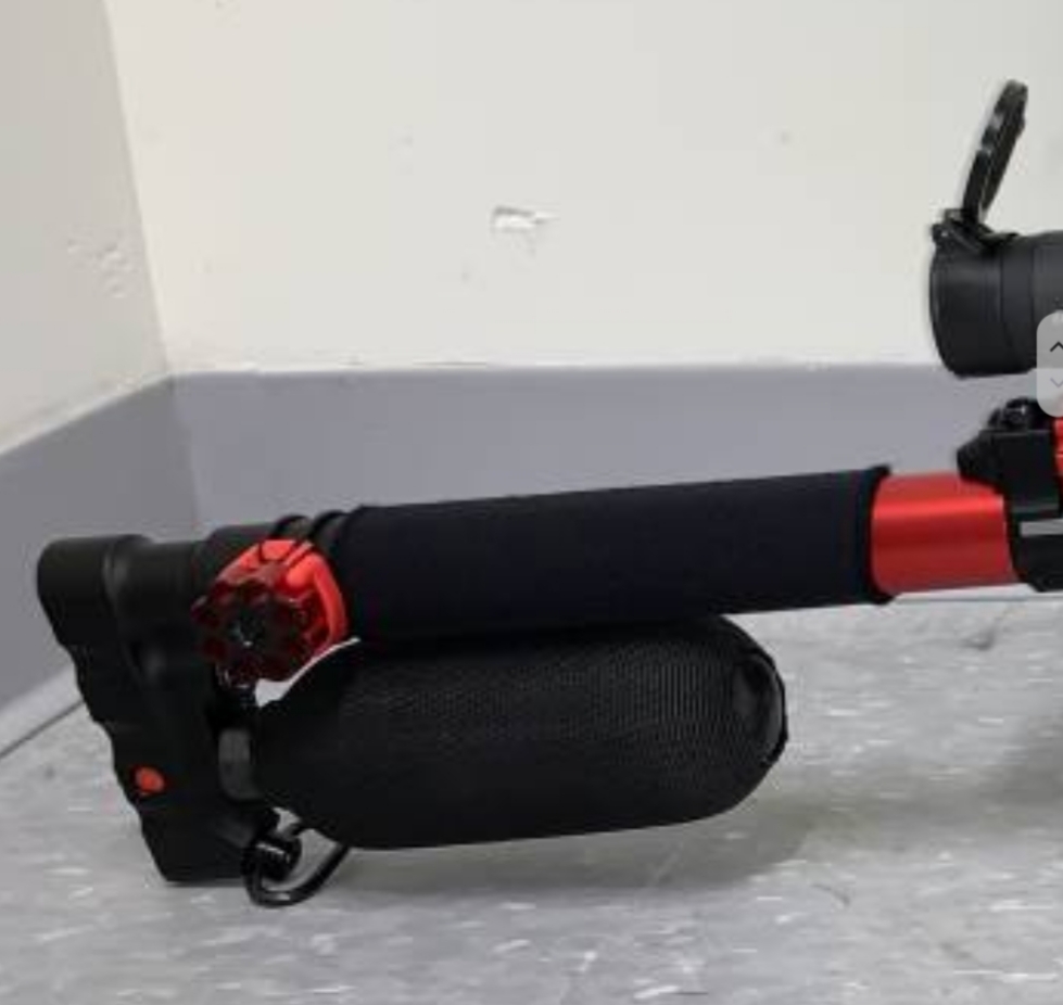

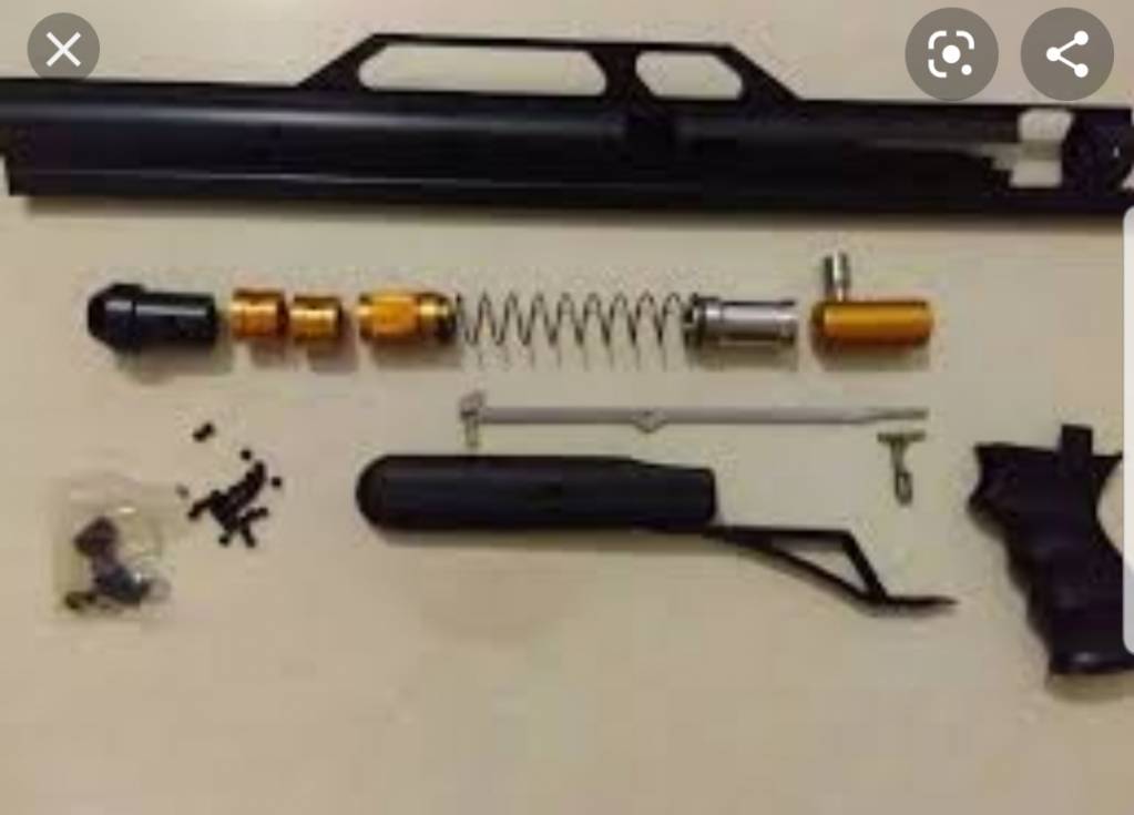

I don't mind about being single shot if is a HP regulated shooter and it could be done the same way it was done in the leshy 2 it could even have a adjustable reg and a big plenum.. this is the only way it could be done without change the length of pull .. this is not new this is not a edgun invention..I saw this configuration on a airforce bullpub kit a few years ago..so I dont se why airforce could not use it.
