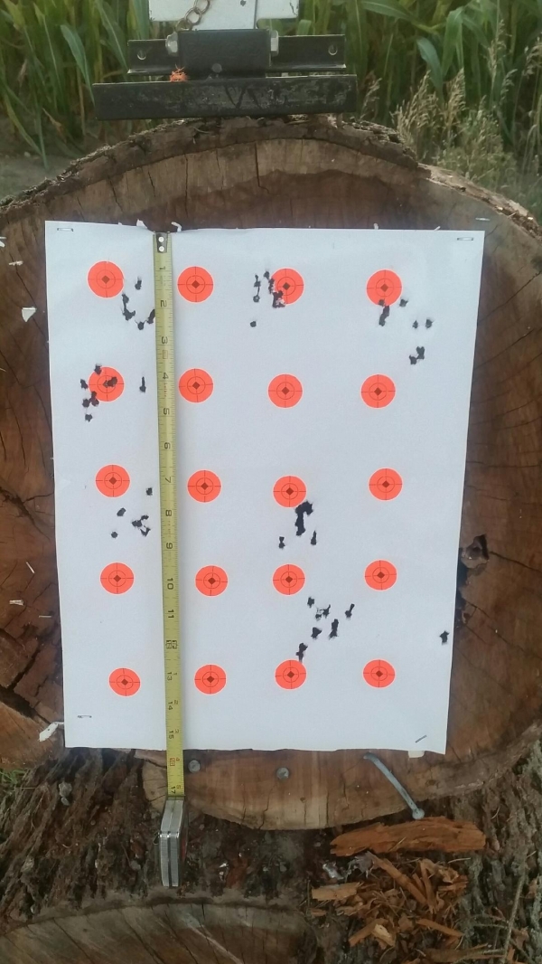

The smallest 10 shot groups I can get is 1.25 inches at only 40 yards. A decent amount of my groups are more like 1.5 inches. I'm shooting 18.13gr JSB Jumbo Heavy in the low 1100s FPS and it's on the lowest power setting. I've been filling it up to 2600 psi then taking 10 shots then topping it off again. What can I do to make this thing shoot better?

I don't own a Condor but is yours new? Or did it all of a sudden start grouping/not grouping like that,is the breach ok, did you take the barrel off? have you tied any other pellets,almost looks like the pellets are clipping the shroud or Crown of the barrel but something ain't right by the way it's tearing the paper.

It is not new I've had it for a couple years but I'm just now seriously trying to figure it out. In the past I never shot it much (only the occasional 5 shot group) so I wouldn't know if has changed. I always thought it was better than this though, sadly I didn't write anything down. I have never taken the barrel off. I think the breach is ok, nothing seems wrong with it. I've tried H&N Barracuda and Barracuda match pellets, Eujins, and JSB jumbo monsters, but the 18gr JSBs have shot the best. One really weird thing happened to me today though. I left it cocked in the rest and had to go do something and came back to finish my group and when I shot it only sounded like a little "tink" and the bullet was so slow I could see it's whole flight path and it hit very low. I tested this again and it only seems to happen when I leave the gun cocked for a while then shoot it. This worries me but it shoots normally when I take the shot quickly after loading the pellet.

definitely more things are going on because it is seems what you got is not only about wondering POI, that gun currently is unable to group even for a few shots.

"ebigham1"Check to see if its hitting the end cap or the baffles.
That's what the target looks like it's doing. IMHO..
