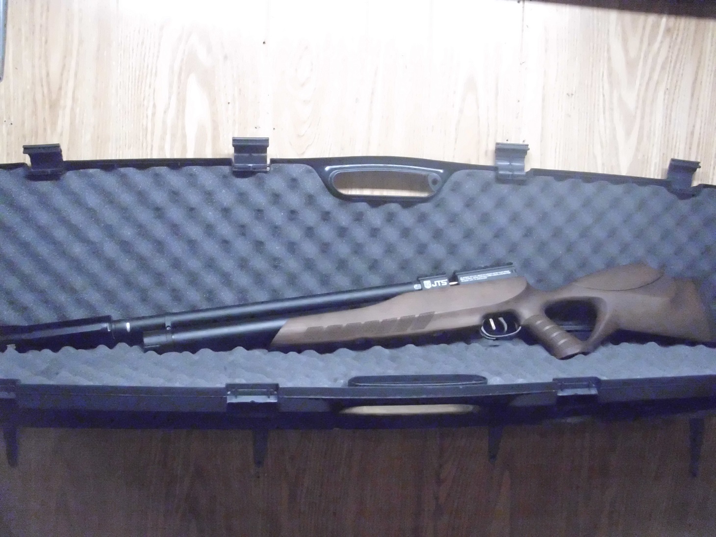

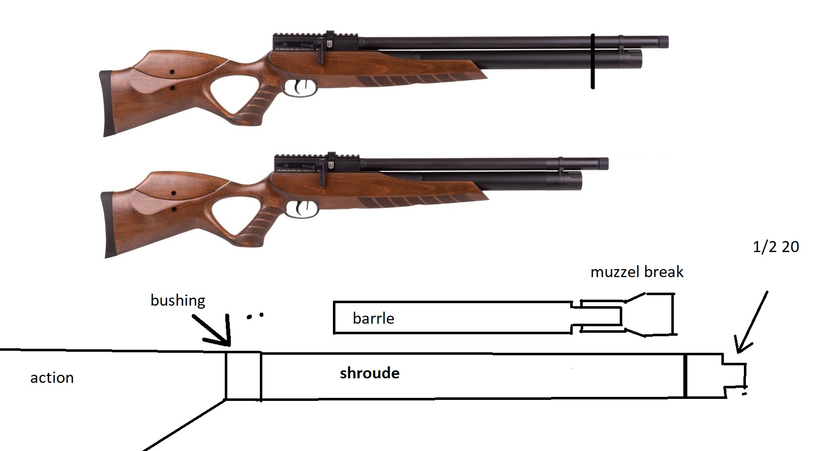

took 4 inchs off main air tube took out baffles but used muzzel break factory took 3.5 off shroude
thanks all i did on this one was took the factory baffles out took off 3.5 inchs from shroude its still got factory muzzel dreak on in side left barrle alone barrle still stock length i did not wount to re crown or cut down barrle then i had a machine shop guy re do the air tube took off 4 inchs of it i not shot it yet since the cut down but before with sumo and factory baffles mouse fart quiet
