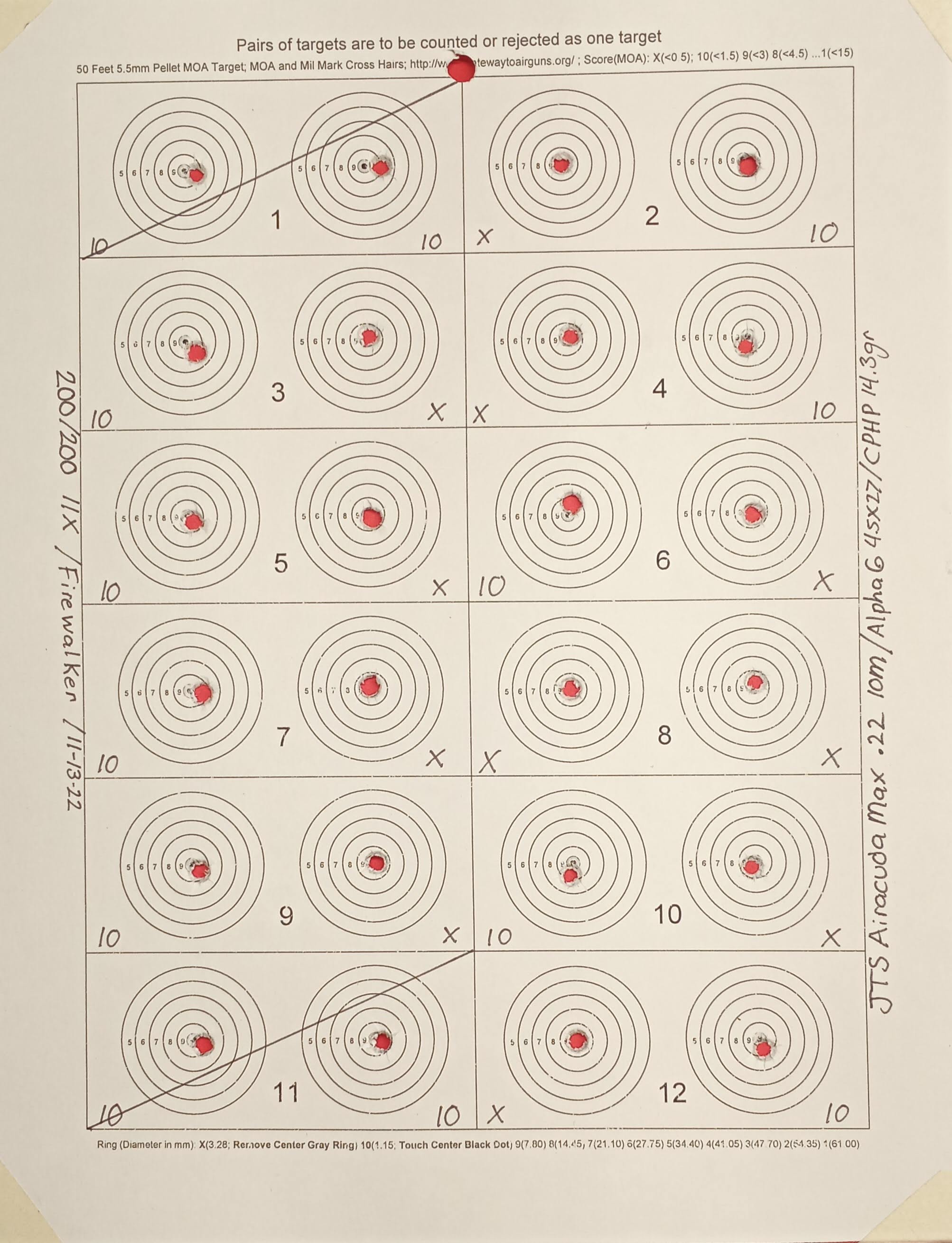

I just had awful luck with the Airacuda at 30m, barrel clamp on, barrel clamp off, changed scopes, changed ammo and air charges. The POI changed with every shot no matter what I did. I decided to bring it inside for the 10m range and ended up getting a very nice card, Im submitting it over at the GTA casual 10y match.
On to the others : I got a few good targets at 100Y and the FC did just fine at 30m.
FYI, 10m, indoors, .22 Airacuda, .22, 850 FPS, CPHP's, 13.9gr
