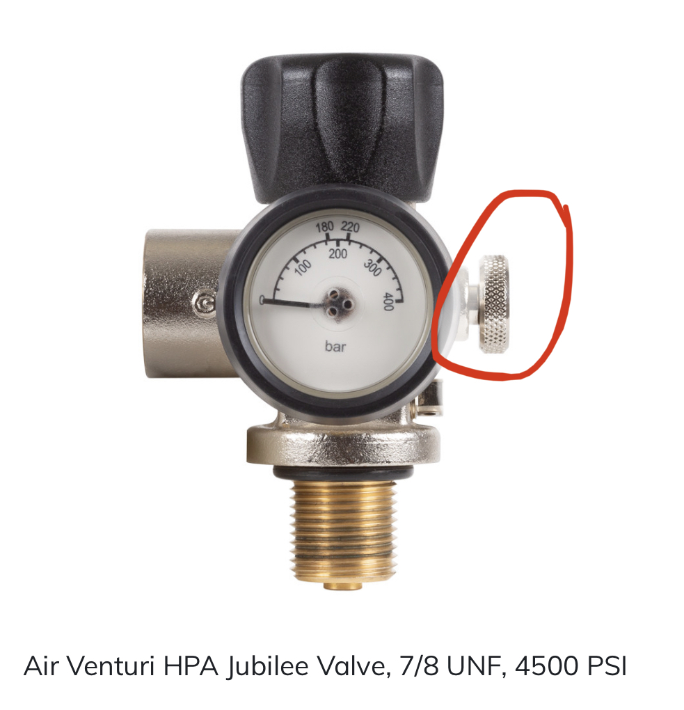

Air Venturi Tank Noise 74cubic ft
Did you open the valve on the tank all the way? You may be restricting the flow some!
This may be what's happening. I remember when filling my tank with the yong heng, pressure would shoot up almost instantly. After a min or two I realized that my tank was open but not fully. I opened it all the way and it went to normal and no more noise or instant pressure spikes.
Thanks guys tried again made sure valve was all the way open and it still doing it. It doesnt start making the sound until I open the valve
@lose_money That doesn’t sound normal. Have you checked to be sure that your bleed valve is securely closed? If it leaks from here there is a good chance that you can feel the air escaping with your hand.
