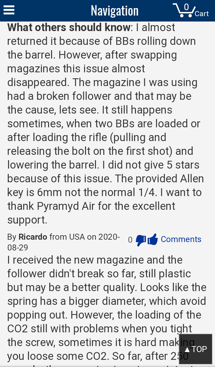

Thanks Odoyle, I didn't have a double BB so far, the thing is you can't lower the barrel when it is loaded. By the way, those reviews are mine, from Pyramyd Air.
The new magazine received a couple of days ago, now after cleaning and lubricating the threads and also putting and taking the screw many times, it is so far performing well and I get 4 magazines of 14 rounds per CO2. But, the issue of BBs rolling out the barrel still on. You have to keep the rifle horizontally or pointing up.
