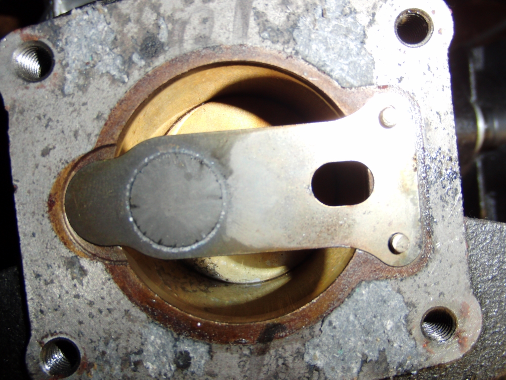

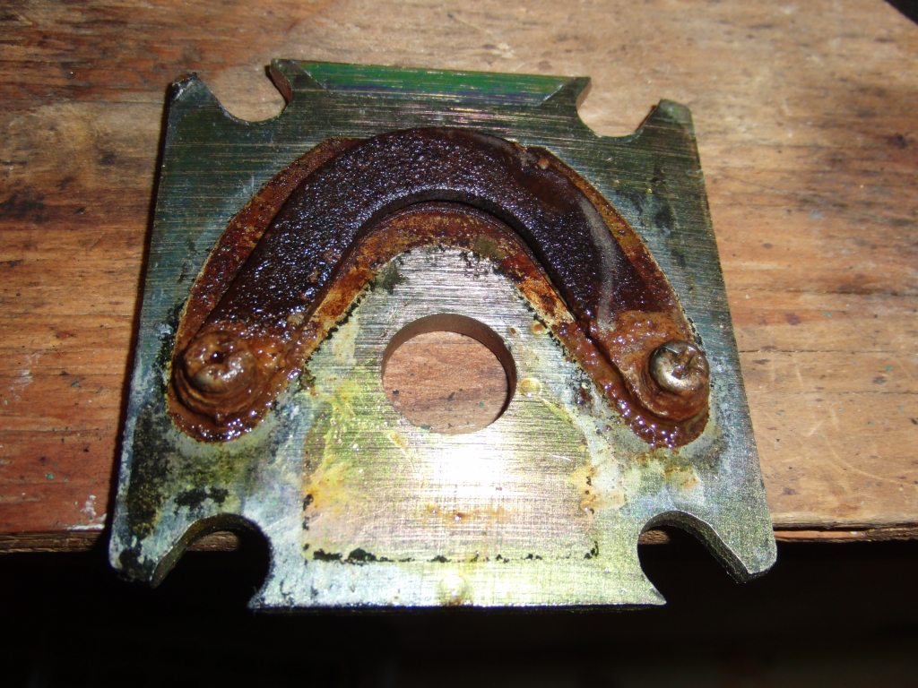

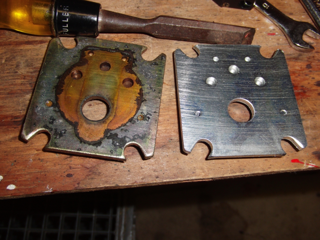

After all the BS I went thru with my just out of warranty AV- I finally got new one- Much praise to PA for making it right-Long story short- lost pressure after 5 hrs. runtime in 1 yr.-Tried many fixes( had broken valve plate(replaced) rusted valve plate on low side(replaced) still could not build full pressure- contacted PA- They agreed to replace- sent me a Nomad by mistake( ready to rip my teeth out at this point- but already have dentures) but after many e-mails received correct unit today. Love my last return e-mail-----

Other weak spots( the 2 valve plates on Hi-side & the 1 big one on low side Heat & moisture- need some way to dry filter intake air other than black screw on cap.
