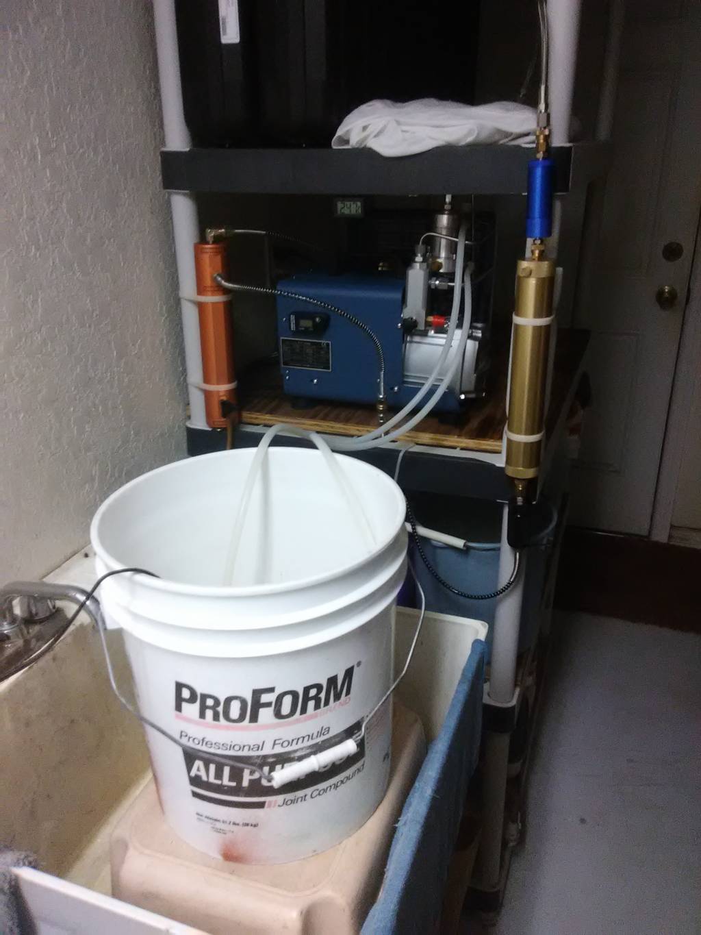

Here's my Set Pressure Model set up in my Florida garage. Many folks use additional filters and water separators to assure only the driest, cleanest air goes into their airguns. My garage is very humid in the summer so I've really had to "filter up." The small, black metal filter, just under long gold one will come with your Yong Heng and uses a cotton "tampon-style" filter (extras included with Yong Heng.) Don't be too concerned about your set-up, I, and many others, will be glad to answer questions. WM

Here's an old pic of mine set-up for operation. The 10" blue box fan is on the far side, here, I now use it behind the Yong Heng, as shown in other pic. The white blanket on top shelf is for my gun, as it should be above everything to make it harder for moisture to reach. Water level of pump cooling water is best even with Yong Heng to make water pump's life easier. Again, not to worry, many here willing to help. WM
