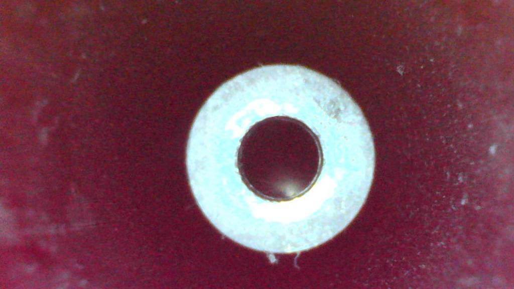

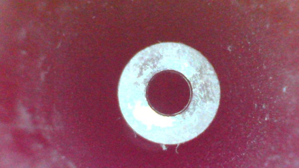

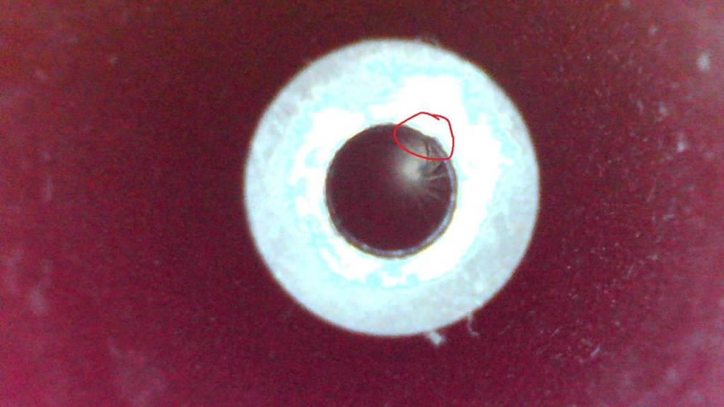

How many shots between pellet swaps? Always nice to clean then re-season for each evaluation especially as the old koreans (different now) tended to be both over size -more leading- and very dirty. The 16.20 might be a good choice for a heavy pellet.
Also no shortage of other possibilities. How's the crown? Pellet shaving chambering?
John
Here are some pictures of the crown. Used an old cheap endoscope I have. Not the highest quality but I think it does the job.
I have cleaned the barrel a few times using my old 17 cal firearm cleaning kit. (i use to be an avid shooter before i had ear problems). But I haven't been swabbing it after every ammo change. I didn't see any changes in accuracy after cleanings. Probably haven't shot it enough.
Not the best crown job i would say. But i have no idea how big of an impact this has.

My suggestion would be to physically push a pellet through your barrel and see how it feels. I use a Dewey 177 coated ball bearing cleaning rod to push pellets through the barrel. You'll have to remove the barrel to do this, but you can diagnose a lot of things by looking through the barrel and pushing a projectile through it.
You also may have loose barrel screws, or too tight of barrel screws making impressions in the barrels Id.
If all things look okay, but the barrel is a little rough it can be lapped and smoothed out.

I did the brass screw crowing technique, and I’m pretty impressed. It’s way better than it was an looks like an actual crown. I think I have done so much stuff that it requires another range trip to see if it did anything.
