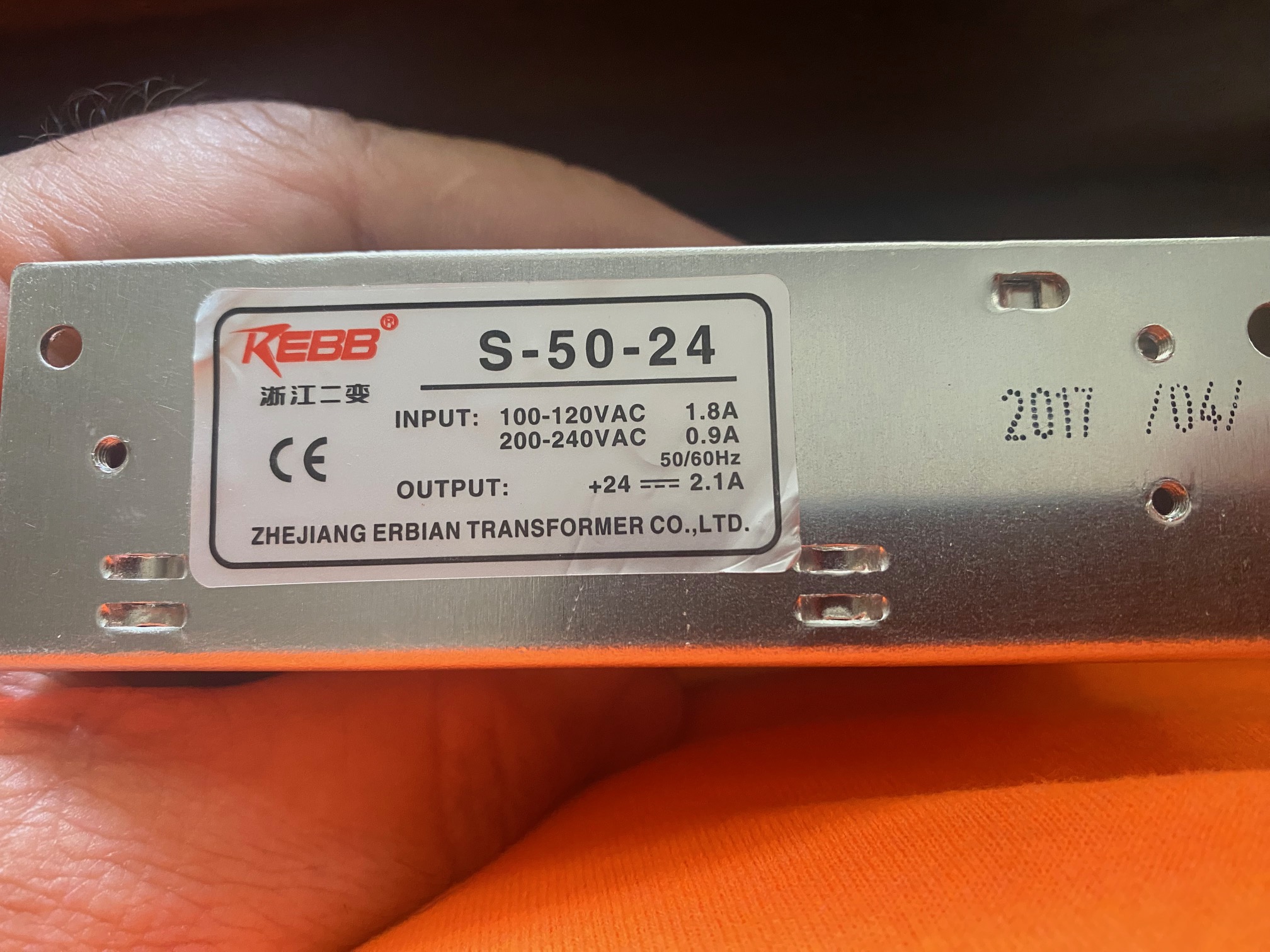

Does anyone know of a suitable transformer replacement for stock one in the Venturi Compressor?
Mine finally bit the dust after about 10 years for faithful performance.

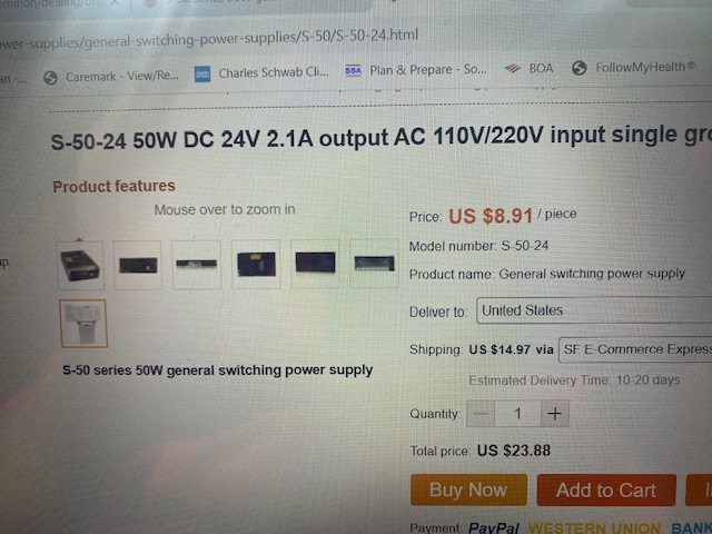

Nonetheless, I started searching the web for the REBB S - 50 - 24.
Finally found some site in Lord only knows where that had the exact same looking transformer with the exact same specs as on the stock transformer and ordered one.

I cancelled my order from China and bought the one from Amazon Rod.
Got it yesterday and hooked everything up and the compressor is working fine now.
I did speak with Air Venturi and they said any S - 50 - 24 transformer will work - Simple, 110v in and 24v out.
Just a heads up for anyone buying the one listed above:
It's a LOT longer than the stock transformer and you won't be able to get it into the electrical housing compartment.
So be sure to check the measurements before you order one.
I have mine rigged up on top of the unit and safely insulated so I'm good to go.
