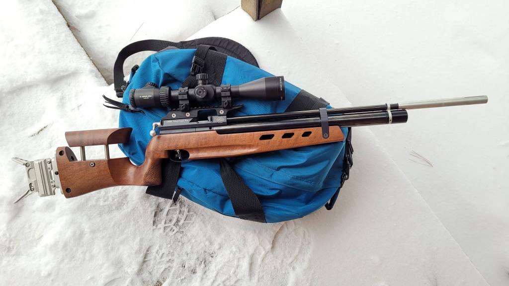

I picked up a very nice used Air Arms s400 MPR recently. It's a beautiful rifle!

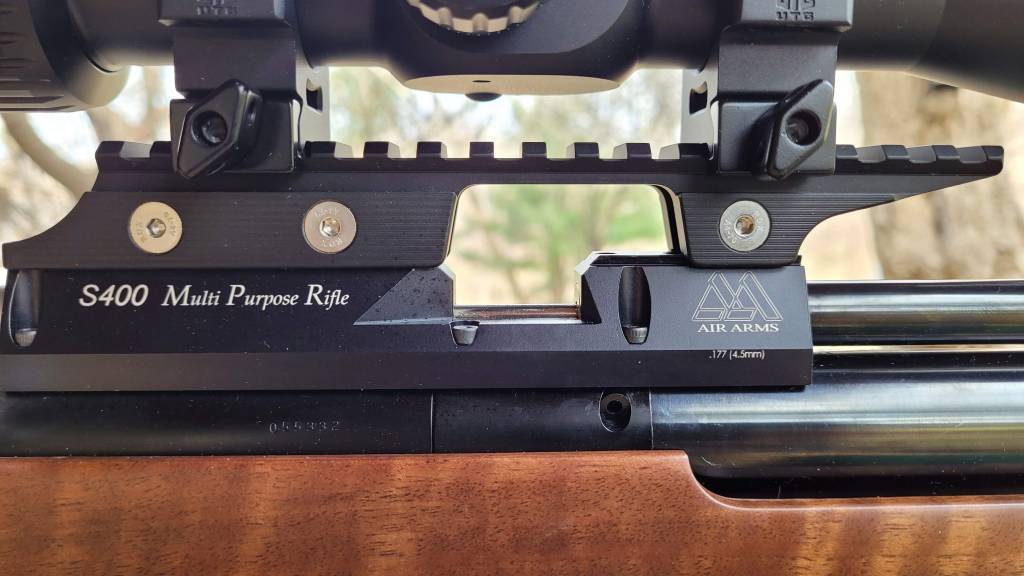

Wanting to know more about it's history, I emailed Air Arms with the SN and got these details back from them:
Serial No Model Details Manufactured
055xxx MPR SPORTER .177 5.1 FTLB WALNUT RH RUBBER BUTT 07.09.2005
At some point in its history, this rifle has been updated with the butt hook, a longer (and regulated) air tube and has been tuned for more power. In my cold (20f) temperatures it's shooting just under 13 fpe. So it's making a good deal more power than the 5.1 fpe it originally was designed for.
UPDATE: I just did a quick test over the chrony where the rifle was normal temperature (not 20f) and it is shooting the .177 CPHP 7.9 grain pellets at 887 fps so that's just under 14 fpe.

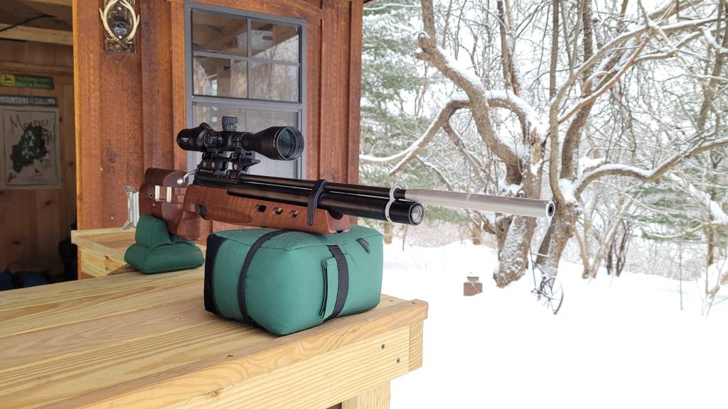

I'm still learning the gun so I don't want to prejudge the accuracy, but as I shoot it (with and without the muzzle brake in the pics) the gun seems (sounds) like it's pushing too much air for the power it is producing. So this is where I am wondering if this gun would be a good candidate for a Rowan Air Stripper.
Does anyone have experiences they could share regarding using one?
Here are a few more pics just because... ;-)

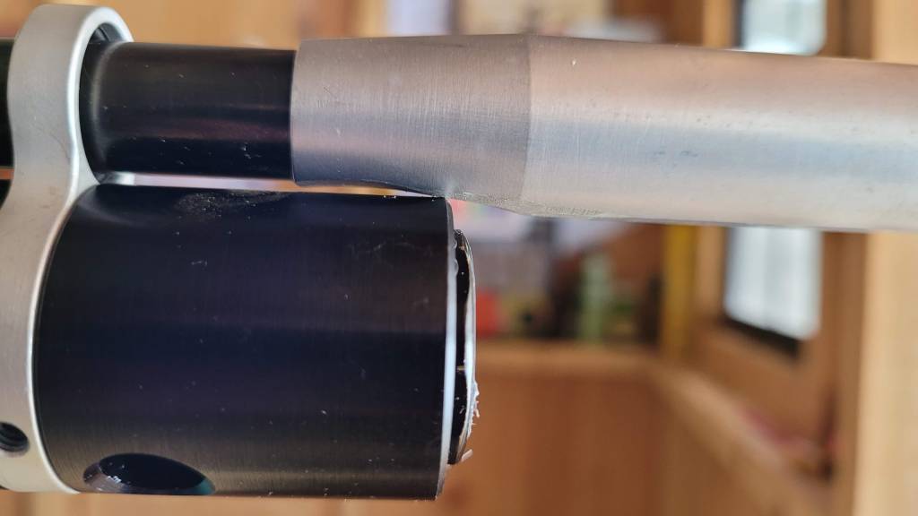

Since taking this photo I have ground down some aluminum from the bottom of the muzzle brake to give this more clearance. I am also testing to see what affect o-ring will have in the barrel band. I realize this band is a critical part with the gun's accuracy. I'm not yet sure if it will like these o-rings or not. I'll circle back on this after doing some testing!

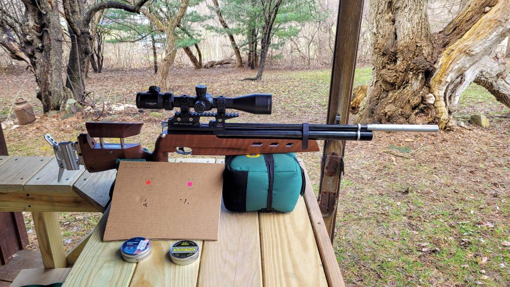

Well I ended up turning that in 14 turns before it made any change in velocity. From the 14th turn in to the 16th turn in it went from 891 fps to 842 fps. Given that I'd like to try field target with this rifle, I think I'll get it shooting at the <12 fpe level. From this point it was easy to make some small adjustments to get it in that range. Accuracy with Air Arms 8.4 and 4.52mm FTT were pretty good now! By the end of the day a storm had passed and I took my 1st 50 yard shots with the rifle.

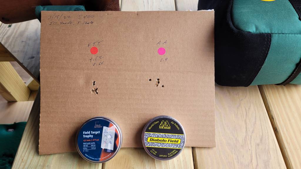

I had been zero'd at about 35 yards and I wanted to see the drop at 50. The stickers I use are 1/2 inch diameter.
The FTT were shooting at 778 fps (11.6 fpe) and the AAs were shooting at 795 fps (11.8 fpe).

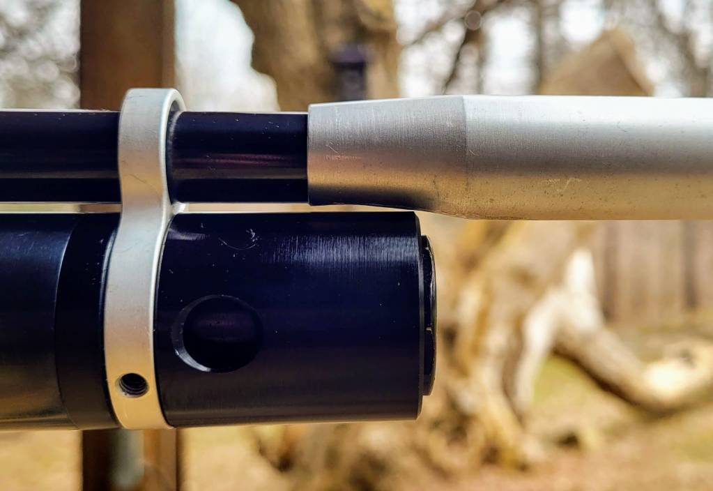

Looks like the air stripper is homemade? and looks like it could be touching your air cylinder? It also appears that someone chamfered the cylinder air gauge for clearance? Try removing it and see if groups improve or worsen.
Either way a great looking rifle!
No, what's there is more of a simple muzzle brake than anything else - I think it came standard on the early MPRs. There's not any air stripping (or air baffles) that are part of it. However, it does moderate the sound a little bit.
I did grind away some aluminium from the brake to make it (barely) clear. I don't think any grinding was done on the gauge. Before de-tuning the gun I did shoot groups with and without it. Not much difference then. I have not tried that test since taking it down to 800 fps.

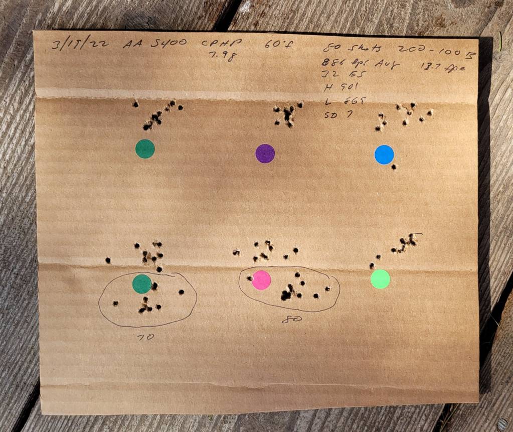

Oh, I almost forgot to post target pics from how the gun shot before tuning it down. These are 7.9 grain Crosman Hollow Points at 35 yards (@ 886 fps) when I was shooting the 80-shot string over the chrony. As you can see they're not good. The H&N and AA pellets were about the same as these CPHPs at this velocity.

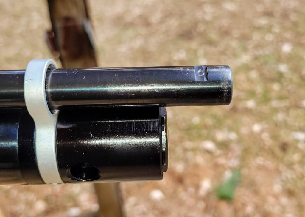

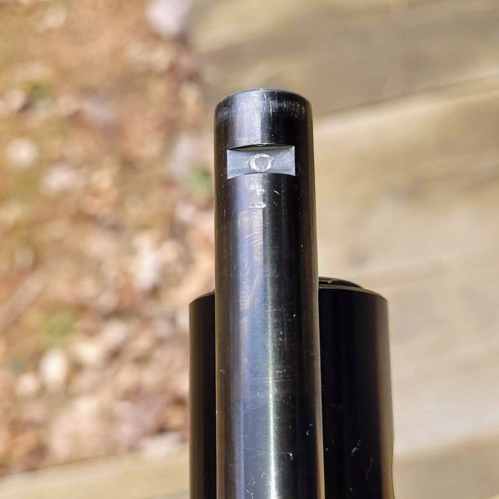

Here the pics of the barrel without the muzzle brake:
And the clearance between the brake and the tube end:
