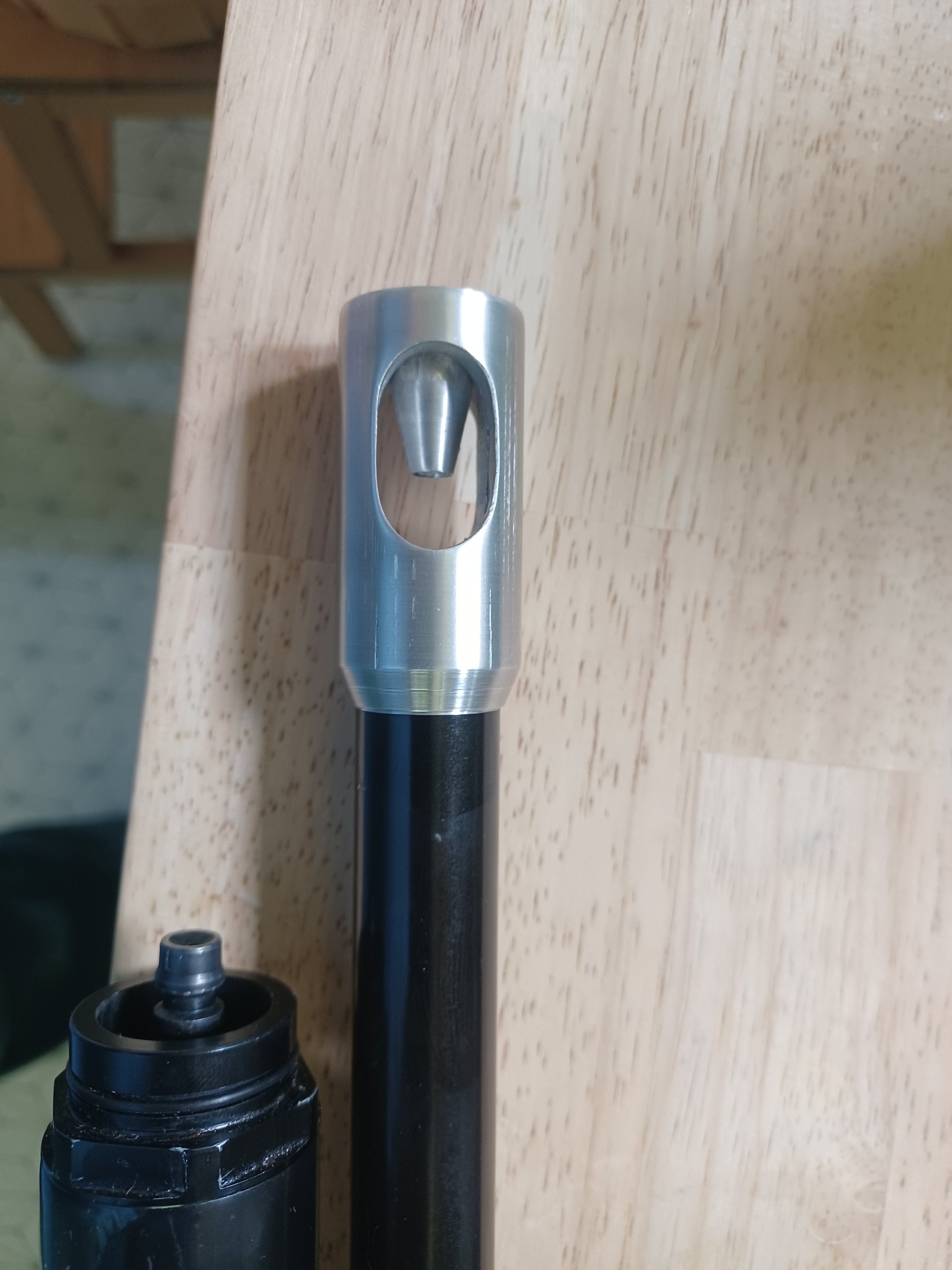

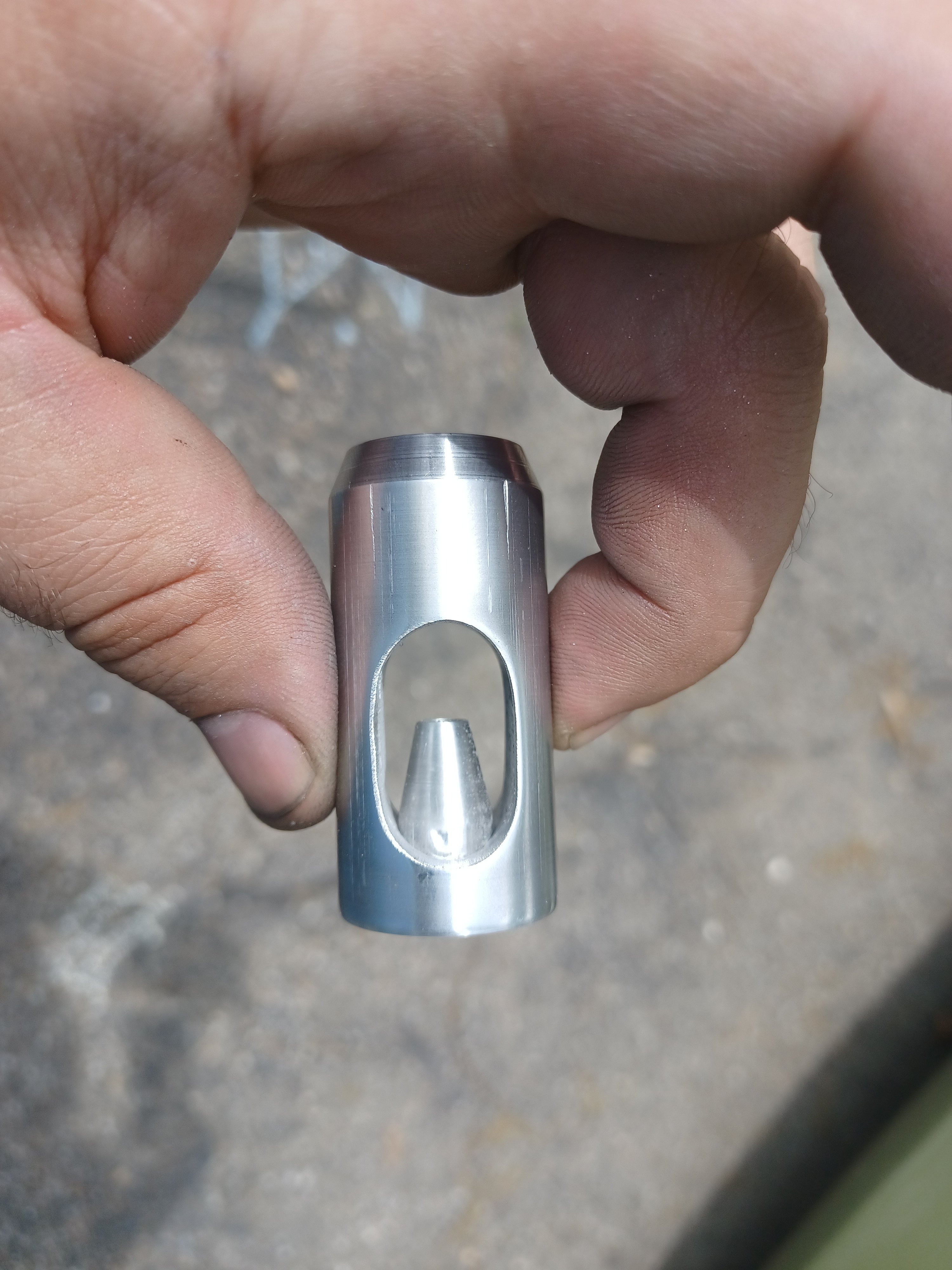

Air Strippers do you use one?
Posted this in Field Target by accident and could not figure out how to delete my thread so posting again here.
Greetings
I am working on my form and technique as that is where the maximum improvement in my scoring will come from. With that said I am not against spending some cash💰to buy accuracy that I don’t have control of. My Lupo Rosso .22 has a 0dB moderator which works great to to quiet the Lupo when I’m shooting at home but I have no idea yet if it has any affect on accuracy. Next time I go out to the range I am going to do some testing for accuracy with and without the 0dB.
Recently I have read some and watched a couple of videos on air strippers, they seemed to work in most circumstances to tighten the group. I know this is very specific to each rifle and more so each barrel. I would be interested to know shooters thoughts and experiences with air strippers and accuracy especially if you have used one on a Red Wolf. I also see that AoA has a Rowan Adjustable Air Stripper for $70.00 so I have quick access to one.
I appreciate your time for posting a reply.
The rifled bore of some barrels is not always perfectly concentric to the circumference of the barrel at the muzzle.
The stripper if manufactured correctly should be a snug fit over the end of the barrel.The cone in the stripper would then not be concentric with the bore of the barrel at the muzzle.
In which case accuracy could suffer. I have found this to be the case on more than one of my rifles and removed the stripper. Concentricity can be visually checked by shining a pentorch down the barrel from the breech and viewing down the stripper cone at the muzzle.

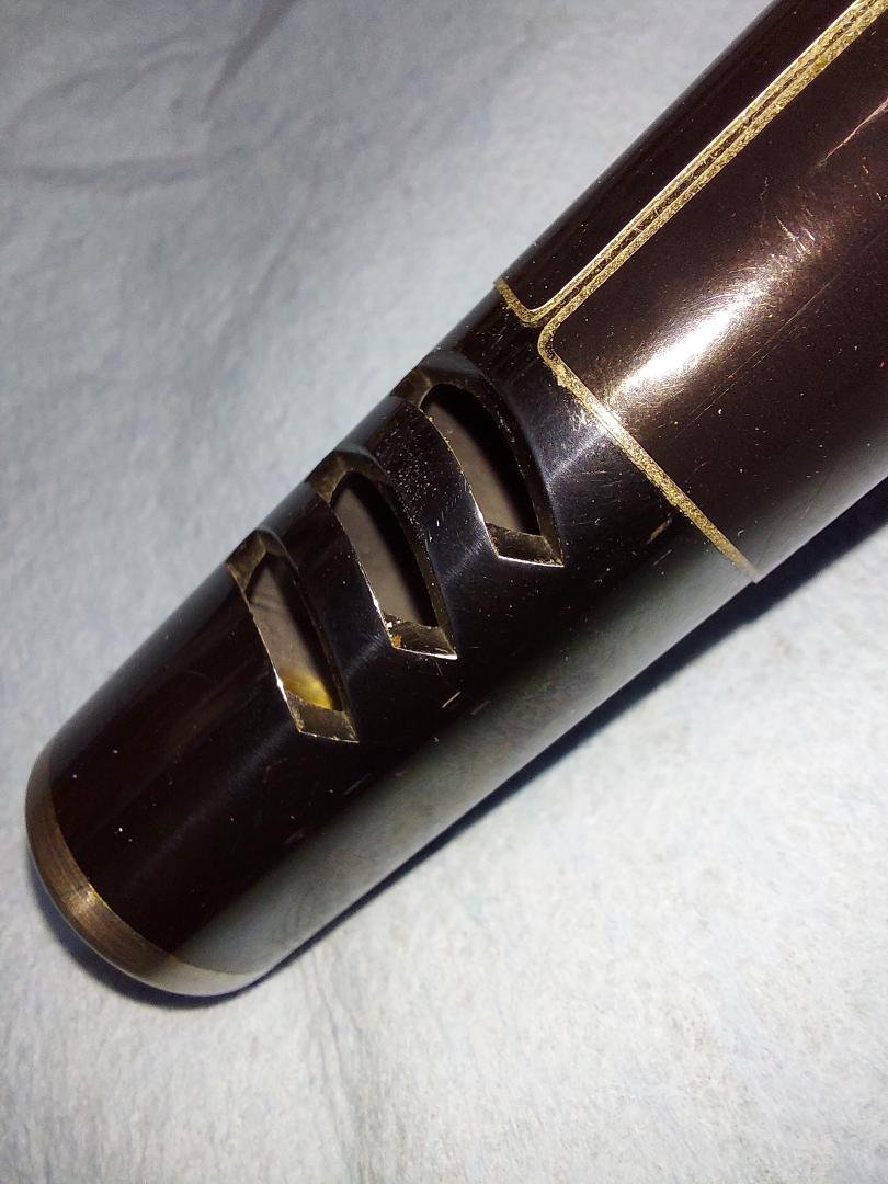

few PM's .. Whats a FLIP COMP ?
