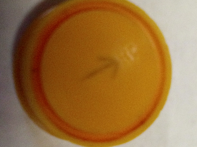

What Mycapt65 said. Seal from factory over oiled/greased HW95L.
New seal.
Factory seals are kinda sad for some reason mine just cracked looking . If your slaming you inspect the face and look for somthing like transfer port mark. Ive sern some that was so bad it looked like someone took a hole punch to it and ate a nice cut out line around the seal face..
One factory cracking and one thats new but suspect slam with port hole mark starting .
By the time this was pulled the spring was broken ... This seal was real loose but no transfer port marks just cracking and no burning .
Maybe 250 shots and kinda felt i need to check it .. yup , transfer port leaving it's mark.. funny this seal was not loose fitting so ???? Head scratcher. ( All from a r9) .
