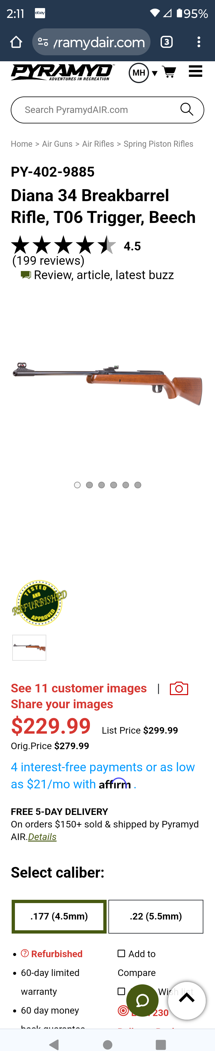

I totally agree with you..I guess I'm a little bit partial to Beeman and Diana since I had them when I was younger..were very good quality back then..also I agree with the suggestion of the notos and hand pump but again it's out of the price range..
but I thought I saw one that is close. so I had to look it up.. if it is something he wants it's on sale for today and tomorrow with a additional 20% off so it just might be in the price range..I hadn't noticed that it's a reconditioned one but it should be good.. warranty is less than new.

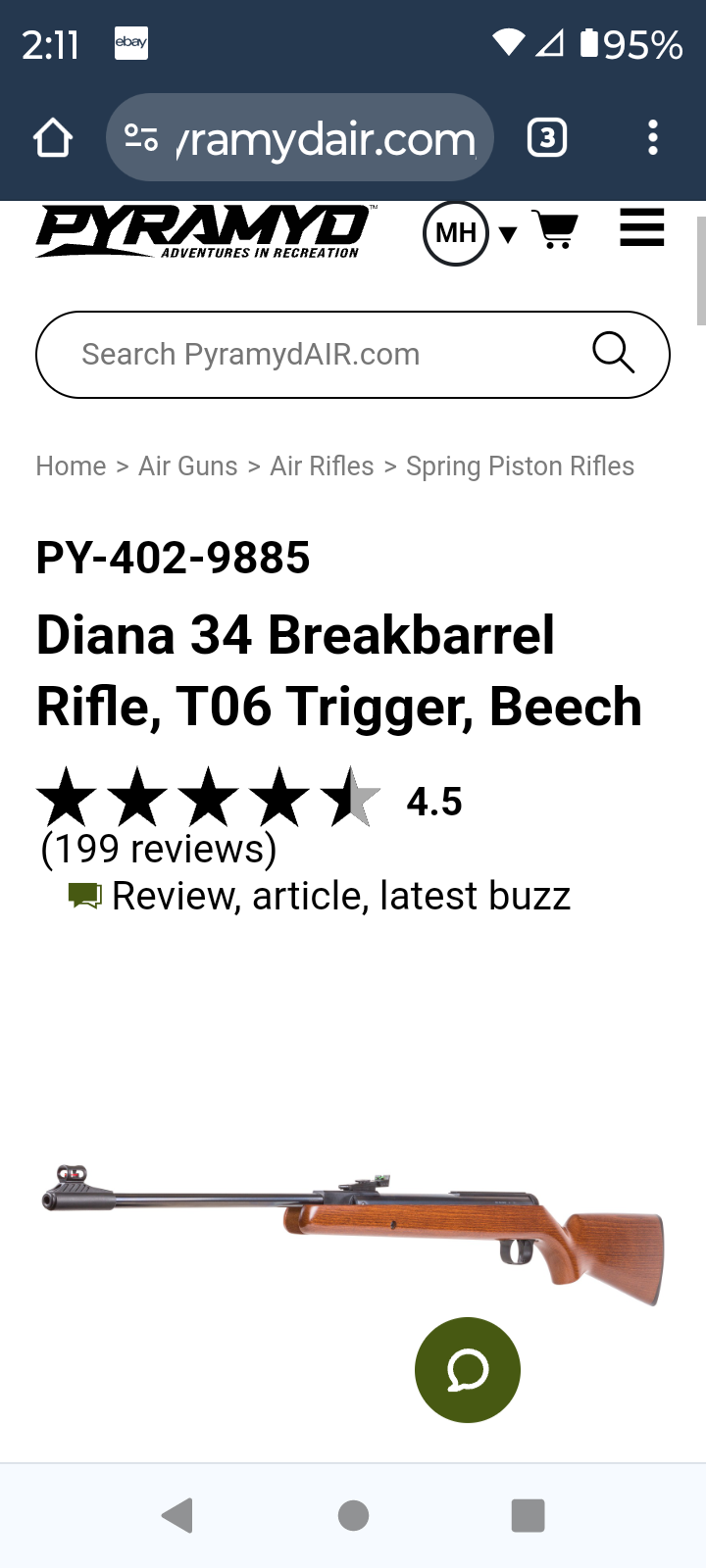

it's a Diana 34.at pyramid air.. I'm going to try to attach a picture of the page. but it's 20% less than what the picture is currently.. they only have a couple in 177 right now.
