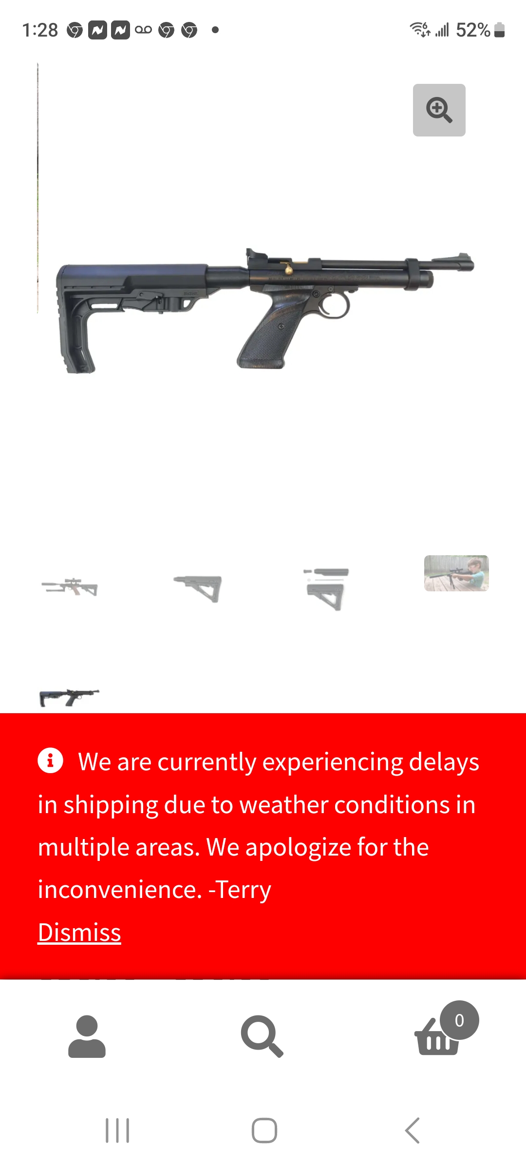

Take a look a crosman 2240 with some type of stock attached.
Reactions: maxtrouble

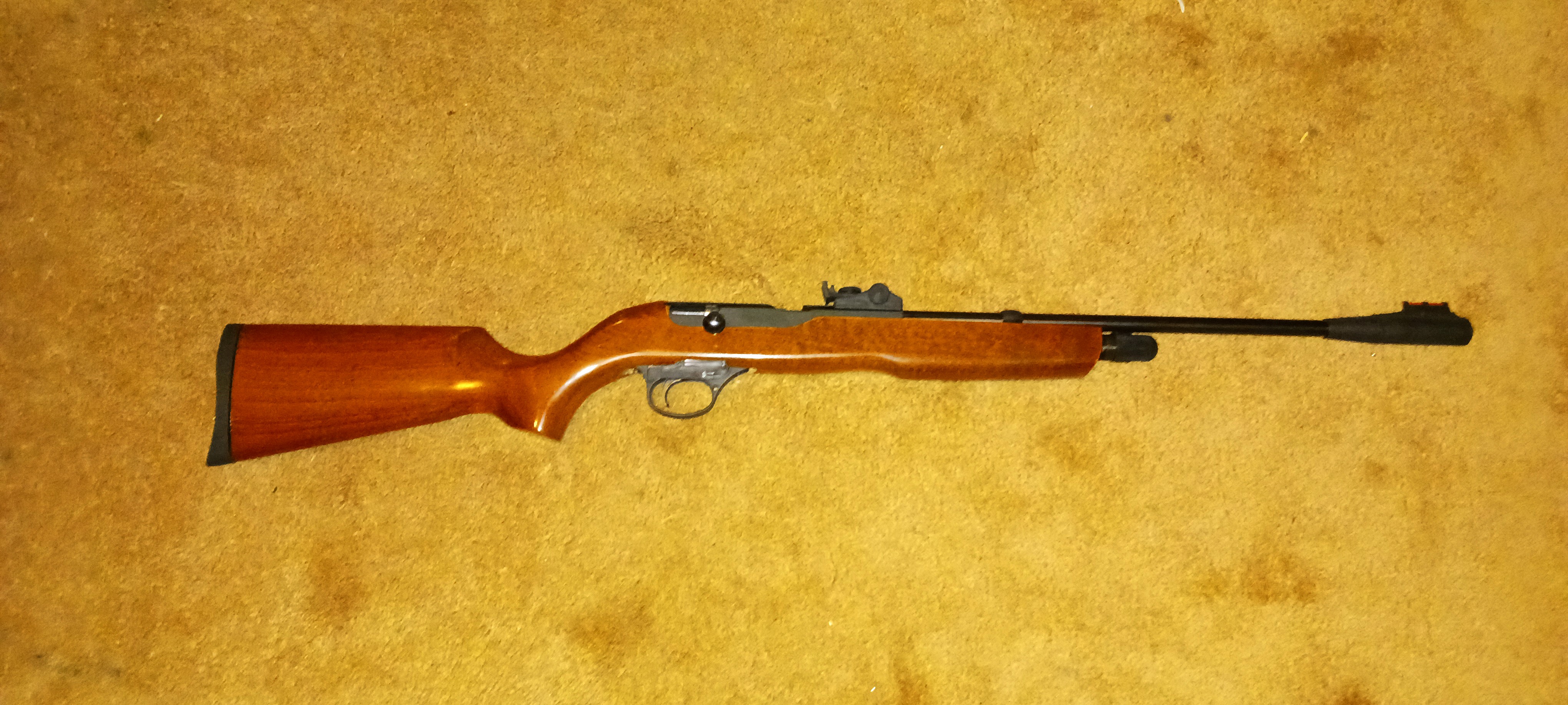

XS60C CO2 rifle
Small.
Very accurate with some power. Its a beautiful wood stocked rifle too, no cocking just load and shoot. No recoil. Get the full power tune ask Mike to do it when ordered $150 shipped. Flying Dragon Airguns. His website is being redone but you can call him. A excellent rifle for what your looking for.
This rifle with a good scope for way under $500 it will last a lifetime if taken care of.
