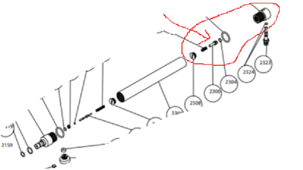

Can anyone walk me through how to take the fill port check valve out of the fill port housing? HatsanUSA informed me it was probably a faulty oring in the fill port check valve and that was it. No other information, no here's how you can check to find out, nothing. Not even sure why I contacted them in the first place. They did send me a schematic of the rifle with all the parts numbers, but no parts names. Another big thanks to them.

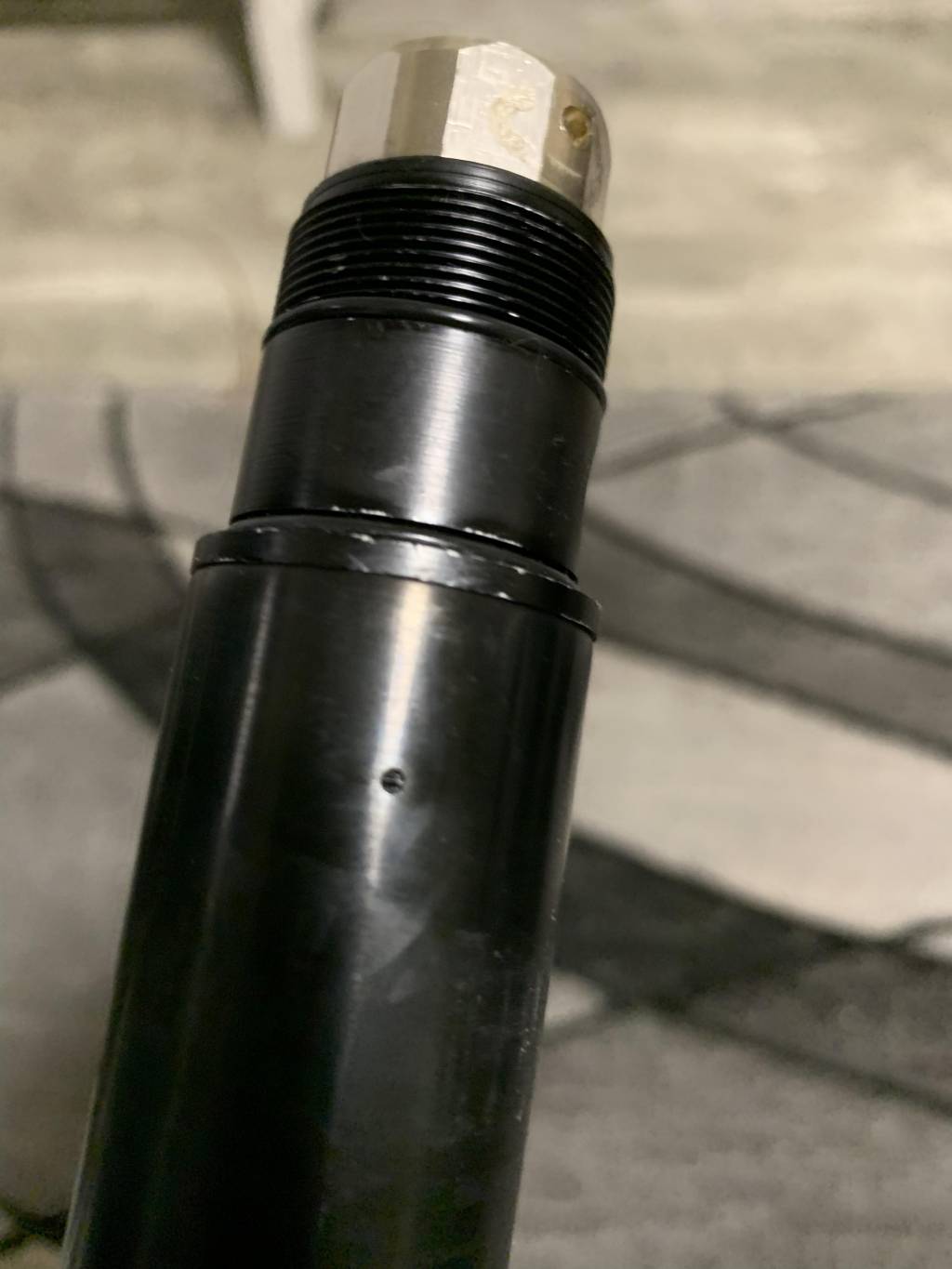

This
this tiny hole right there. Air will slowly leak from it.
Yes I am filling to no more then 175 bar actually. It’s sweet spot. It’s Mac fill pressure is 200 bar. I originally thought it was an over fill bleed valve or something but it can’t be.

the leak is most likely the O-ring in the valve, if I remember right it is a #006 O-ring, Buna Nitrile 70 or 90 will work, you must use a large screw driver or round shaft as close to the inside diameter of the probe input hole, strap the cylinder tight with a leather belt double wrapped or a pair of channel locks ( you will mar up the finish with channel locks) insert the Screw driver or shaft into the Probe hole and twist it CCW, after removal there will be a screw in the bottom of the Valve, remove the screw carefully, it will a have springs and a plunger, the O-ring is on the end of the plunger, carefully replace the O-ring, I squeeze the O-ring to make it bulge out, then use a tooth pick to pry it off the plunger, use Silicone grease or Silicone Oil liberally to lube the new O-ring, reassemble, note: you don't need to tighten the valve end too tight, just snug it tight
